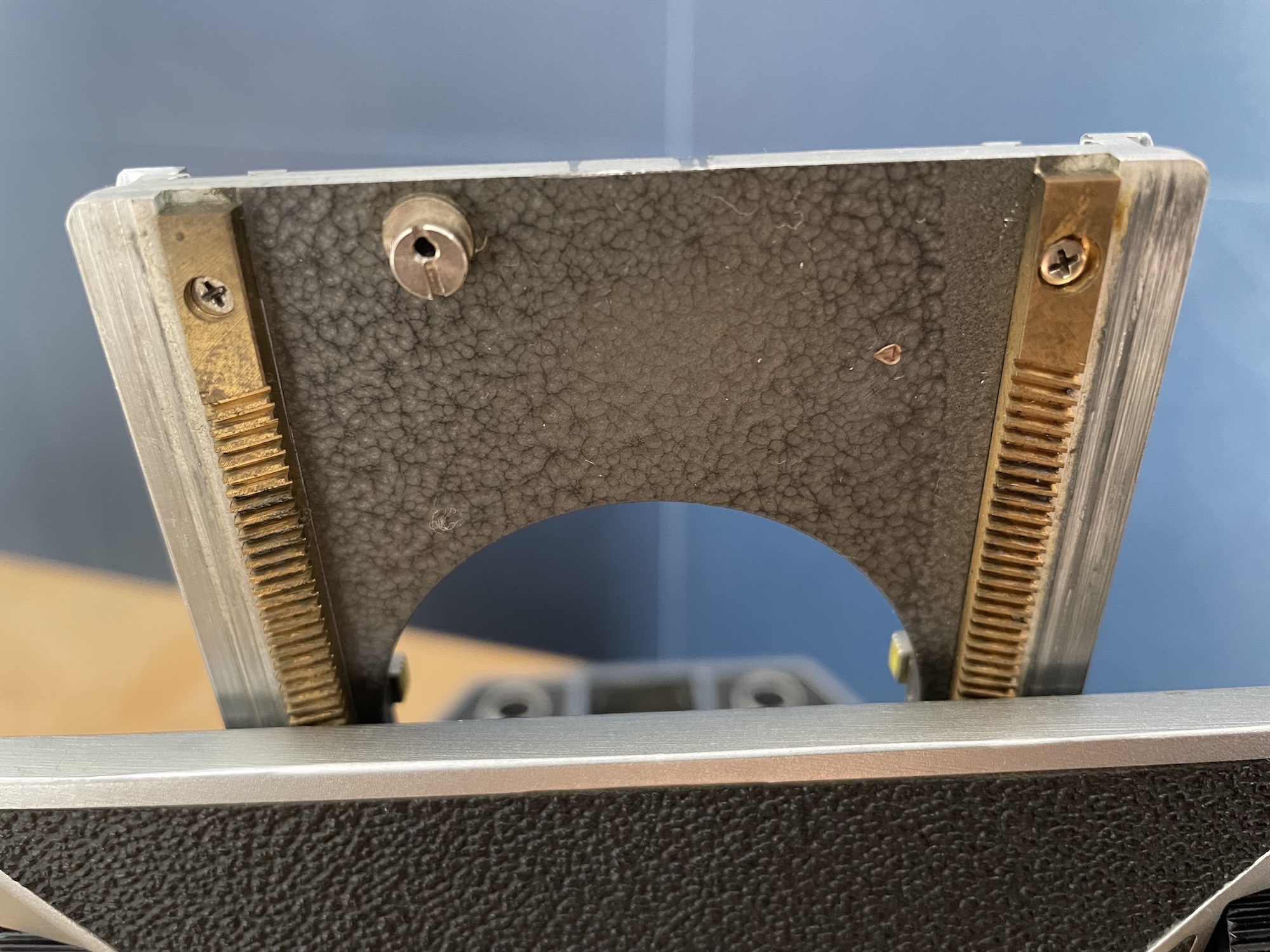

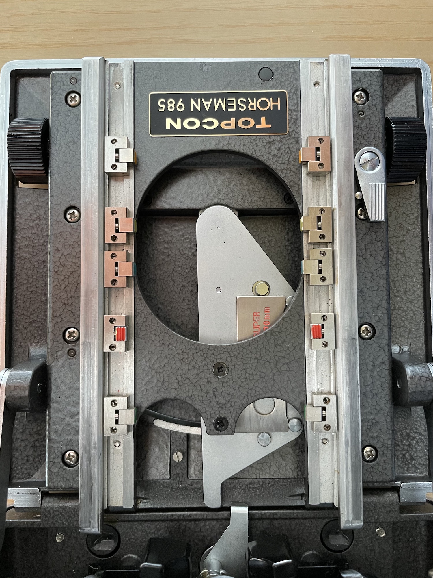

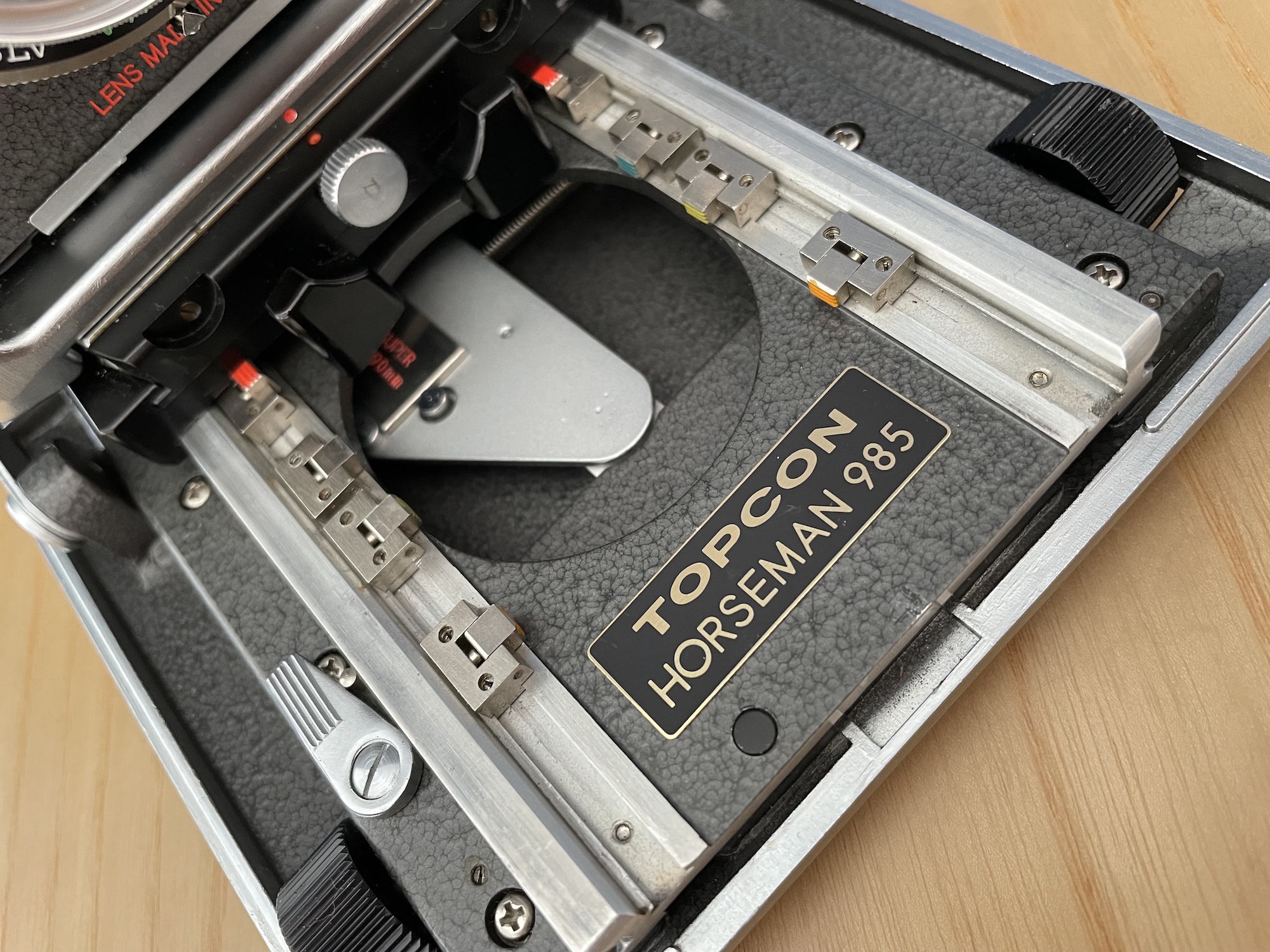

Dear All,
I recently bough a Horseman 985 in near mint condition.
The 90mm lens is in outstanding condition and everything works properly except the rail guide, which is a bit tough in forward and backward moving due the old and dirty grease still on rails.
Taking a look to the mechanism it seems easy to dismount for cleaning (seems ketp in place by just eight screws - see picture) and that encourages me to DIY.
Did anyone already do that?
What would be the proper degreaser? I thinking to the isopropyl alcohol.
And what about for the new grease?
Thank you

The bed/rails are built similar to Crown/Speed Graphics.
The outer guides hold the rain in place. You may have to remove the focus lock lever and remove both guides then lift the rails out of the bed. With the rails removed the focus pinion should be easy to remove.
Just about any degreaser will work. Do not get it on the focus knobs.
I use https://www.amazon.com/Finish-Line-...?keywords=teflon+grease&qid=1638593773&sr=8-3 but any similar medium weight grease will work.
You can save yourself some time and trouble by running the rails out as far as they will go, clean the guide edges of the rails and the grove in the guides with 90% alcohol then wipe the rail edge and guide grove with a cotton swab coated with grease then wipe the excess off so that a sheen remains. Now use a sharp pointed scribe or dowel and push out any grease/crud from the rail gears on the bottom of the rails. Once the gear tracks are clean coat with a light layer of grease. Rn the rails in and out several times. If still too stiff disassemble, clean, lube. On reassembly the rails should align with the body rails and have no side play.

This camera's rangefinder uses a cam cut for a specific lens. The cam as seen in your last picture appears to be a rectangular block that fits into the operating mechanism of the bed which has a protrusion at the body end that mates with a similar protrusion in the base of the body that operates the rangefinder mirrors or prisms. As long as the body part of the rangefinder mechanism is not disassembled the rangefinder should be fine as long as the bed mechanism is correctly reassembled.
The thin layer of grease, more of a trace than a thin layer, as originally used by the manufacturer should not be a problem for dust unless the camera is used in a very dusty area. I have never used bike dry lube but it may prove to be a good substitute for the original grease. A very small drop of machine oil on the focus pinion shaft between the focus knob and the bed at the bed edge may help also. Apply to one side and allow it to migrate down the shaft for 15 to 30 minutes before applying to the other side. The drop should be about 1/2 of a flat straight pin head.
