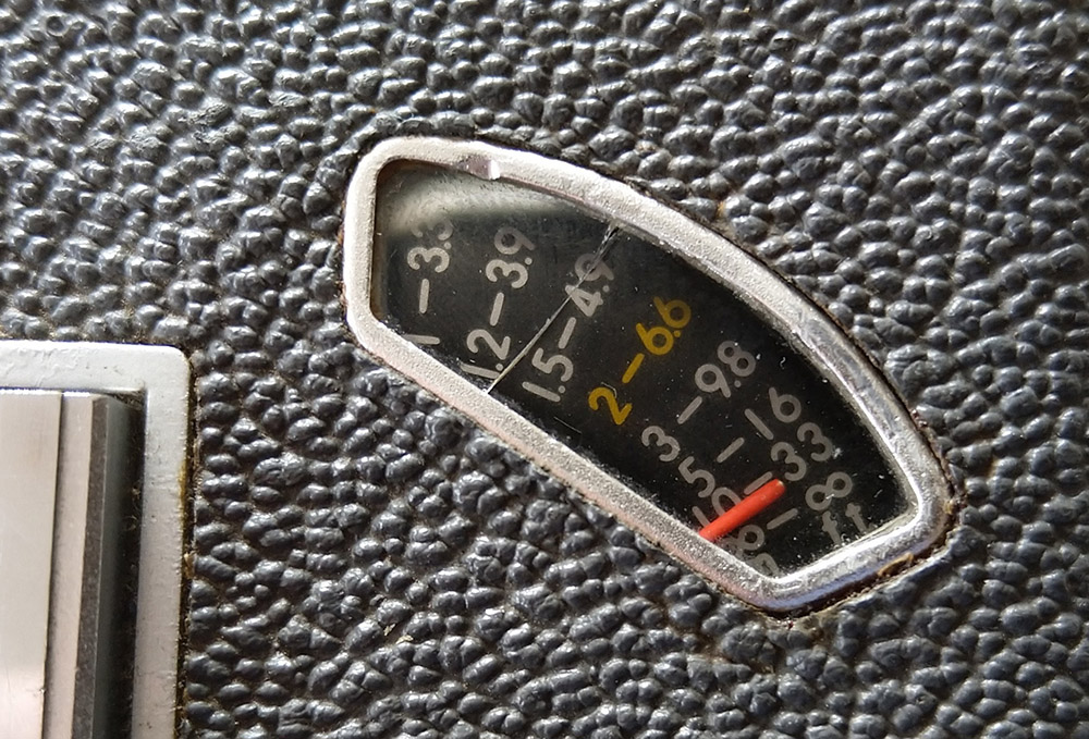

Today, I noticed that the rangefinder is not focusing fully to infinity. You can see on the photo that the distance marker is not reaching infinity. When focusing, the rangefinder split screen won't 'match up' fully when focusing on objects in the middle-to-far distance and far distance.

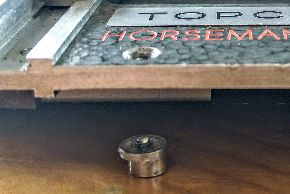

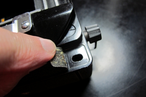

UPDATE: I've now managed to damage the camera even more, but at the same time the problem has been resolved (sort of).
I Googled a similar issue in an archived thread in a different forum. It was suggested that the focus may not be stopping at infinity, and a solution was to adjust an offset post at the end of the focusing rails.
I thought I'd found it (see photo) but when I used a screwdriver (as recommended in the thread) the screw thread sheared and the post fell off.
It seems to be a 'stop' to prevent the rails moving too far back along the bed. So, now, if I'm not careful, the lens can be taken too far back along the rails causing the spring on the cam to 'catch'. But, if I don't do that the additional fraction of a turn is there and focusing at infinity is perfect.
BTW, the rangefinder needle was always moving and it's now at infinity when the rails are in the right place.

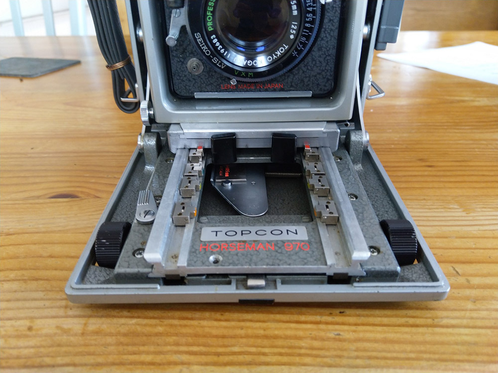

Can't tell what that part does at all. Suggestion- step back a bit and give an overview shot before showing details.
On cameras like that, many screws are nice but not essential to function.
I don't think it will be any easier to work out from this angle. It stick out below the rails, and catches on a 'stop' on the bed when the rails are moved back. Probably about 10cm is the max they would go with the bolt in place. Now, they go all the way back. But the cam sticks and the spring has to be released when the rails go too far back.

Put it in a bag, label it, put it in your camera bits drawer, see how to accommodate the missing part, and go shoot? Save it for a snowy winter evening.
shutterfinger
Feb 25, 2013
5,020
San Jose, Ca.
I would remove the shaft of the screw from the bed, find the diameter and thread pitch of the screw then make a new one. The threaded section of the eccentric screw head looks like its small enough to be driled out, threaded, and a new shank installed.
The screw is likely metric.
John Koehrer
Apr 3, 2004
8,276
Aurora, Il
Yup. It looks like there may be enough to measure the thread with a digital caliper. The nice
thing is in that size there aren't much choice in TPI and pitch. Using a metric scale you may find
it close enough to eyeball with a decent scale .

Thanks @shutterfinger and @John Koehrer. The screw was holding a bolt or post of some sort, it can be seen in the photo above. It has sheared off completely and the rails can now move a millimeter or so back. This has allowed the camera to focus perfectly at infinity. I think I might leave it off. So long as I remember not to bring the rails back too far, it's actually working at it should now.

Hmmmm, maybe this has been gone over, but is that part an infinity stop? Looks to be an eccentric cam. By rotating the cam, you get a variable stop point, that you rotate until you get a true infinity stop?
Stephen Power
Stephen Power
Sep 4, 2020
116
County Kerry, Ireland
My thought was that the post that fell off was keeping the rails from going back too far. If I focus so that they move about 1.5cm back in from the edge, there's a 'click' and the cam seems to jam.
I have the cam sitting with the straight end flush on the bed, on the LH side. Is there another way to fit it?

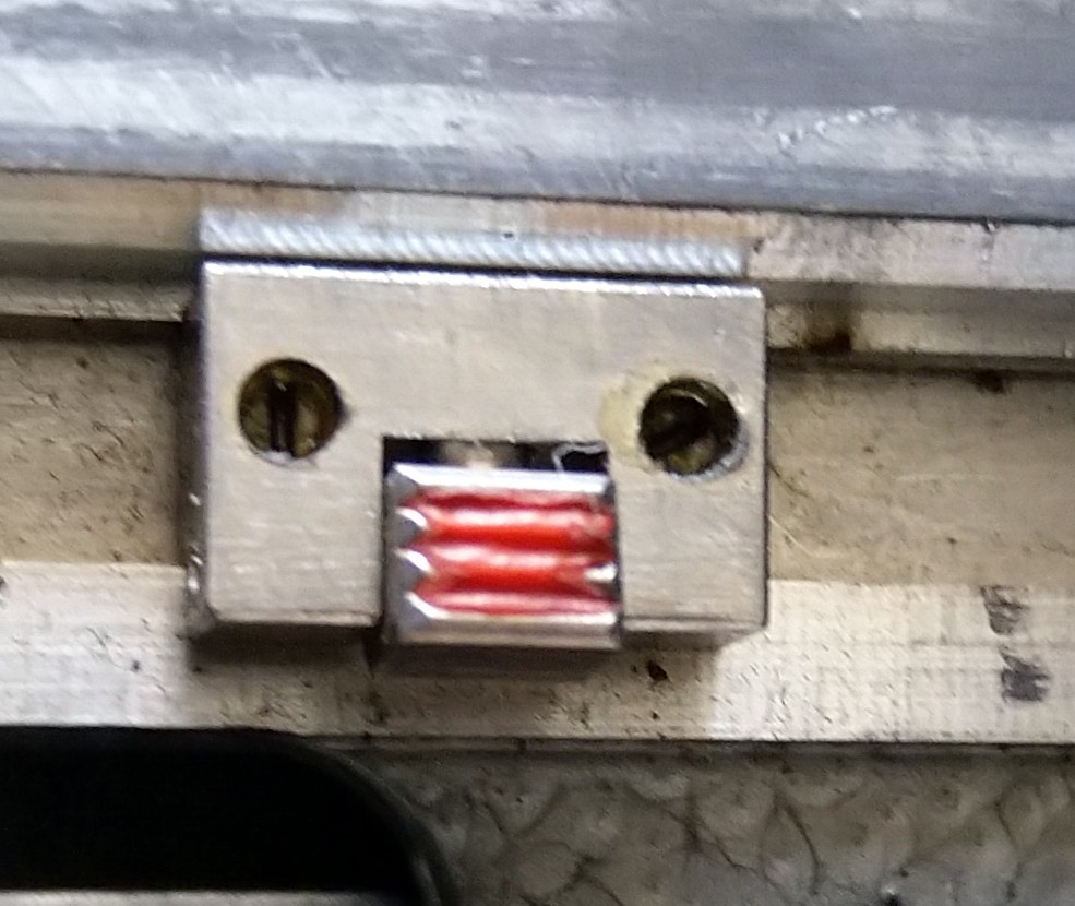

Aren’t the flip-up infinity stops on the bed rails adjustable like they are on speed graphics? That’s one of the first things I would have verified/adjusted. If I’m not mistaken
the part that was sheared off is simple a limit stop... not intended to adjust infinity.
If the rangefinder is couple with a tube of balls and a spring strip connected to the sliding rails, it will likely continue to bind because it may be both too tight and in need if cleaning/lubrication. BEWARE: taking that apart is fraught with danger... the small parts get lost easily and all are needed!
They seem to be, yes, now that you mention it. If only you'd been sat next to me imparting your hard-won knowledge.
If I’m not mistaken the part that was sheared off is simple a limit stop... not intended to adjust infinity.
Yep, I finally managed to work that out, after I broke it.

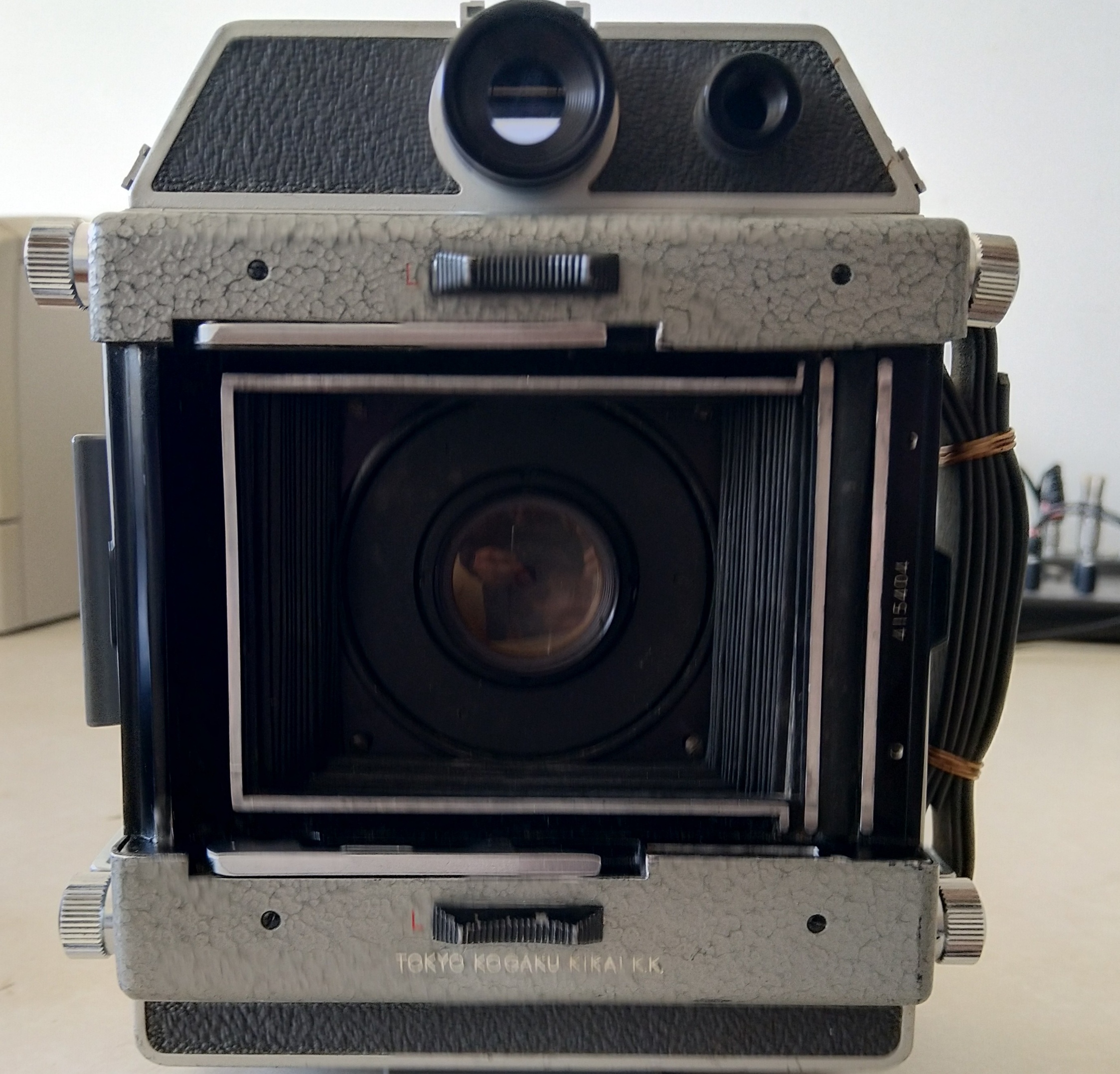

In that case the infinity adjustment for the rangefinder is likely under the cover on the back of the camera (like the case of the VH-R shown here).
Would you consider taking a wider shot so I can put it in context please? I can't work out where the adjustment is located. I don't think mine has it.

Check the lower right after removing the graflok back.
