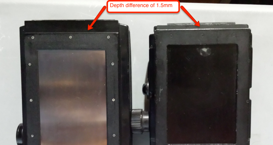

I picked up a Horseman 8 exp 6x9 roll film holder for my 2x3 Crown Graphic. Unfortunately, it wasn't until after I made the purchase that I did the research to find that it isn't a perfect fit. I've seen this referenced on a few other pages but nothing that is giving me explicit information about where the mod need to be done for sure. This link includes a post (fifth post down, by Sebastian) that describes the issue as being because of the ridge along the left side of the Graflok back on the camera being too high. Can anyone confirm this? It seems that some others believed that the issue was with the grooves where the sliding locks fit. Apparently, if the ridge is actually the problem, then filing down the grooves will make the back appear to fit but the film plane will not be level.
I'm wondering if anyone here has had personal experience modifying a Horseman back to fit a 2x3 Crown Graphic's graflok back? Lets please keep this on topic. I know that I can buy other backs. That's not the point. I'm interested in learning where the mismatch is between the camera and the Horseman back and what modification solves this. Thanks!

Quick follow up. Just did a rough measurement here. There is indeed a difference in the depth (1.5mm) of the recess at the back of the holders. It seems that the theory about the ridge at the left side of the 2x3 Crown's graflok back may be accurate. It looks like the solution is to either grind down the ridge on the camera or grind down the recess on the holder. Can anyone confirm? See pictures below.

Theres actually no concern for critical measurement here. The recess on the film holder is simply too shallow to accommodate the ridge on the Graflok back. To visualize this, stack two books on a table and the lay another book with one end atop the stacked books and the other end on the table. You get one end elevated preventing a flush mating of the face of the book and the table. Thats all thats happening here. Once that is corrected, it is the whole face of the film back that registers the film plane (which does match all other "graflok" back style roll film holders). This is simply an instance where the shallowness of the recess causes the left side of the film holder to be higher and not flush against the graflok back. Once the ridge is filed down, the holder will lay flush (if the theory is correct). The film plane would automatically register correctly once the mating is corrected.

Understood as well. Upon confirmation, the Horseman backs are made to the same international Graflok back film plane registry standards of all graflok style backs. Interestingly, the "standard" isn't much of a standard and different backs from different manufactures, designed to be used interchangeably, actually turn out to have some variance in film plane registry. The variance is as much as 0.25mm from manufacturer to manufacturer. In most cases outside of extreme macro/micro work with extraordinarily thin DOF requiring absolute critical focus, a variance of 0.25mm is negligible and more than compensated for after stopping the lens down one or more stops. Also as a note, from the reports that I've seen, the variance in film flatness in the Graflex roll film holders is likely far more than the 0.25mm variance in the backs. In the end, I'm confident that the film plane will be fine for what I'm doing. Since we're on this, might as well post these measurements pulled from a since gone Medium Format forum and reposted on the LF forum for future reference in case anyone needs them (credit to Oren Grad for the numbers):
Model Type / Formats / Depth
Cambo slide-in / 6x4.5 / 4.95mm
Cambo slide-in / 6x7, 6x9 / 4.95mm
Cambo slide-in / 6x12 / 4.95mm
Horseman clip-on / 6x7,6x9 / 4.95mm
Horseman clip-on / 6x12 / 4.95mm
Linhof S-Rollex clip-on / 6x7,6x9 / 4.85mm
Linhof Rapid Rollex slide-in / 6x7 / 4.85mm
Linhof Techno-Rollex clip-on / 6x12 / 4.85mm
Sinar Zoom slide-in / 6x4.5 to 6x12 / 4.85mm
Sinar standard slide-in / 6x7, 6x9 / 4.85mm
Toyo clip-on / 6x7,6x9 / 5.05mm
Wista clip-on / 6x7, 6x9 / 5.10mm
Wista Type DX / slide-in 6x7, 6x9 / 5.10mm
Now back to the regularly scheduled program. I'll likely just grind down the film back (not touching the camera) this weekend to see if the mod is as simple a fix as I suspect. Fingers crossed.

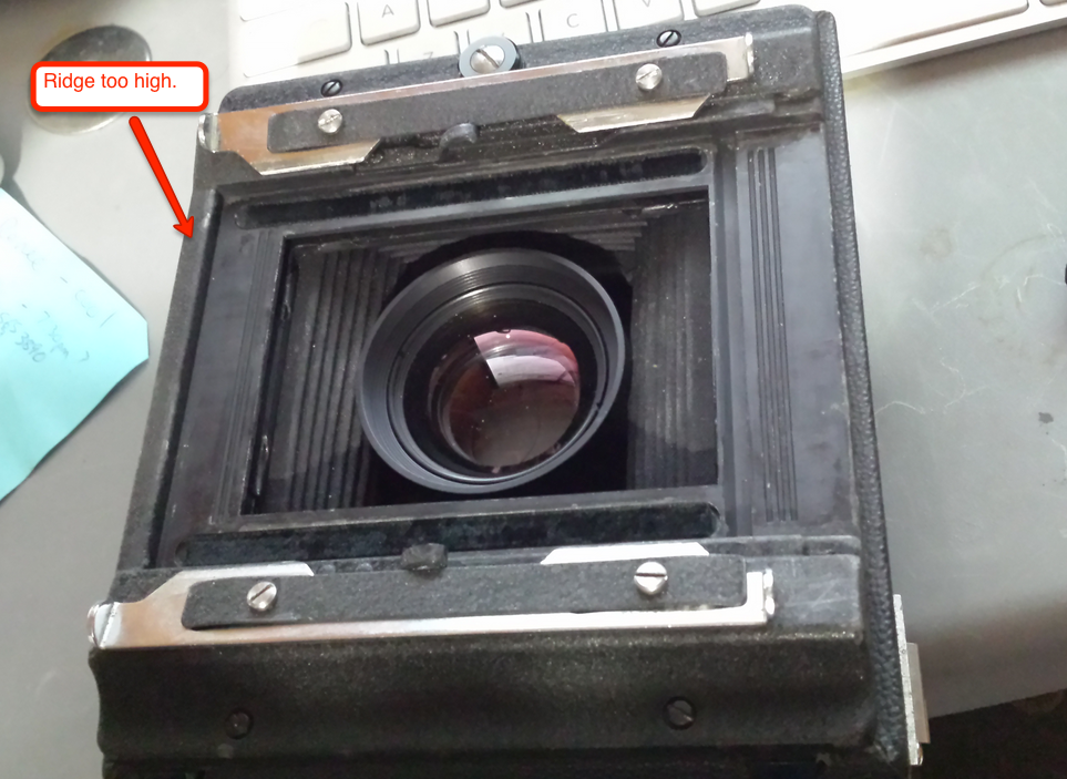

I can offer my experience from designing/building a metal camera to take the RH/10 which is standard on the 2 x 3 Crown. (see my apug thread)
The top and bottom , and the left side you are referring to, were designed as light traps. The right side light trap is on the Graflex RH/10 rollfilm holder as a little ridge. If you try to grind the camera's left light trap off, not only will the camera be butchered, but, in my experience, unless you machine it flat to about 0.002 thou inch ( 0.050 mm) or less, and then add another light trap further out,, it will leak light.
Also you might have to modify the clamps to press the Horseman tighter than the original design.

wombat2go, thanks for chiming in with input from your experiences. Like I said, I'm going to modify the holder.
Regarding the lens and film flatness bits, this is my point. I don't care about slight variances here and there whether it be film flatness or the particular lens and how it projects across the plane of the film. All I care about is that it makes the pictures that I want. Nothing else matters. The question is simply will a slight modification to the roll film back provide a usable solution? I think the answer is yes and now I've got a nice little experiment to see if I'm right :smile:
Ideas from anyone else? There must be someone here who's actually done this, no?

To clarify, I know that I bought the holder because it is supposed to be superior to it's Graflex counterparts, but at this point this whole thing is just for the sake of experimentation. If it works that'll be great and if it doesn't thats totally cool too seeing as it'll be easy to pick up another holder that fits without modification and carry on without much concern :smile:

Well, I bought my Miniature Crown to use and DID carefully grind down the ridge on my Crown. It is hard to tell that the modification was done and now I can use my Horseman holder on it. Now I use Grafmatics, the RH12 Graflex back and the Horseman 6X9 backs. In fact I may try to put a Mamiya 4.5X6 back on it.
By the way, the same requirement applies if you wish to use a Horseman back on a Mamiya Press or Universal with the G back.

I too would modify the holder, not the camera, provided the holder has sufficient material and will not be weakened by the reduction in thickness. I do not currently have a 2x3 Crown to check how much could safely be removed from the back.

Bob, thanks for chiming in with your experience. Interesting to hear that you've had success with this. My plan is to grind down the holder sometime this weekend. Should be a fairly quick job to take off 1.5mm.

Just wanted to pop back for a quick update. Very long week but I finally got a chance this evening to try out the modification. It ended up being a little more work than I'd planned for but only because I took off a little too much material from the holder and so I had to patch a hole with a little high strength epoxy. It's done now and it fits the camera like a glove. I tried to take off about 1.5mm of material but ended up taking off probably a little more than 2mm because I'm exhausted and wasn't really paying attention to where I drew the line. I repaired my error which was an easy job thanks to my favorite kneadable epoxy. When all the cutting was done I found that the holder fit but the two sliding locks were still getting stuck just a bit so I took them off and sanded their edges a little thinner (sharper) and that solved that. So, now the holder is a little uglier but a lot more useful. Thanks all for chiming in with your thoughts and input. Now I'm gonna go make some pictures :smile:

I'd like to share my part of the same experience. I found that my Hosreman 6x9 back has 3.69mm ridge height and the Century Graphic 23 got 3.93mm. Since only 0.24mm is hard to control by hand filing, I then file it down to 1.5mm and afterward put thin foam tap between the gap. Now it looks OK and I'll try to see if there's light leak to it. ;-)
