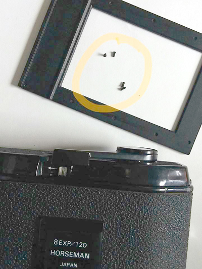

What size thread are the screws that hold the front (back?) Camera side plate on a Horseman 6x9 film back. I'm building a 6x9, 65mm fixed focus camera and I'd like to use longer screws to attach the back to the wooden box I am building as the camera body.
Thanks for any help you can provide.
Jul 13, 2006
266
Europe
These are metric screws with a thread pitch of 0,4 mm. Size of the screws is - as far as I can evaluate from the image - 2 mm diameter and 10 mm length.
