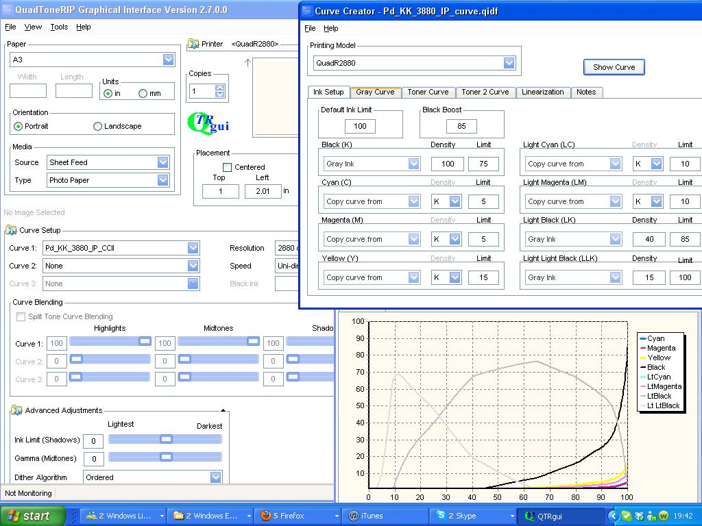

I have printed a portion of the negative though Photoshop without applying the curves layed down in QTR. The test is fine, no banding to be seen. I then printed the same portion in QTR with correction curves applied and bang, I see banding again! It therefore leads me to believe that something is going on in QTR that is causing this problem. I've attached a screenshot of my setup. Could anyone give me their ideas on this matter? Would be most appreciated.

What software are you using when you print your negative? Are you printing directly from photoshop or some other photo editing program? Or are you using a desktop publishing program such as inDesign? I had that problem using inDesign. I was able to solve it by correctly placing the photoshop file into the inDesign document.

Herzeleid, thanks for the document. Hopefully something in there will help. The banding I'm getting isn't as described there. It's very close together and apparent in all areas of the print, not just in the highlights half an inch a part. Joe, I'm printing through a 3rd party Driver called QTR which tells to the printer how much ink to lay down. Cheers

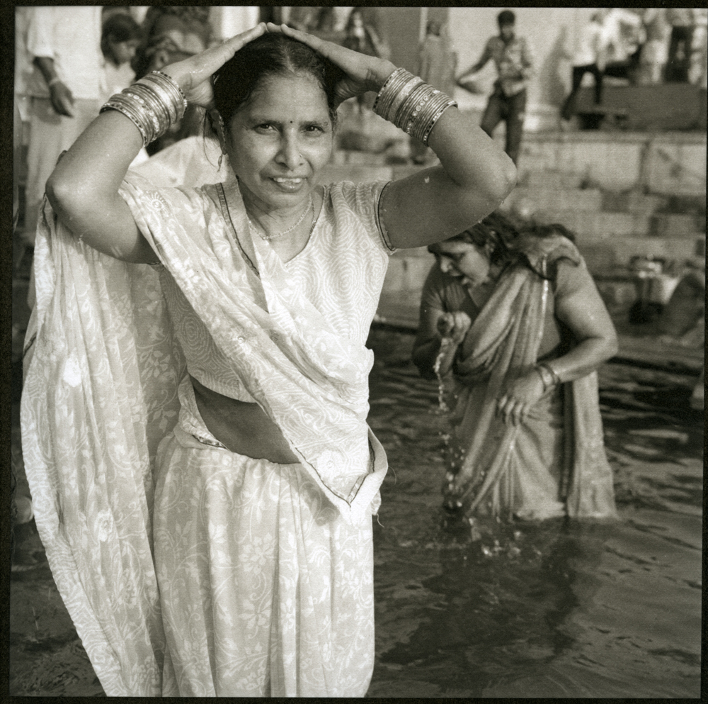

Its very subtle, but its there I assure you!
Herzeleid
Oct 31, 2008
386
Ankara/Turkey
I see some lines but I can't be sure if that is banding or the paper texture,if you can scan some details, it might be helpful for someone with the knowledge of your printer.
