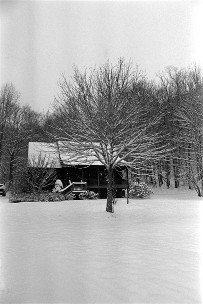

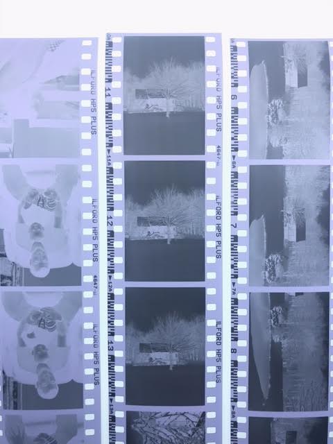

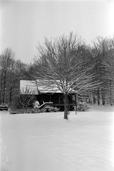

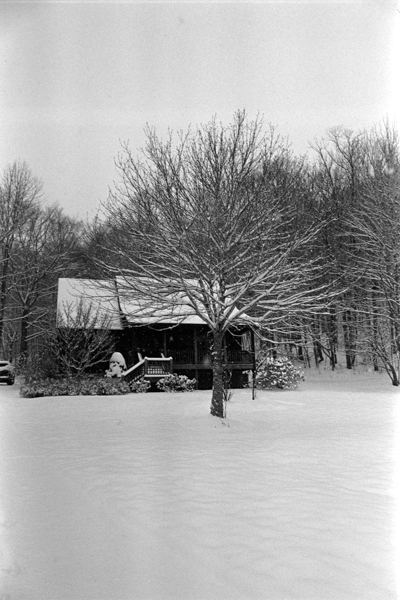

What could be causing this horizontal banding issue? The bands are inconsistent and run horizontally across the roll of 35mm film. They do not appear in the border. I develop at home and follow a pretty standard agitation schedule. (10 seconds every minute, using the stick to agitate about 1/2 turn in each direction for both dev and fix) the film is newly purchased Ilford HP5+ developed using times from MassDev. The lines are visible on the negatives, and these three photos are in sequence, frames 11, 12, 13 respectively. I use the tap water out of the faucet and temperature can sometimes vary slightly in the wash. I have sometimes had the same lines on 120 film. they are always most visible in sky and snow. I'm not so bummed that they exist but not knowing why IS DRIVING ME CRAZY!!! They do not appear to be on the rest of the roll but it is not easy to tell because they are very subtle. Any Ideas?
Can we see the negatives? What developer and dilution and time, I ask because it appears to be a developer issue.
Bromide drag, caused by your agitation method: turning the spool with the stick is a bad method. Throw that stick away; instead, agitate by flipping the entire tank upside down one or twice every agitation.
Developer is HC-110 (1+31) for 5 min. sorry for the cell phone negative picture. I believe the others are right about the stick causing bromide drag on further research.

Apart from the streaks, the negs are developed more on one side compared to the other, which also suggests inadequate (and largely horizontal) agitation. Switching to inversion should sort this out as well as the streaking.
