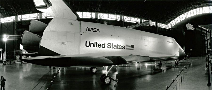

This was taken with the "cheap" Horizon:
As was this:
