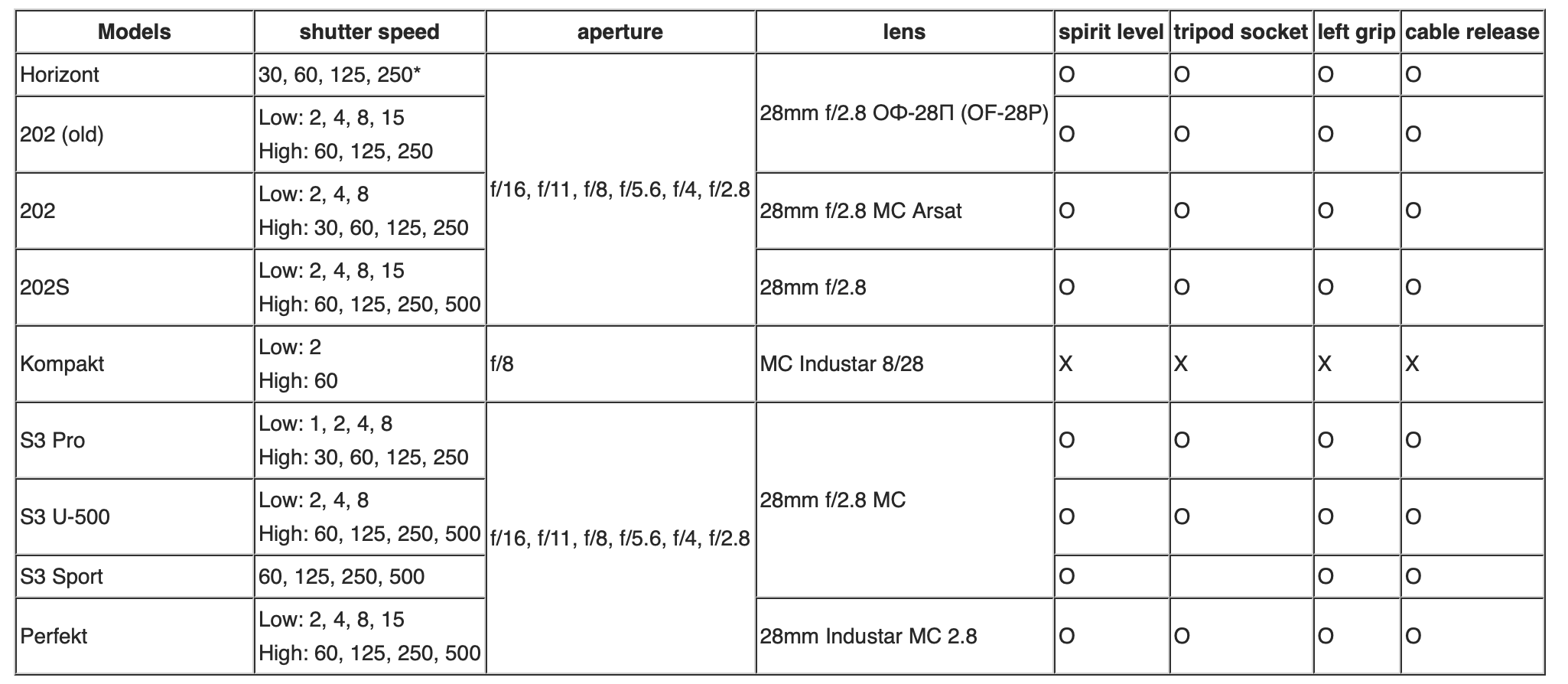

Thanks for all the replies. Actually I don't see any German seller at the moment and I could get one from russia brand new but it would cost me additional 35 euros for shipping. LINK TO CAMERA EBAY. There are also different models !!! Only the Horizon Perfect, Horizon Sport and the Horizon S3 U-500 have 500th of a sec shutter speeds which would come handy if using it handheld. I will most likely buy it next month but wanted some feedback from people who used it already.

[QUOTE="unwantedfocus, post: 2438171, member: 95152" Only the Horizon Perfect, Horizon Sport and the Horizon S3 U-500 have 500th of a sec shutter speeds which would come handy if using it handheld.[/QUOTE]
You did not understood my remark above.
With slit exposing cameras not only the momentarily exposure is of importance, but the whole exposure run. With common focal plane shutters and their typically short run we seem not to bother unless we have it about the synch speed or about very fast moving objects.
With rotary cameras (be it fully rorating or with a swing lens) the run is longer in time. However the examples above show that it is possible to handheld render for instance a straight line straight.
