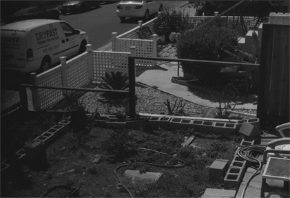

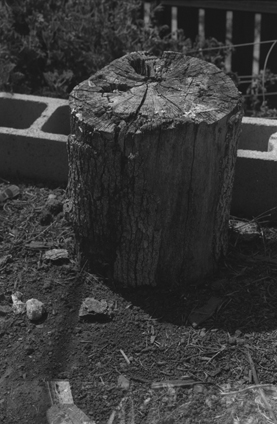

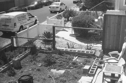

All images were exposed on Agfa APX 100 and processed in HC110 for 5 1/2 minutes at 68°F, continuous agitation for the first 30 seconds then 5 seconds every 30 seconds thereafter. Timing started at the end of pour in and ended at the beginning of pour out. All negatives scanned on an Epson V700, 16 bit gray scale, 2400 dpi, no color correction, batch mode. Many frames had some of the blank space between frames included in the crop marquee which may have caused some scan exposure error. All scans selected for this post cropped to actual image area, resized in steps of 1200>600>300 dpi then to 8 bit gray scale and saved as jpeg from the original tiff file. No exposure adjustments applied.
SP1000 with a Scratched rear element 50mm f1.4 on the left, A Spotmatic with a 55mm f2 on the right.
Metered exposures:
attachment.php
attachment.php
attachment.php
attachment.php
Sunny 16 based exposures:
attachment.php
attachment.php
attachment.php
attachment.php
Note the flare in the f1.4 lens in photos 1 and 4. Both cameras and 3 lens will be available when the new light seals arrive and are installed and will have a new spare Duracell 392 battery. A roll of APX 400 will be run through each with more careful metering before being offered.
