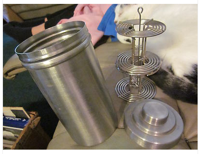

Looking to pick up a Honeywell Nikor Film Developing Tank but don't know about it. Does this need to be used in a darkroom? My Jobo can be used in a lit room and that's what I'm used to. It looks like it needs a darkroom but I can't tell for sure. Screen Shot 2012-10-23 at 4.38.19 PM.png

You load the reels and assemble the tank in the dark, then you can pour chemicals in and out through the small opening at the top with the lights on. If you do not have a darkroom, buy a changing bag. That is a black lightproof bag with elastic armholes. You stick your arms in and load the film with the lights on.

Those reels are for 120 films. Your profile says you are 35mm shooter. Are you are of the differences? (ie. the spools in picture cannot be used with your 35mm film)
I should update my profile. I do really enjoy playing with my Bronica etrsi as well. and my Yashica 124g
