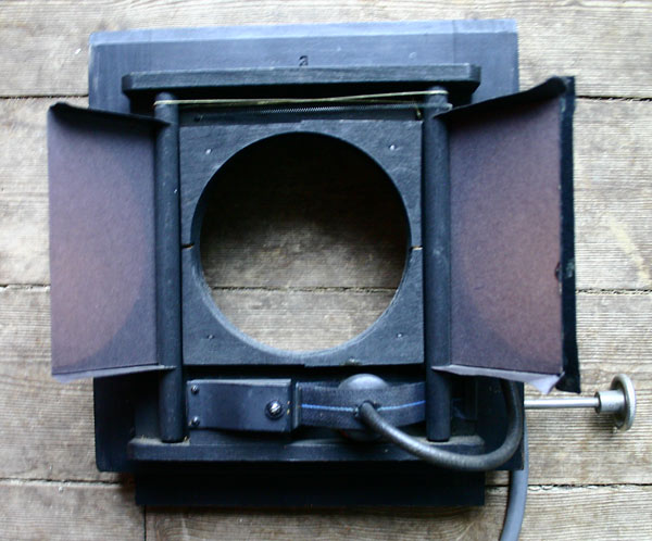

I have a really nice "norka" barn door shutter in my possession.

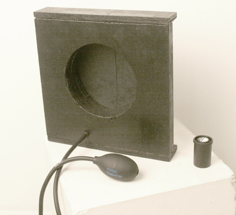

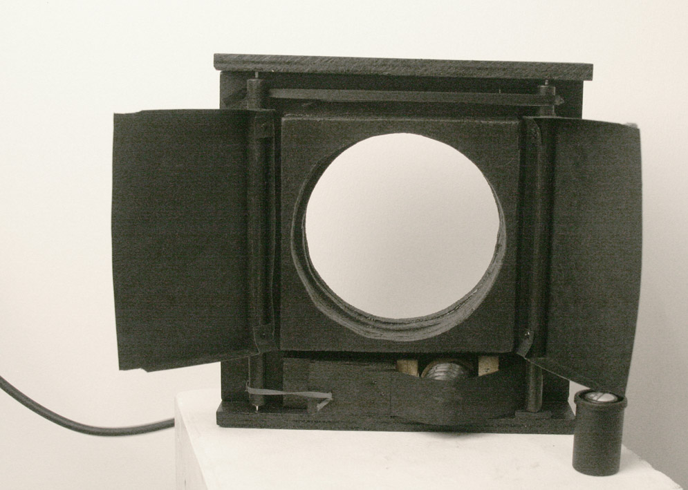

A student of mine has decided to build him self a big camera, so he "just" copied the shutter, but made it MUCH bigger..
I am quite impressed! it works fine. The fun part was to hear where he got the bits and pieces for it.. (his father is a doctor, so some stuff comes from a doctors office - some come from the inside of an old broken DVD player... and so on.
I'll show you a couple of images here. First the original Norka - then Christian's.
(maybe there could be a market for this? I hear all the time, that people wants a BIG shutter for their BIG lenses, and this will accept very big ones.!)
Anyway, I was surprised how "easily" he made this lens.
But it needs a large lens board.
(I'll check the exact mesurements tomorrow and provide them..

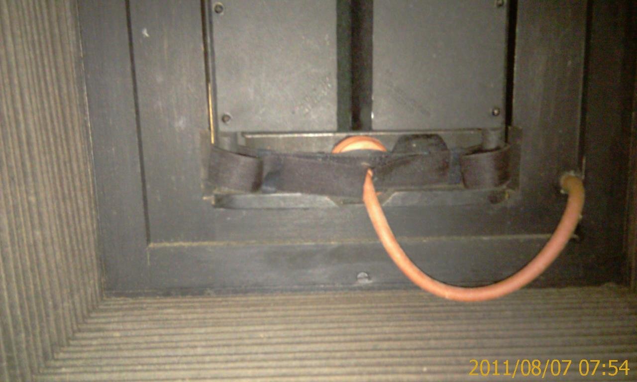

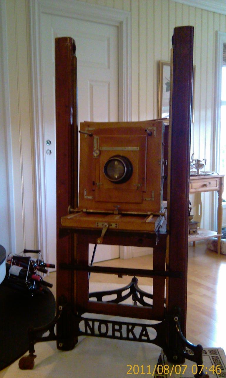

Hello;
I have been lucky and could by a "Norka studio camera" a few days ago.
The barn door shutter needs a new piston (stempel) and a new air bulb.
As usually, I searched the web. Got two hits, both from a gentleman called "Gandolfi".... :wink:
Any suggestion of what I can use as a piston (stempel)?

OMU : you could try a pneumatic (air ) release : commonly available,and comes complete with tubing and a rubber bulb.

No I have to solve the problem with the shutter. I'll try to find anyone that sells me that kind of pneumatic release you recommend.

Thanks, that's very inspiring. I tried to build shutters myself, but size was always a problem. The biggest so far was a spring (actually rubber band) driven guillotine shutter with 2,75" diameter opening and that one's already monstrous and hard to build bigger. Well, at least it gave me about 1/80 sec as minimum reproducible speed.
Which brings me to my question: How fast can you go with these barn doors? At this size, it's hard to imagine, they'd be much faster than the good old hat exposure.
