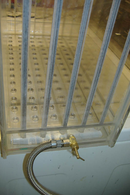

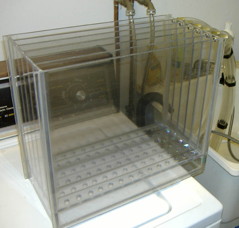

Hi Jesper,
For that sort of savings I would build one too. On the odd chance that it will help, I've included two photos. I apologize, but I didn't make any drawings, I just made it as I went one day. The corners are all held together with RTV Silicone and the separators just sit in grooves so they can be removed for easy cleaning. It was made using a table saw and a drill press and it is large enough for 11"x14" prints.
Good luck,
Neal Wydra
