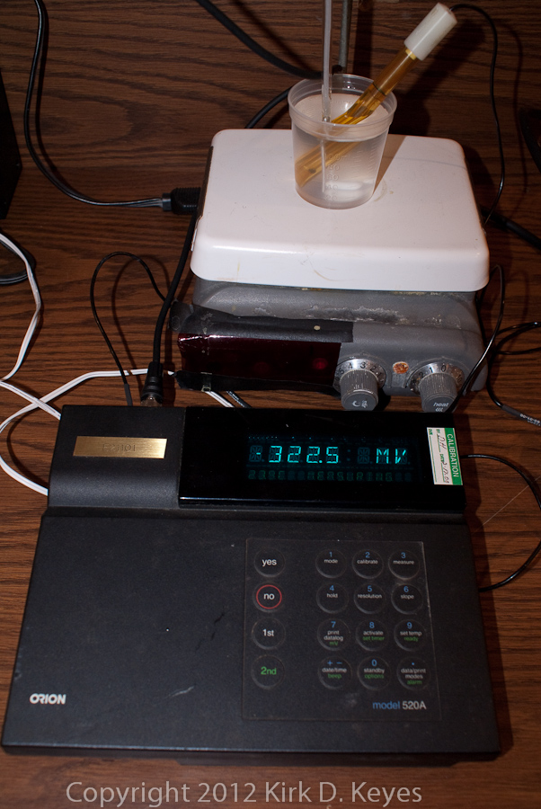

Here's a photo of my home-made vAg electrode as I discussed above:
And here it is in action in combination with a double junction Ag/AgCl reference electrode (in, I think, a potassium iodide solution):

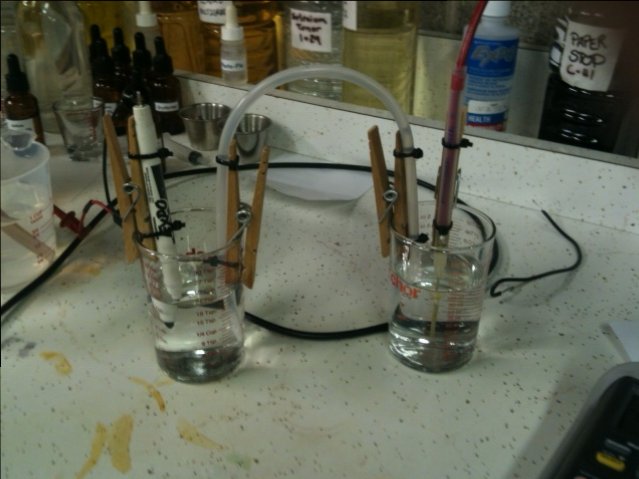

OK, here's the felt tip pen reference electrode and the silver electrode with the bridge. The left glass contains a 100 ml 0.1M KNO3 and the right one contains 100 ml 0.1M KBr. The bridge contains a 0.1M KNO3 solution gelled with ky.
The other photo is the meter setup with a high impedance interface buffer box attached. The interface is battery powered and uses a very high input impedance AD824 opamp as a unity gain buffer. The buffer box is not needed, however, as I get the same reading with and without it.
My initial reading is -74.8 mV. From an old post I found here, the reading should be around -51 mV. The reading stays rock-steady. Earlier, I tried the 0.17M KBr solution used for plating the silver electrode and that gave a reading of -96.5 mV. So possibly I will need a POT to calibrate or find the source of the error in the reading.

Is the electrode plated properly and is the VOM high impedence? I gave some plating and VOM information here on APUG and also in the book. My tests come within 6 mv of those calculated.
PE
I think it's plated correctly, but this was a first attempt. I think I will clean it and try again to see what happens. The meter does have a high impedance input. I borrowed it from the lab at work and it was just calibrated so it ought to be correct. Besides, the opamps in the buffer box use j-fet inputs IIRC and have in input impedance on the order of 10^8 ohms! I get the same reading with and without the buffer.
How much would concentration of any of the solutions have to be off to make that sort of error in the reading? I am guessing pretty far off for the sort of error I am seeing.
Probably would be a good idea to check out the homemade reference electrode as well, once I figure out how to do that. Open to suggestions!
My first suggestion it that your beakers are upside down in the first photo - stop working on the cieling! All the solution will fall out! ;^)
Don't worry about the interface box - a modern VOM should have high enough impedence that it will work fine. Keep things simple. And don't put a pot in there - it's not needed.
Stir the test solution so that fresh solution is being brought to the electrode continuously.
Also, try replating the electrode - I think it took me a few times to get mine seasoned so that it worked better.
And most important - remember that reference electrodes are half the equation. If your reference electrode doesn't match everyone elses reference electrode, then you will have a fixed bias, positive or negative, from everyone else's results.
Make a series of solutions with a log series of concs, like say (and just pulling numbers from my head) 0.03M, 0.1M, 0.3M, 1.0M, 3M and then measure those. Plot them on some Gran's plot (semilog) paper and see if they are linear. If so, then you have a functioning elelctrode. If there is a bias, then it could be the vAg electrode or the reference electrode. If there is no linearity on the Gran's plot paper, then something is not working as it should.
The electrode should be clean to start with, and the plating should be done under dim light. After all, you are forming a silver halide. It is light sensitive.
PE
