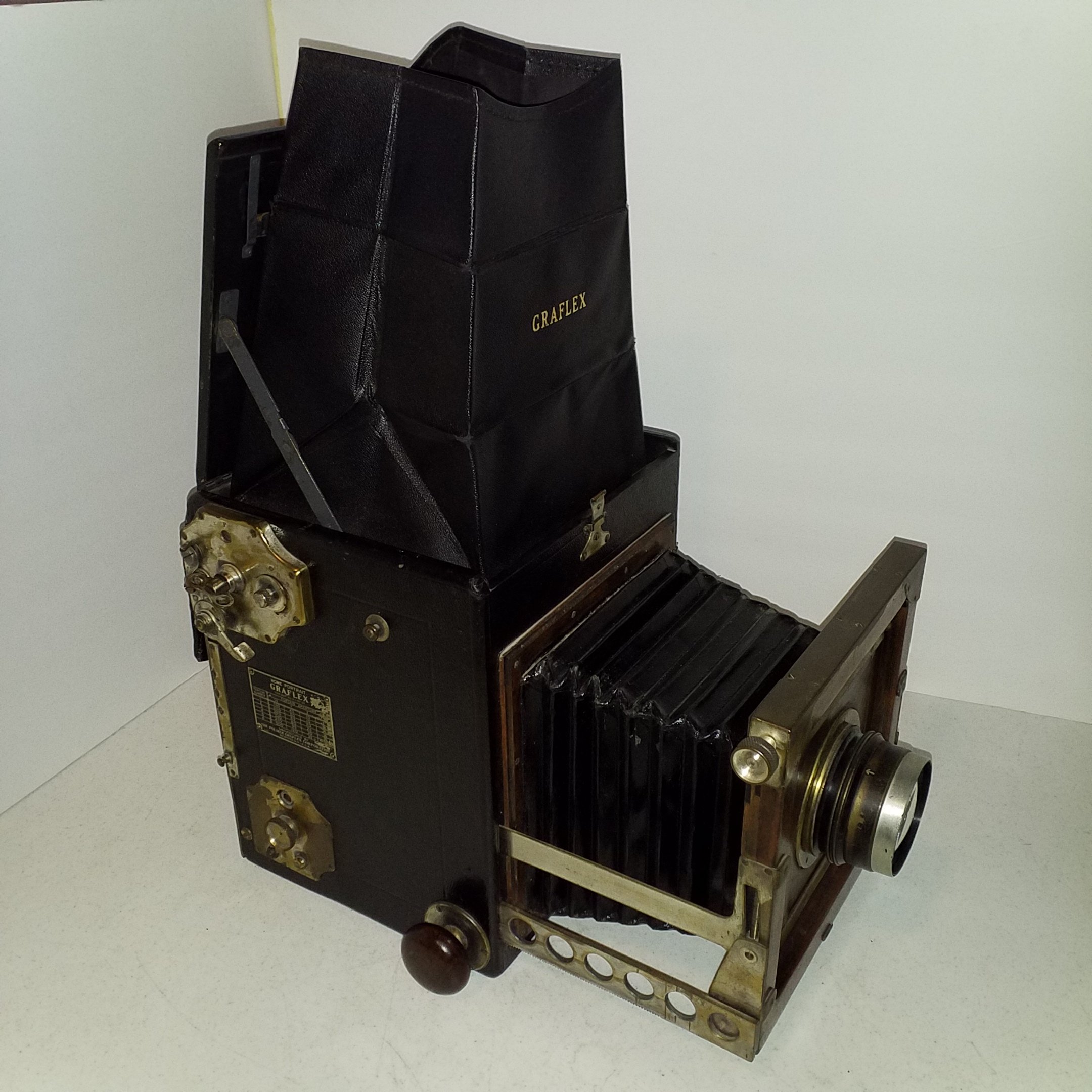

Trying to decide if I could afford and or justify the cost of having this baby restored for use. It doesn't seem like it's really that far off...everything like the levers and knobs are just basically tight from non use and lack of lubrication, shutter curtain isn't smooth cocking or operating, lens aperture is tight to adjust, etc. I don't currently have a large format camera and it's very enticing. It's cool, but I'm much more familiar with the 4x5 crowns and pacemakers...which I could get back into a lot easier (and less costly) than this. And maybe just pass this along to someone who is more capable and interested in this specific type of large format. Just looking for some thoughts and opinions .

Pass. Not because it wouldn't be a really cool camera to use. But because if you're worried about costs, don't buy an old camera that needs a lot of work. There are things you know that are wrong with it. And there are things you won't know until you get deeper into it. And on top of that, it's 5x7 film, which is expensive and hard to find. Not only that, but finding the proper film holders for it in good enough condition to use can be a real pain.
There's just too many ways for this to go sideways on you. You're better off buying a camera in good working condition now. And probably one in 4x5 instead of 5x7. A camera like this would be a great project for someone who likes working on cameras (and be okay with not getting their money back if they decide to sell it). But from the sound of it, you're more interested in shooting cameras. So I'd look for something that's ready to go right now, without any work.
That's just my experience. And I've repaired over 100 cameras in my life. I really enjoy doing that stuff. But even I would shy away from that one, unless it was dirt cheap, or I really just wanted to work on it for the fun of working on it. You could be right, and it could all be a bunch of easy fixes. Mostly just clean and relube. But it seems that every time I think a job will go that way, it takes a drastic turn for the worse. I'd much rather deal with a camera with one known broken part than a bunch of parts that kind of work.

I've owned a 5x7 Home Portrait, still have other Graflexes in 3.25x4.25, 4x5 and 5x7 formats. They're extremely cool cameras, but a Home Portrait in need of extensive repair is just about the last thing I'd recommend for someone who wants a convenient way to dip a toe into large format. On the one hand you're likely looking at a fair bit of hassle and/or expense to get it right, on the other when you do have it right you'll have a highly specialized tool with a very limited scope of utility.

I can get it working for $200 to $400 + materials + shipping. I might be willing to buy it if the price is right.
The main problems are the tension spring is likely weak so if the shutter is cleaned and lubed it will not run table speeds but will be usable. The rubber coating on the shutter curtain dries out, swells, and sometimes cracks off. Rarely the curtain base material deteriorates to the point where it has to be replaced. The curtain can be recoated making it light tight. Making a new curtain is a pain. I have yet to make a new tension spring for a Graflex SLR but have heat treated a few of them and gained some increase in tension but not factory new operation.
The lesser problems are the bellows needing repair and more frequently the view hood splitting at the folds.
Post its serial number, located behind the view hood on the view hood door or the frame around the view opening, for its approximate date. Dates were listed order number not as they came off the assembly line.

SN# 95438. I've done some basic light tight tests with a strong flashlight in the dark...bellows are light tight and so are some of the curtain sections I was able to test.

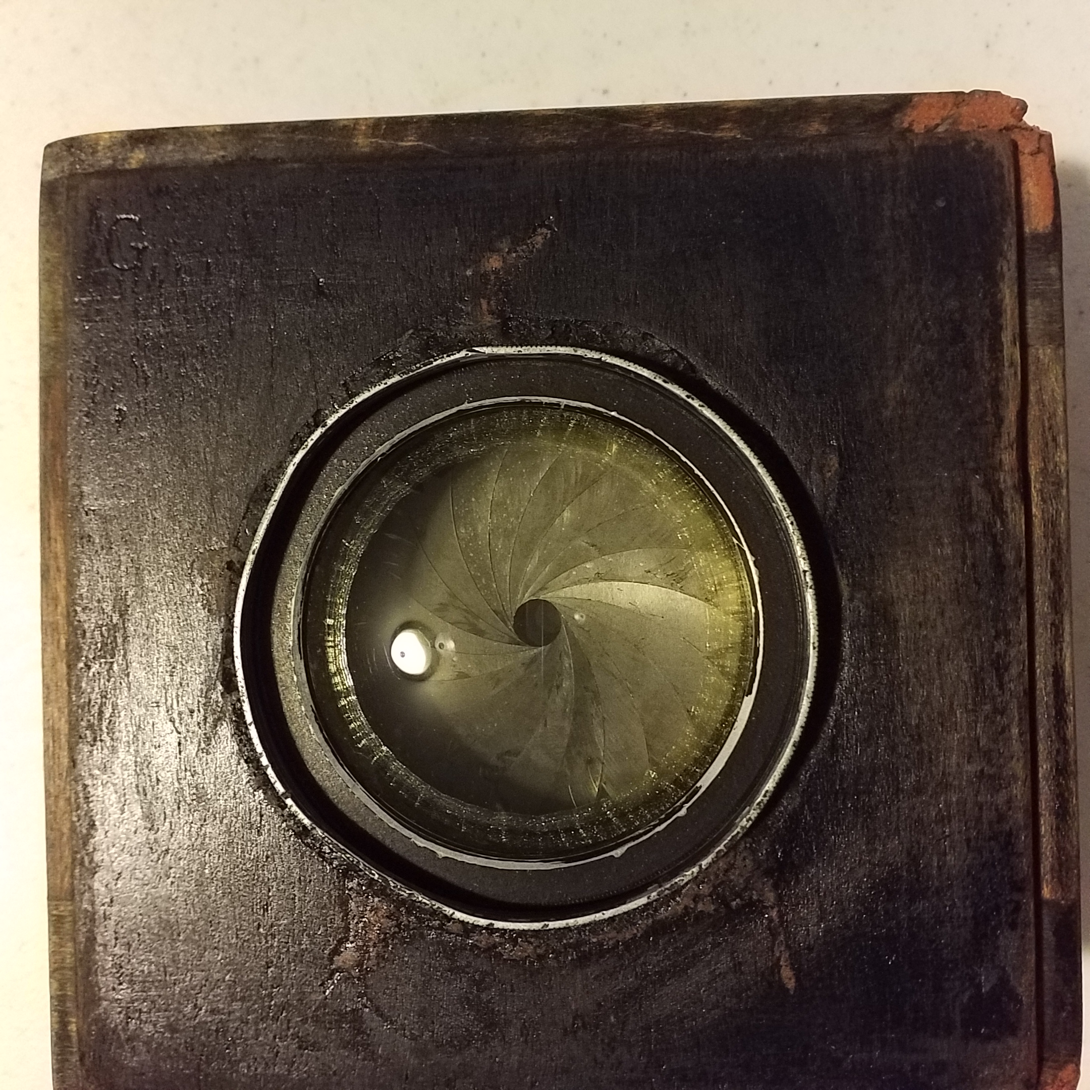

Lens question...The rear element on the lens with this camera has the outer edge etched/ground as shown. Is that for softness or some other effect for portraits? And, would that have been done when the lens was manufactured or a modification done later?

If a third party (commercially) has to restore it, it will be too expensive in economical terms. Therefore most of us who like the old ones, have learned to restore these cameras ourselves - very rewarding undertaking.
Please note that especially camera's with old MF or LF focal plane shutters are the hardest ones to restore.

The great thing about the Home Portrait, of course, is that it has a revolving back that allows the camera to switch from horizontal to vertical format. These cameras are few and far between and much sought after. I had one but foolishly sold it. Now I have a 5x7 Press, which is only good for horizontal shots. I would buy this one. Someone will be able to fix it.

I'd think a 80+yr old rubberized fabric 5x7" focal plane shutter is going to be a problem...

That is a user modification for edge softness/distortion with the aperture wide open. Its likely dried out varnish or similar material. It will likely come off with Acetone. Remove the cell before using lacquer thinner as lacquer thinner will strip the finish off the barrel.

I've come across some 100 year old curtains that were near new and some 40 year old curtains that were trash. It all depends on how the camera was stored/maintained over the years.

Well, I think I've realized that I probably don't have the passion that's required to restore and use this camera. I've restored/rebuilt and used a few crown graphics...and I'm much more familiar and comfortable wearing that hat. I'll probably just sell this one to someone who will give it the attention and usage it deserves. It was fun to imagine for a while. It would have definitely been the oldest camera I would have ever used. I wish I could know and see the life and times it has seen.

My understanding is that though this camera has a focal plane shutter, it can use leaf shutter lenses. Since the focal plane shutter is apt to have problems if you were okay just using leaf shutters that might simplify restoration.
grat
May 8, 2020
2,044
Gainesville, FL
Why is the focal plane shutter likely to have problems? If it hasn't been well maintained, it might-- but the shutter in my 1932 RB Series B just needed some lubrication and tension adjustment. My Mini Speed from 1946 works like a champ, as does my slightly newer (1951) speed graphic.
My combat graphic, however, was stored in a damp environment, and needs a full CLA. Surprisingly, though, the shutter fabric itself is in good condition.
