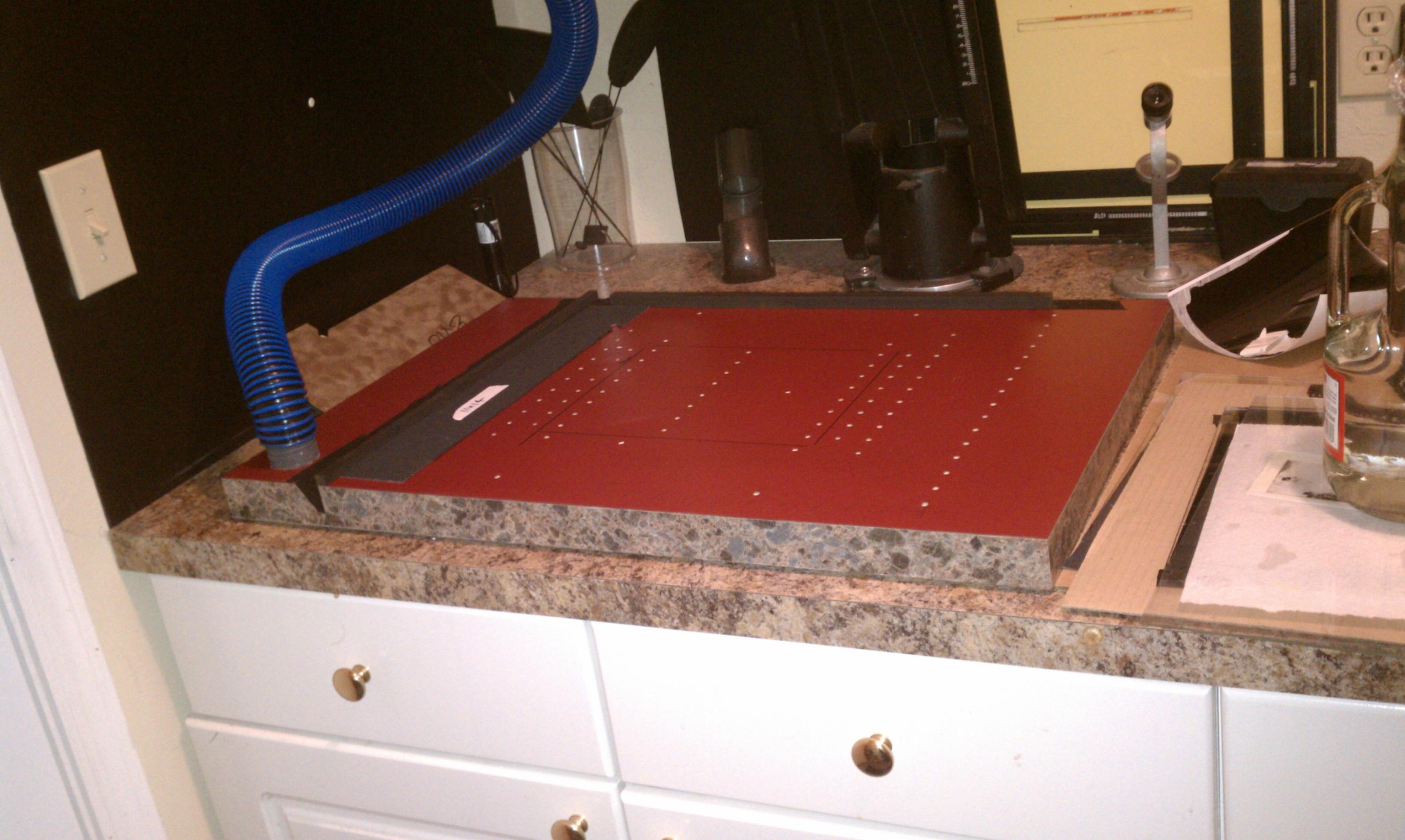

I built one a short while ago. Just used a shop vac, that sits in another room. Works great. I have no plans but its pretty simple, just a piece of plywood covered with formica, with a little hollow space below.
