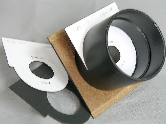

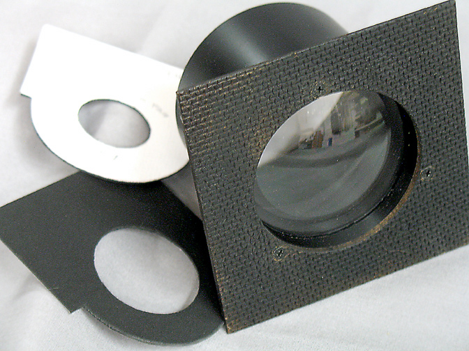

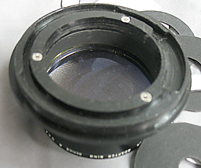

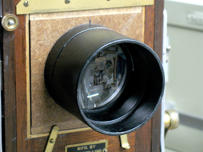

I just finished mounting a soft portrait meniscus lens for my 5x7 Deardorff.
I'm delighted with the results, it handles like an old 1800's barrel lens.
And the negative it produces is just like a classic 1800's portrait...
The lens is a simple meniscus lens of about 300 mm focal length and a 60 mm diameter, giving a maximum aperture of about f5.6.
This is more than a patch-up collection of paper tube and duct tape.
The barrel is machined from PVC tubing.
The lens is seated against a machined stop and is secured with a machined PVC retaining ring.
It's fixed onto a Masonite lensboard with stainless flat head screws from the backside.
The next iteration will have a PVC flange so it can be attached to a lensboard from the front with small screws, just like it was done in 1880.
For the aperture stops, a 1mm wide slot is machined into the barrel into which I drop stops cut from black 4-ply matboard.
The matboard fits the slot nicely so light leaks are not a problem... if I don't dawdle between pulling the darkslide and taking the picture.
At first, I draped a black sock over the stop to cut down potential like leakage.
I'm happy to report that black socks are not required in the subdued light of a typical studio.
For a shutter, I flip a piece of black matboard across the lens, (I don't use the traditional hat, this is the 21st century, after all...)
I develop by inspection so each shot results in a good negative regardless of the exposure time which is somewhat imprecise, to be sure.
The photo of Larry was shot on Arista EDU 100, developed by inspection in Pat Gainers PCT 1+45 for 6-3/4 minutes. Shot it at f8, about 1-1/2 stop smaller than wide open. It's a straight scan of the negative.

Thanks folks,
Before I post more images, I've got to get ok's from the others...
Niel;
Regarding lens selection, I'm working with 5x7, so I wanted a longer focal length in order to keep the subject as far away as possible. I'm not a fan of wide angle lens portraiture. Normal for 5x7 is about 210mm, so the 300mm lens I found is equivalent to a "long normal", a decent choice for starters...
I also wanted a reasonably fast lens (this is for portraiture, after all), so an aperture of 5.6 or better was my aim point.
I found a 65mm diameter lens that, when mounted gave me a clear aperture of 60mm and a maximum aperture of f5.0. (300mm fl / 60mm dia = f5.0)
Using the same formula I cut a variety of Aperture stops, from f6.3, thru f16.
I liked the f8 aperture best on the ground glass and most of my efforts have been at f8 so far.
On the ground glass F11 looked a bit too snappy and f16 was even sharper (like those old B&J paper weights).
In my limited reading on meniscus lens applications, the concave surface faces forward and the aperture stop is as close to the front of the lens as practical. I've got more information squirreled away somewhere, when I find it I'll post it. Unfortunately, much of it isn't graduate level optics either, but it's a start...

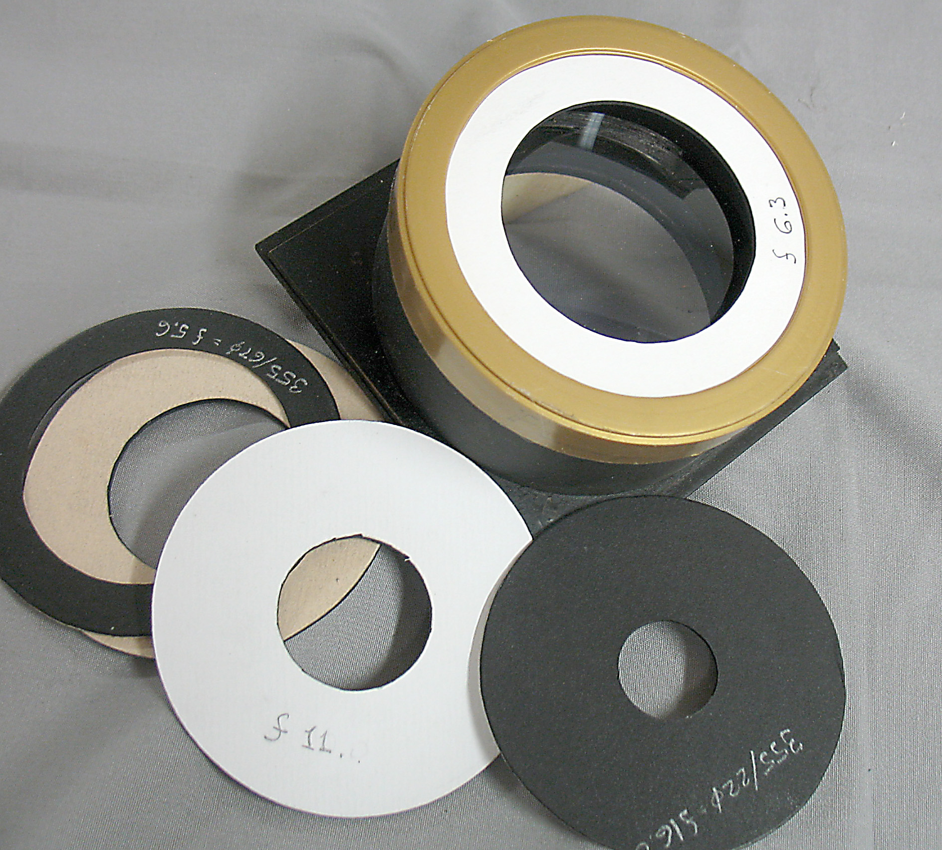

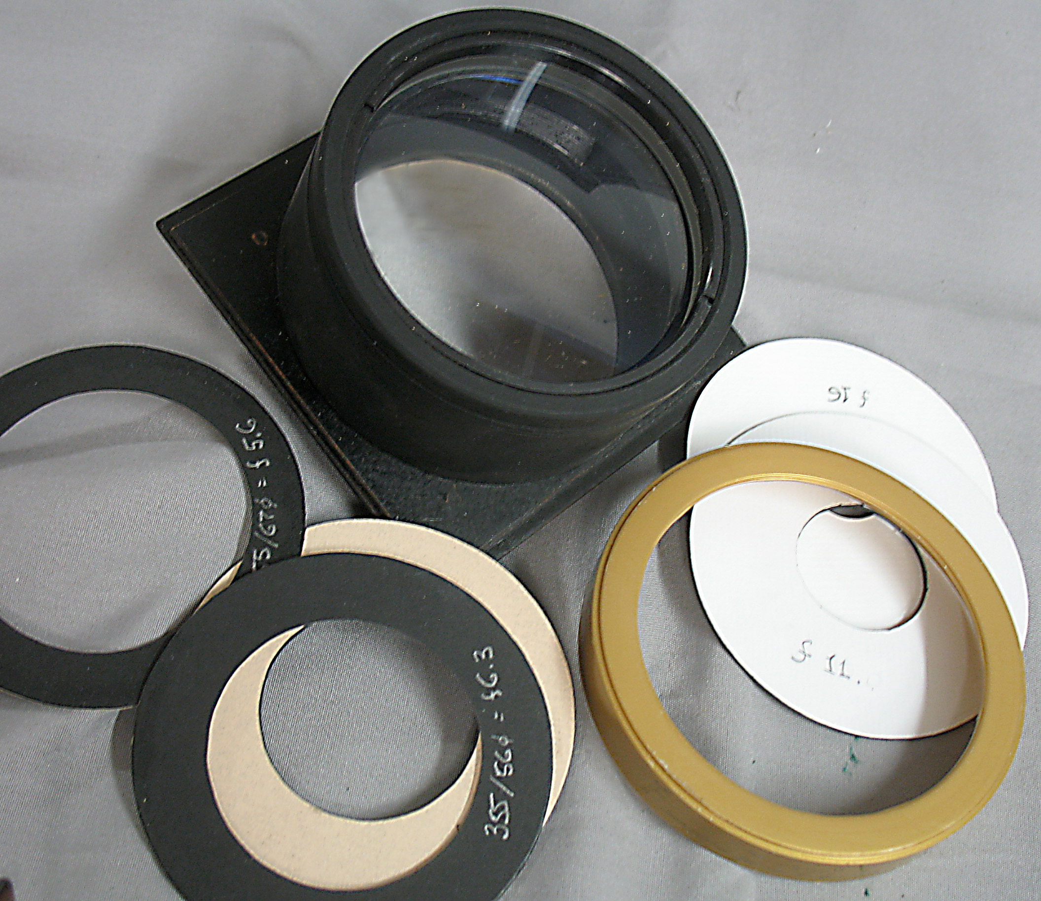

To keep from getting getting sidetracked, I opened a new thread on mounting packard shutters on the front of a lens here...
Back on topic...
Here's an example of using a front objective from some whopper binoculars.
It's about 350 mm focal length achromat, about 80mm diameter.
In this case I used the barrel from the binoculars, no need to make a mount.
Aperture rings are held on with a Haagen-Dazs ice cream carton rim.
It puts an image on the ground glass quite like Jim's photo of the toy car.
Nice, but I prefer the character of the meniscus for portraiture.
