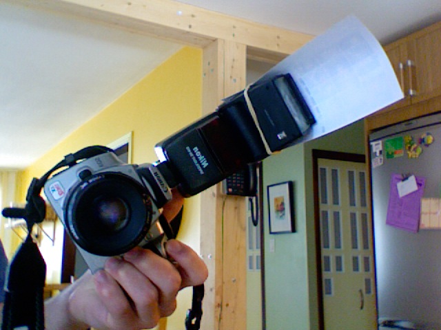

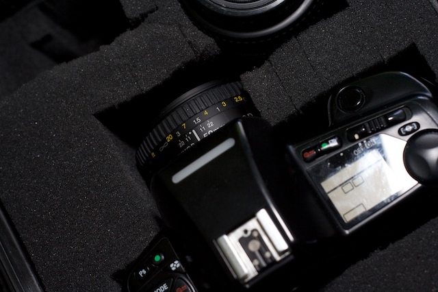

hmm, this seems to work well enough. the foot is metal, so there isn't really a chance of breaking it.
Heres a photo of the setup, and one of a photo taken with it. it looks.. somewhat professional. not exactly.

Marko's got it.
Here's a photo of the setup, and one of a photo taken with it. it looks.. somewhat professional. not exactly.
Marko,
That's exactly what I have been doing for years. If there is a white ceiling low overhead, or a white wall to the side, they can be used also and in conjunction to deliver a soft, more natural looking lighting effect. There is even less risk of red-eye, since the illumination is even further from the lens-eye axis. There is a hint of sparkle in the eyes. Up closer, where ceiling bounce might throw more downward shadows, the paper reflector offsets that by filling.
The flash I am using in conjunction with your idea is a Sunpak 544. It is of the sort that stands on a cylinder-handle, on a bracket, and onto which mounts the camera.
