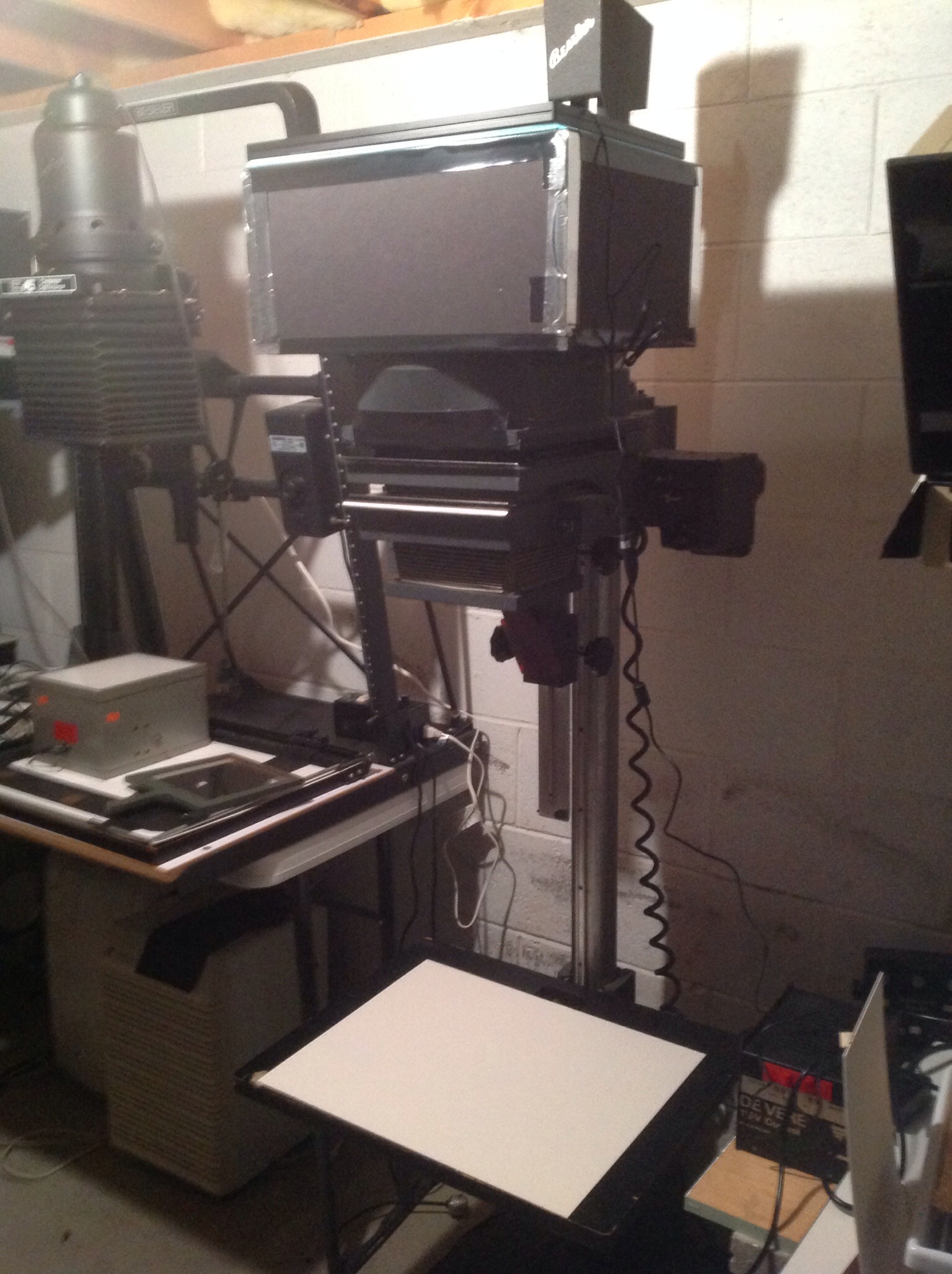

I didn't build a whole enlarger but have just converted an old Beseler 5x7 enlarger to an 11x14 enlarger. The riser and mixing box is made from 1/2" foamcore board. The light source is an led panel for transparencies. I have made good prints with it.
You enlarge 11x14? Why not get a bigger camera! Just kidding. Must be a heck of a machine.
Here's a picture of version 1,ugly but it works. V2 is in process now and will look very good. It's based on a Beseler 57MVT which had a big dome light source and provides a wide aperture for the big negative. The light source is an led panel from anythingdisplay.com. and the negative holder is a pc. of glass with non glare framing glass on top and a pc. of diffusion acrylic on top of that, under the light panel. It's as bright as my LPL 4x5,
