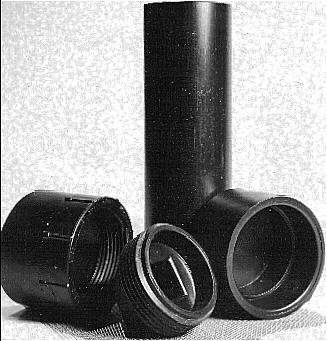

1 1/2" ABS tubing will not pass light. Try Home Delay instead, or perhaps a local plumbing supplier. tim
I made 4 like the ones shown above in an afternoon and they have served me well for years. I can't imagine why I would buy tubes that are so quick, cheap and easy to make unless I just didn't have the time.
So, you don't put the threaded pieces on, just the coupler for a friction fit? Does that leak? Funny thing, I bought BTZS, but I don't see any reference to the tubes, just tray processing. I must have an older version of the book.
Mine are a lot like Phil's. One end cap glued on. The other friction fitted. After I first made them I did a "dry" run to see if there was leakage. Close the tube, dry on the inside and did the roll-and-bob for probably 5 minutes (been a few years). Dry off the outside and open. No penetration.
That said, I haven't used them since I switched to a Jobo. And I didn't re-test them prior to the switch after about a year of service. It is possible that they could have started to leak.
So you don't actually use them anymore? Just the Jobo?
As I said, apparently the version of BTZS I have doesn't even mention them, are there specific lengths and such mentionned in Phil's plans? Are they designed to put the film in longways or shortways?
Put the film in the tub length wise, if you put it in shortways it will overlap and cause uneven development. If I recall my copy of Beyond the Zone System has measurements for make your own tubes in the appendix. I don't have the book handy but I think it is the 3rd addition.
