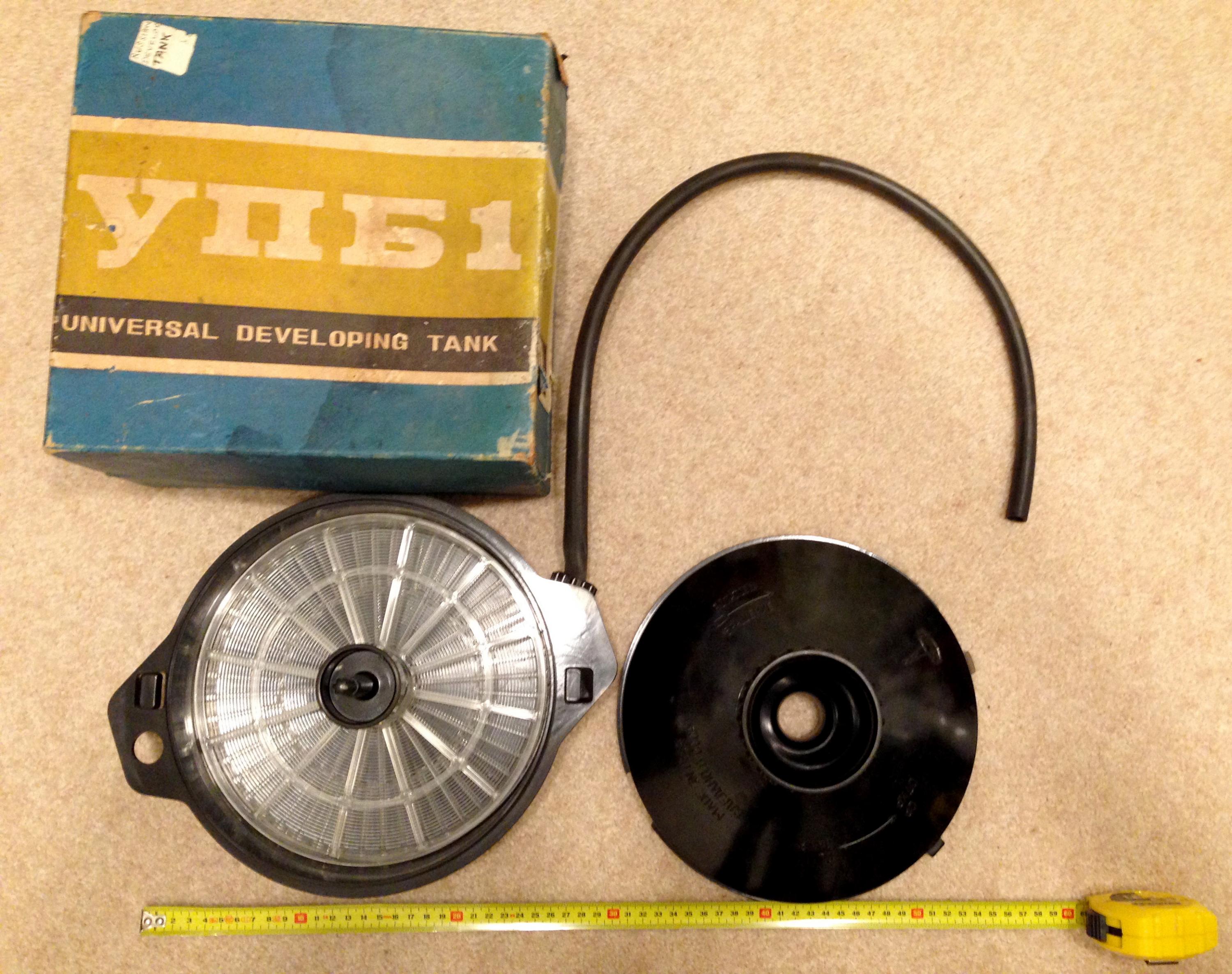

If you're going to buy a tank, get Lomo UPB-1A: It allows you to process the complete 15 meters of film (even 2 rolls at a time). Most of the other tanks only allow for 10 meters.
munz6869
May 17, 2004
1,303
ɐıןɐɹʇsnɐ 'ɐıɹoʇɔıʌ
Exactly!
In this hasty snap I made of my tank, you can see the reel is about 25cm in diameter!!
Marc!
