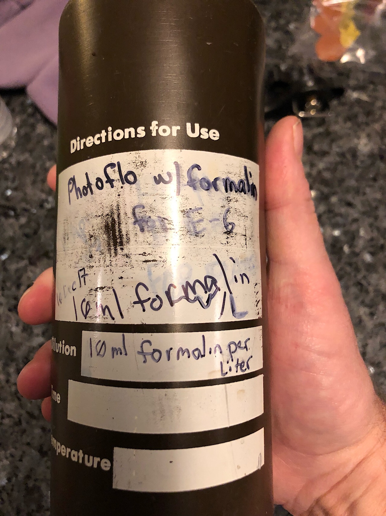

I mixed up a stabilizer per a suggestion that PE posted here a while back.

Excellent, where did you get the Formaldehyde? I used to have access to all that stuff, not anymore. Shouldn't need much. Back in the Good old days, I loved the smell of Formalin fixer :cry:.
Been a while since I bought it... It was probably ebay to be honest.

PE did a very convincing argument a while back on the inclusion of formalin in the process, as the common kits do not include it. I have connections where I can get all of the formalin I can drink :smile: but I'm sure that any chemical supply house that sells over the counter will stock it.

I use the Unicolor kit and develop 2 rolls of 35mm at a time in a Patterson tank. I use a Sous Vide to keep temperature constant. I mix the same formalin mixture as listed above with the photoflo. To make it, 1 liter of distilled water with 5 ml of photoflo 200 (1:200) and add 10 ml of 37% formaldehyde (that I purchased on Amazon.com of all places).
