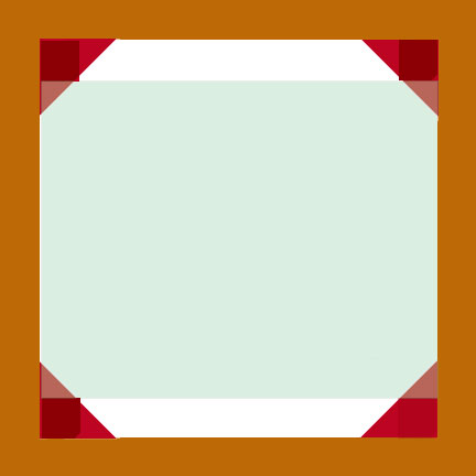

The first attachment is a basic diagram for a wetplate holder sans darkslide and door. Looking at the back of the holder, the plate glass (green) is held against the (red) glass or acrylic corners by the spring on the closed door (not shown). The small squares position the rectangular glass either in a horizontal or vertical orientation in the square back. A darkside would be in a slot on the opposite side of the glass. A light baffle would be internal at the top and there might be a trough at the bottom to collect fluid running off the plate. generally, this type holder is positioned over two small guide pegs at the base and then latched in place at the top of the holder.

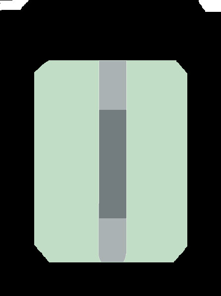

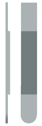

The other attachments diagram what I use as a "spring" to hold the glass against the focal plane in a converted film holder. Two narrow pieces of acrylic are glued together. The upper piece runs the length of the holder opening. The shorter piece contacts the glass plate only in the middle and holds it firmly against the glass once the darkslide is in place. Having the smaller central piece eliminates any contact with the glass along the edges where fluids could migrate by capillarity if the plastic strip touched the plate edge. This helps minimize the formation of oysters on the front of the plate. The size of this strip makes it easy to find in the darkbox, easy to insert into the converted film holder, and I think it holds the plates better and keeps them from slipping as often happens when pieces of metal or old milk jugs are used as springs.
