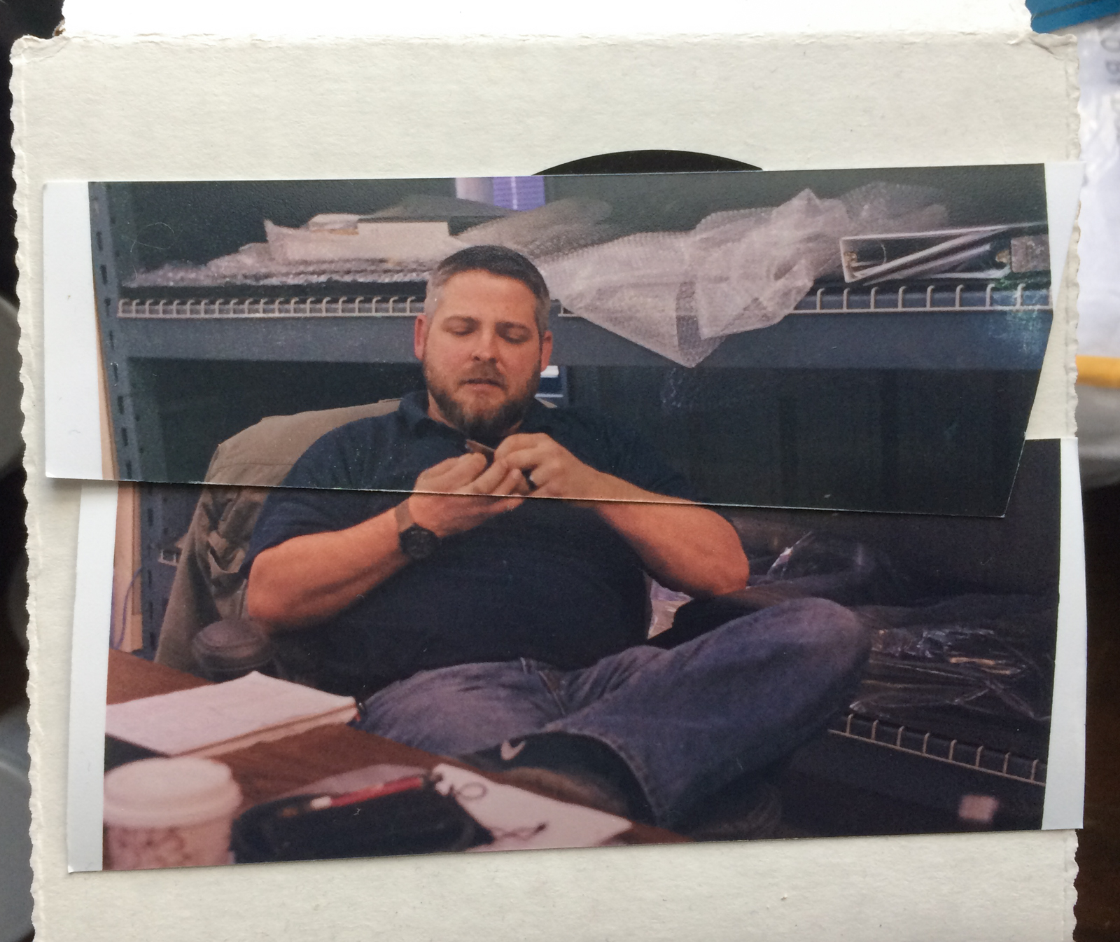

I got my roll of Fuji Crystal Archive paper and had my RA-4 chems mixed up. I'm anticipating getting a used Jobo CPE2 over the weekend but I couldn't resist just testing to see if I could cut a piece off of the paper, get it in the enlarger the right direction, and get SOMETHING to appear.
Wow...what a thrill. It worked!
I couldn't remember the times for the developing and blixing so I just arbitrarily used 2.5m each; I'll have to look that up.
I also didn't do anything to warm the chems up since this was just a test to see if something would appear, not that I could make art. I believe the temp of the chems was 66 deg f.
I started with 50M and 50Y and then after viewing with the kodak viewing filters It seemed like it was too red so I decided to add 10 more of each. It's hard to see from this picture but it did improve it.
To get the time, I used my analyzer pro and picked a medium grey from the image (there just happened to be something that I thought would be close to that in the picture.) I'll figure something better out when I do the real thing.
I'm just happy that something came out and it was half-way decent.

I looked very closely for the colour crossover that some suggest are almost certain to occur at as low as 70F, never mind 66F, but I can see any here.

Looks good! It is a kick to see; a couple of test prints with the viewing filters can get you really close on density and filtration. I always shoot a full frame gray card, it makes it very easy to match up density and filtration.

thanks for the great news! I have been wanting to try color printing for years but kept away because of the high temp many people claimed was necessary and the thinking that color balance would be next to impossible. looks like im gonna need to give it a try

RA-4 is awesome. You could probably develop faster in trays than in tubes,. I have tried over developing, as long as you don't cut it short it develops to completion then stops. My prints at 100 F for 45 seconds look the same as 100 F for 90 seconds. Blix is pretty much the same story. If I had 100 identical 8x10s to print. I would get out my trays, warm the chemistry up to 105 F and go to town, replenishing along the way.
By the way using a Thomas safelight with the color filters you can see what you are doing, more or less and it doesn't bother the paper
Color printing is a blast and it's cheaper than stink jet

I will definitely do that also!

Crossover at these temperatures occurs with C-41, not RA-4.

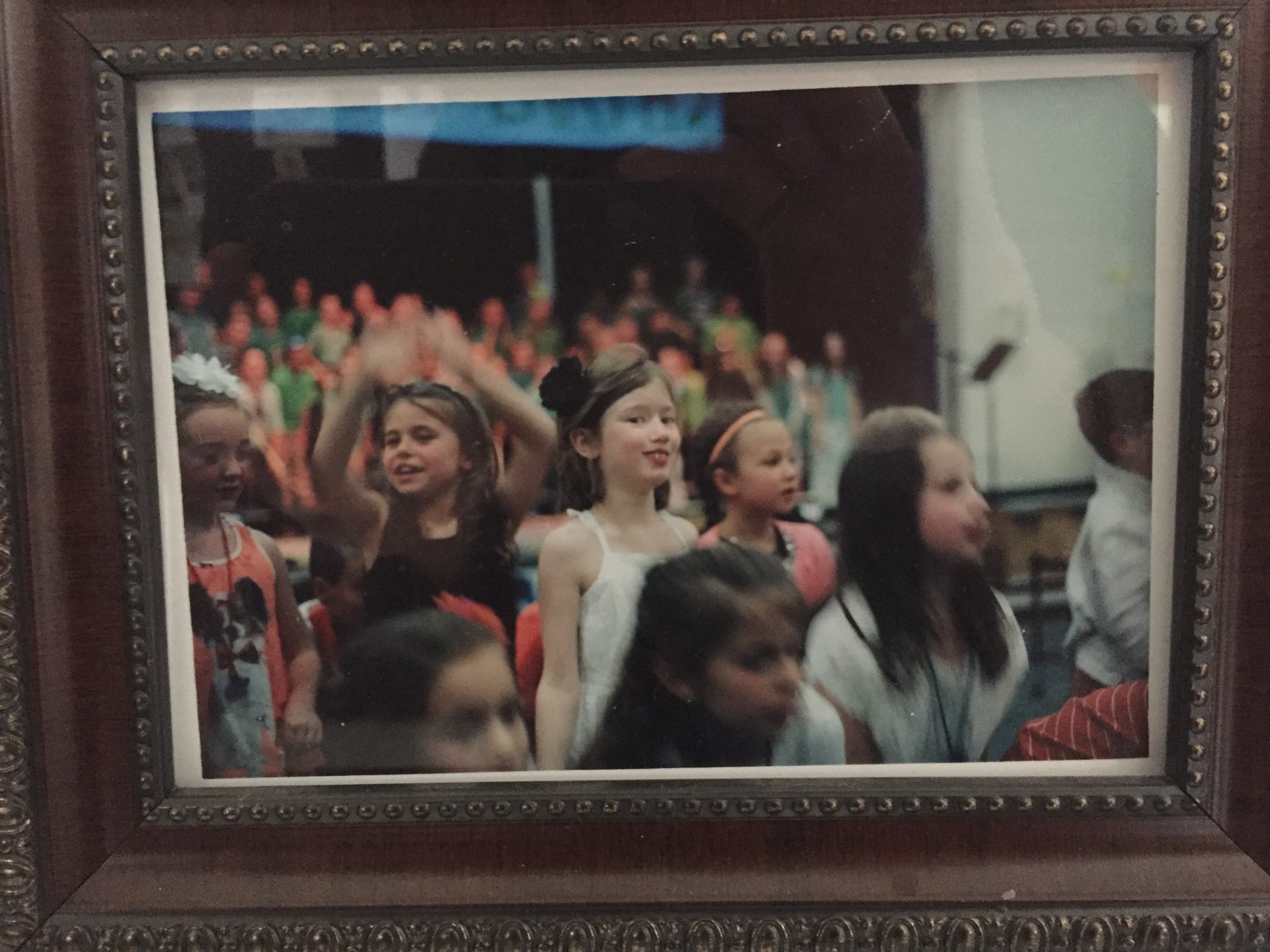

Btw here's a print developed in a tray with RA-4 at 68F. I think this was from Ektar 100:

It not only will be faster, but better, to do it at the higher temps if possible. Good first effort though!
