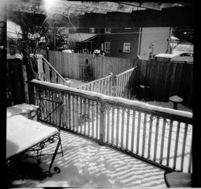

The result is pretty good. The lens is slightly too far from the film plane though. It doesn’t quite focus at infinity. I did not even attempt to create a lens which can change focus. I’m happy if I can get from 12ft – infinity in focus!
As you can see from the attached picture, I’m not getting that yet. So I think shaving 1mm or so off the end of the lens barrel would help to bring the lens closer in.
I did try using a copal 0 shutter originally but the maximum aperture was not quite wide enough and there was fairly serious vignetting. I’ve attached a picture which was taken with the copal 0 shutter.
The images don’t have the Holga vignetting. I think the vignetting is a result of that inner square box around the original square opening? I do miss the vignetting and would like to recreate that look some how? However, I could just burn it in in the darkroom (as I shoot primarily B&W)
The other issue is that now that the middle section is gone, so is the tripod mount! The reason of this project was to shoot with a tripod with lower shutter speeds (without just using B mode).
So, I'll have to figure out how to install a new tripod mount on the bottom of the camera body.
The picture of the deck in snow is taken with the copal 1 shutter and the other with the vignetting is taken with the copal 0.
