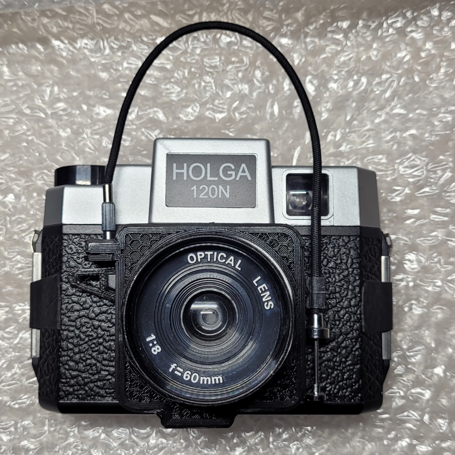

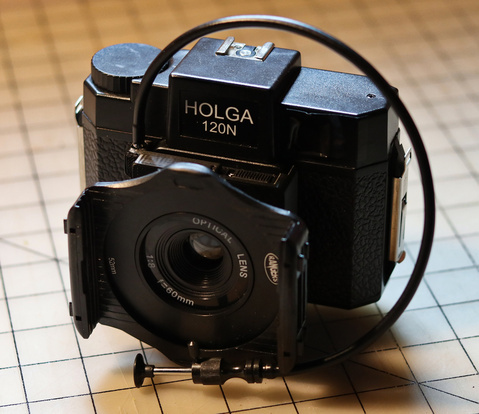

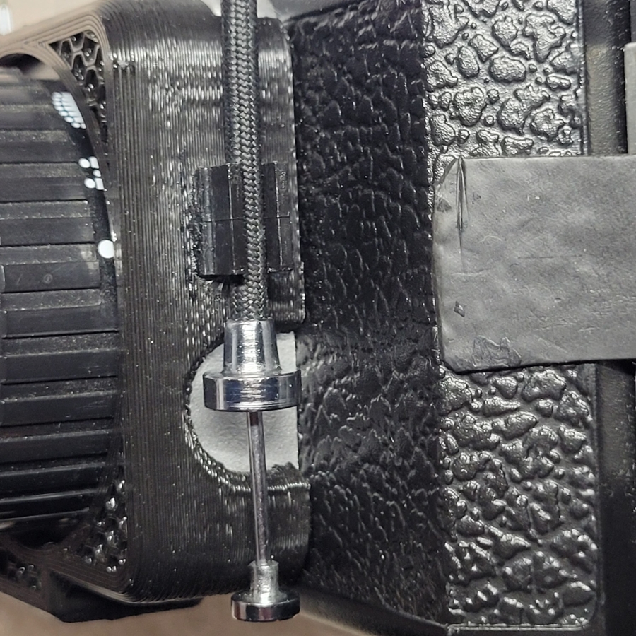

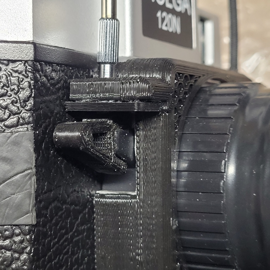

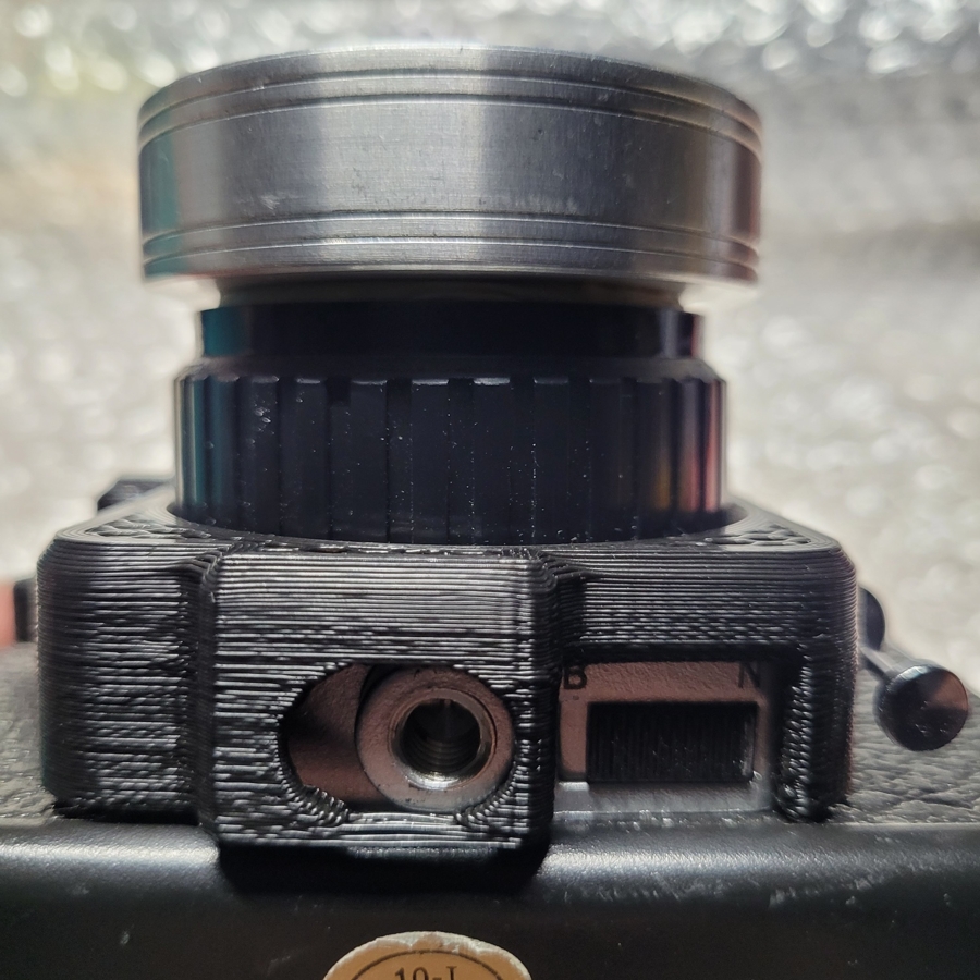

Late to the party, but I found a shutter release adapter on thingiverse.com (https://www.thingiverse.com/thing:4759644) and had the guys at the shop 3D print one of these for me. Got the adapter a few days afterward. Crudely done as I wasn't too particular about how it was prints just that I got it before a deadline. One must use a tripod mount to keep this adapter in place. The only issue I encountered was locating the cable. I purchase three differant cable via Amazon and all of them failed. I had to spend $90.00 bucks for a German made cable and I've not looked back since.
also, take notice of the generic slotted filter adapter. it uses a 52mm lens ring which fits snuggly over the Holga lens. Something to consider for all those who are thinking about using filter with their camera. Once everything was in place we ventured to parts unknown for our yearly fall travel. used up 7 rolls of film and I'm currently waiting for a few of these roll to be developed.

The holgamods adapter.
I also attached a cable holder thingy that I sourced from my "junk" drawer aka the garage. Besides holding the cable securely 'out of the way' it also allows me to release the shutter with my thumb while placing two fingers on top of the camera (not that I normally do...but I can).:smile:

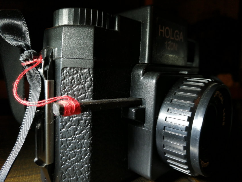

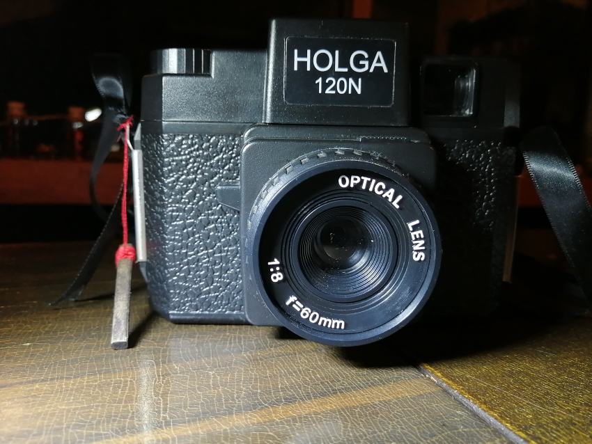

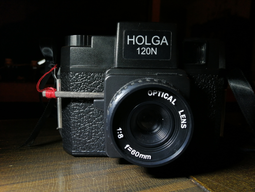

Just wanted to say that if you're doing a cheap mode by sticking a nail in the shutter leaver.. you're still not gaining the full effect and you must touch the camera while doing this. One needs to using cable adapter that mounts to the camera but one needs to stand away from the camera when the cable is actuated. Now one can hold the plunger or twist the tightening screw when doing this. For me, so far 20 sec exposure has bene enough I have 4 more rolls to inspect once the lab is finished with them. Just remember if you want a still shot, best set up for a long exposure on a tripod and a long cable releases. A quick plunge then a slow release as not to disturb the camera.
