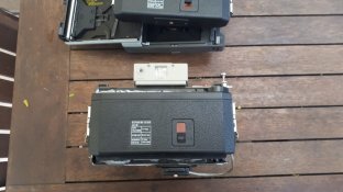

I use the following two Holga cameas;
1. Holga 120 panoramic (front left)
2. Holga 120WPC wide pinhole camera (back left)
Since I have other 120 cameras that produce 6x9, 6x7, 6x6, and 645 images, I do not use my Holga 120 panoramic for those images. Since my Holga 120 panoramic is the only camera I have that produces 6x12cm images; that is the only way I use it
The biggest problems I have with my Holga 120 panoramic are:
1. The image quality is not that great. I get better 6x12cm images by shooting 4x5 inch film in my view camera and cropping it to 6x12.
2. The Holga 120 panoramic does not accept a cable release. I really need to be able to attach a cable release to the camera.
3. The Bulb and 1/100 second shutter speeds are too restricting for exposure control.
4. The f/11 and f/8 aperture settings are too restricting for exposure control.
5. The film advance for the camera is from left to right. This works fine for 6x6 images. The user can use the top red window on the Holga back to count twelve 6x6cm images. If shooting 6x12cm images, the user can use the top red window to count odd numbers (1, 3, 5, 7, 9, 11) to count six 6x12cm images.
If shooting 645 images, the user can use the bottom red window to count sixteen 645 images.
If shooting 6x9cm images, the user can use the bottom red window to count odd numbers (1, 3, 5, 7, 9, 11, 13, 15) to count eight 6x9 shots per roll.

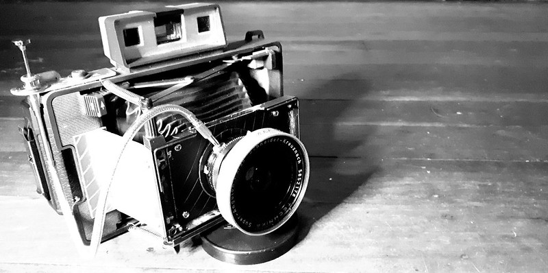

The poor mans version. Just hack a wide pinhole to a Polaroid and then fit your preferred lens.
holgaroid by Paul Fitz, on Flickr
