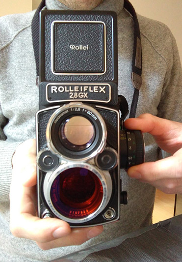

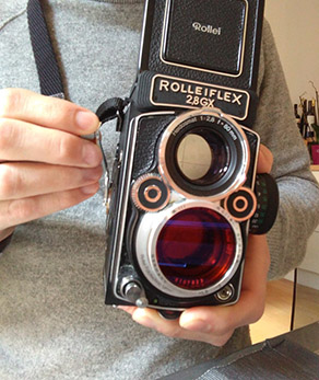

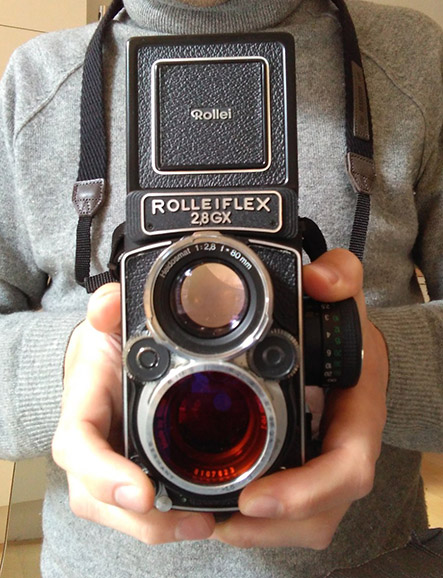

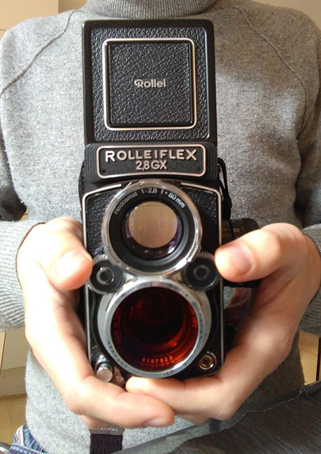

My way of doing it is to hold the camera "in the palm of my hand" (with either hand) and alternate left/right/both hands depending on what I want to do.
I just made a few low-quality pics with my cell phone to show you:
Focusing:
Adjusting exposure: supporting the camera with both hands and adjusting with the thumbs
Shooting with the right index:
and finally cranking: (this one should be the easiest :D)
Hope this helps :smile:
