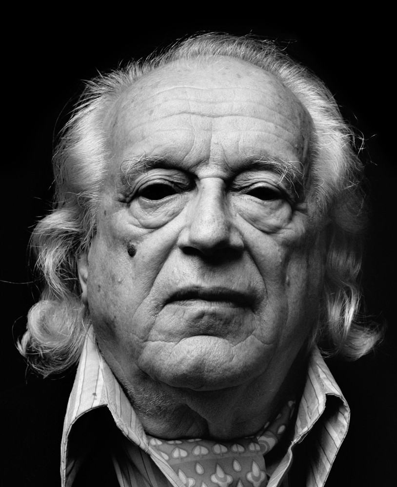

How can you print a portrait whitout eyes?
The Prado Museum (https://www.museodelprado.es) inaugurates “Mascaras”', organized in collaboration with PhotoEspaña. This is an exhibition of 18 photographic portraits of Alberto Schommer, a very good Spanish photographer. The portraits are simply amazing. Many of them have the peculiarity that there are no eyes. As an example, look at the Rafael Alberti portrait. It has been made with traditional Black and White film. Can someone suggest how it can be done?
Thanks,
Henry.

If you use orthochromatic film you can make light blue eyes disappear. It was a real problem in silent film days before the use of panchromatic filkm.
Jim Noel
Mar 6, 2005
2,261
That is the correct answer.

What about with the white area of the eyes?
Good point. Before I had seen the answer about ortho film I was going to say that with very careful "burning" it would be possible to turn the whole eye, including the white cornea, black, wouldn't it?

I think the simplest way to accomplish this would be to cut the eyes out of the negative, or to selectively bleach the eyes on the negative to get down to the film base.

I almost always dodge the eyes on a portrait because I want them to stand out, but I suppose that you could carefully burn. You could make a print, and then cut out the eyes to make a mask, then burn through the mask.
If you did not dodged them enough - I learned recently that you can slightly make them lighter (and more pop uout) with very diluted potassium ferricyanide.

I think that is what was done here.. not to mention exposure development of the negative to record mostly the high end and drop the shadow end.. The lighting also helps.
If you drag this image into PS you can brighten the image to actually see the eyes, that is why I do not think ink was applied to the print.
