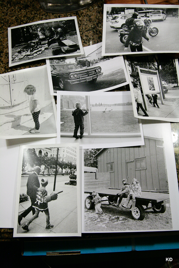

I'm not sure if I'm matching prints and prints scans I have in the Gallery. Too different on the screen and on the print.
I selected bunch of prints where I didn't screwed contrast badly. And asked my wife to select from them. I took picture of some she was OK with. Some FB, some RC.
attachment.php
It seems what she likes it balanced.
I will keep her selection and exam it under day light.
Four prints are from FP5+ @1200, the rest is box speed and different cameras (some with AE), films.
As much as I want to keep the rest ( most are family pictures) it seems to be better to recycle them and re-print new ones with better contrast.
Looks like it as part of the problem as well. Too much prints with wrong exposure, contrast.

The prints don't look so bad. I was expecting them to be much worse than that from what you said. And its difficult to tell from a photograph of a photograph how well they are printed or not.
frank
Dec 6, 2002
4,359
Canada
Select a lower criticism level on the wife's control panel. In the pic of your prints, they look fine. Maybe she wants you to do more work around the house. :wink:
winger
Jan 13, 2005
3,975
southwest PA
That was kinda my thought, too. From the photo, they look fine to me. Everyone's eyes don't see things exactly the same.
Maybe take one of the ones she doesn't like and print it a few times - some with less contrast and some with more - and ask her whether that improves it for her. And make sure she knows that the important parts are whether you as the artist like them and whether they depict people and situations you're going to want to look at in 10-20 years. Sometimes, it's not about the technique, but the subject.
