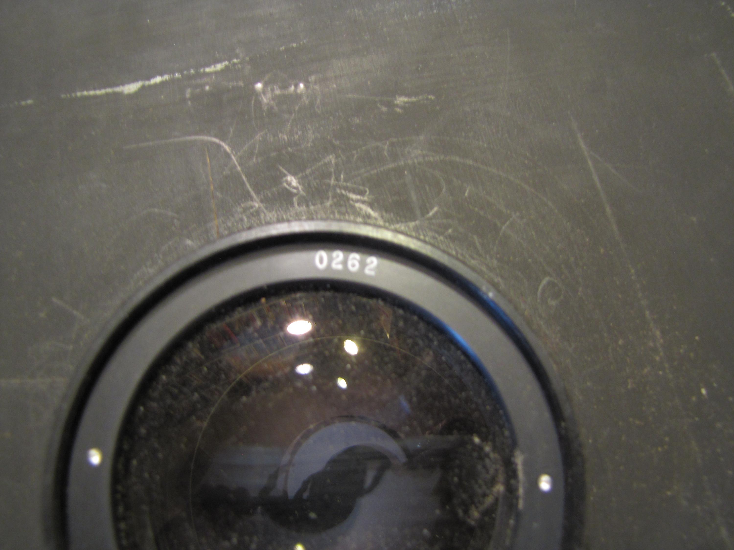

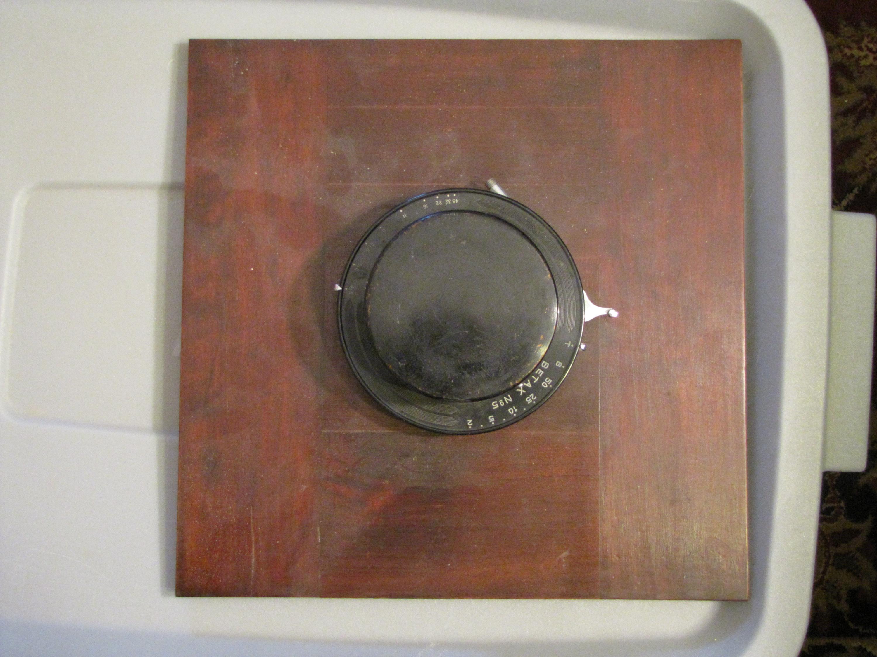

A square 11" x 11" board with a Wollensak lens Betax No 5 (there is a number 0262 stamped on back).

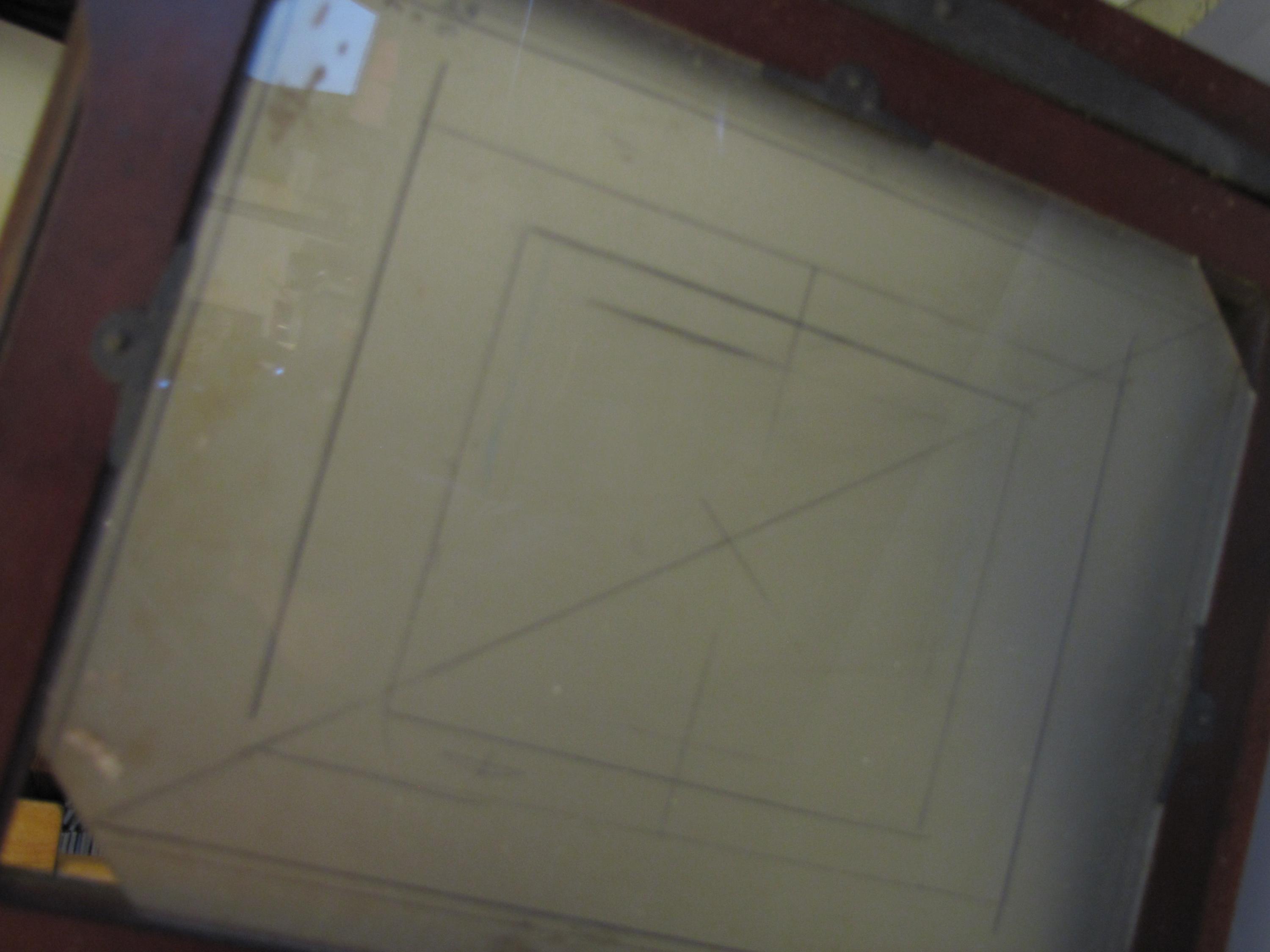

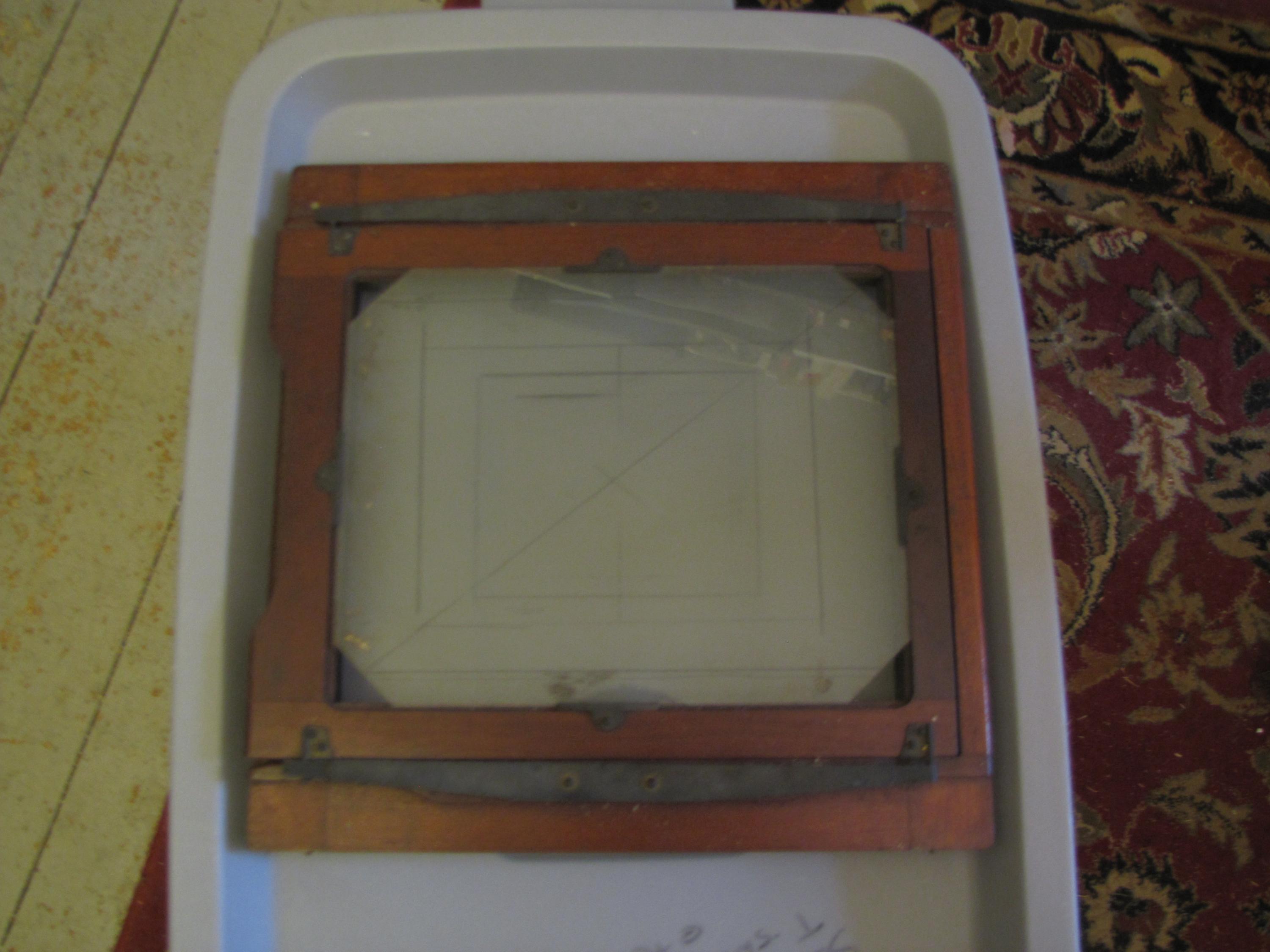

A square 13" x 13" board with a glass plate and hinges (the film holder? )

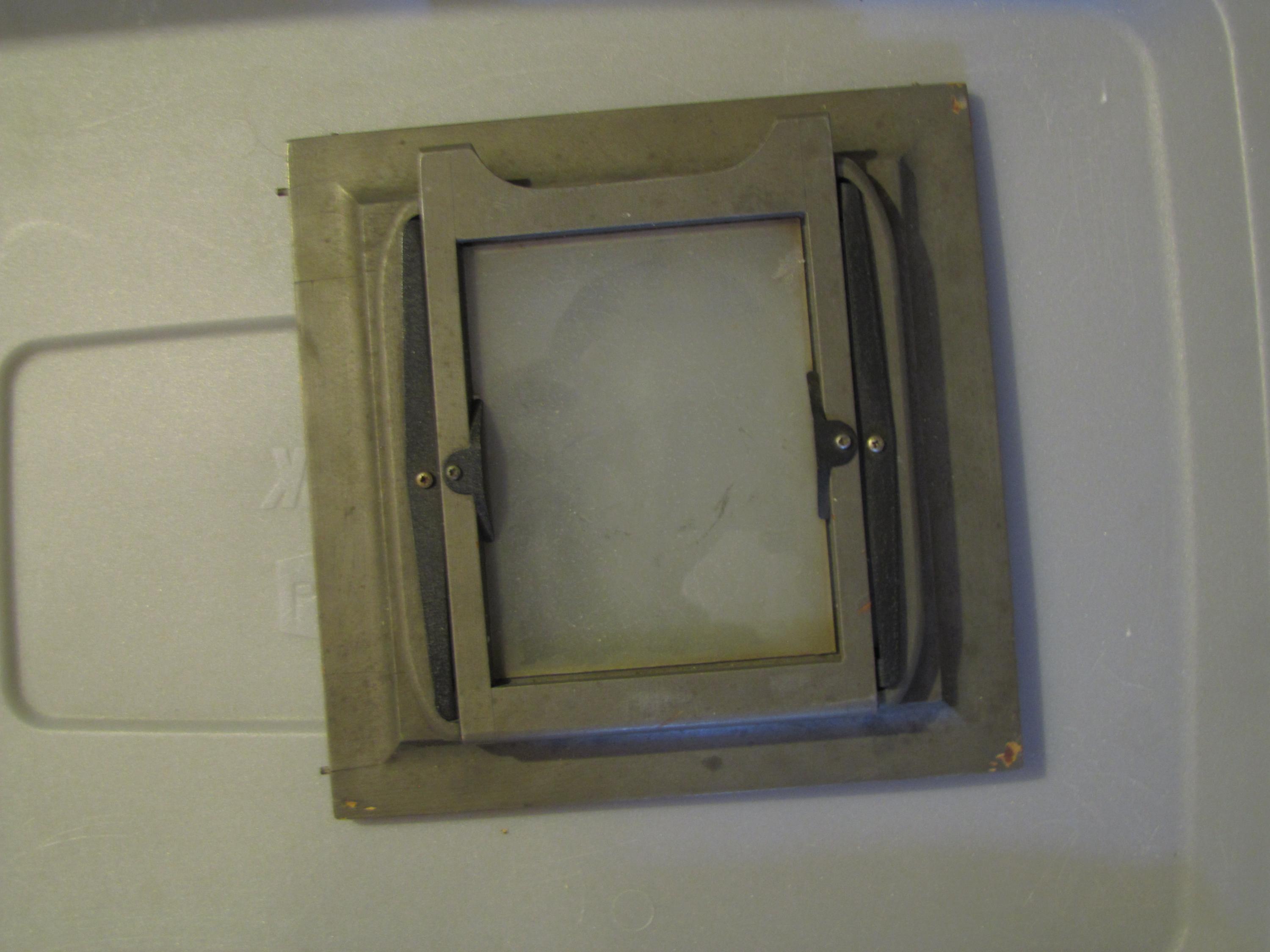

A square 8.5" x 8.5" wood board with glass plate and hinges (similar to above but smaller, wood is painted grey, and it appears newer?)

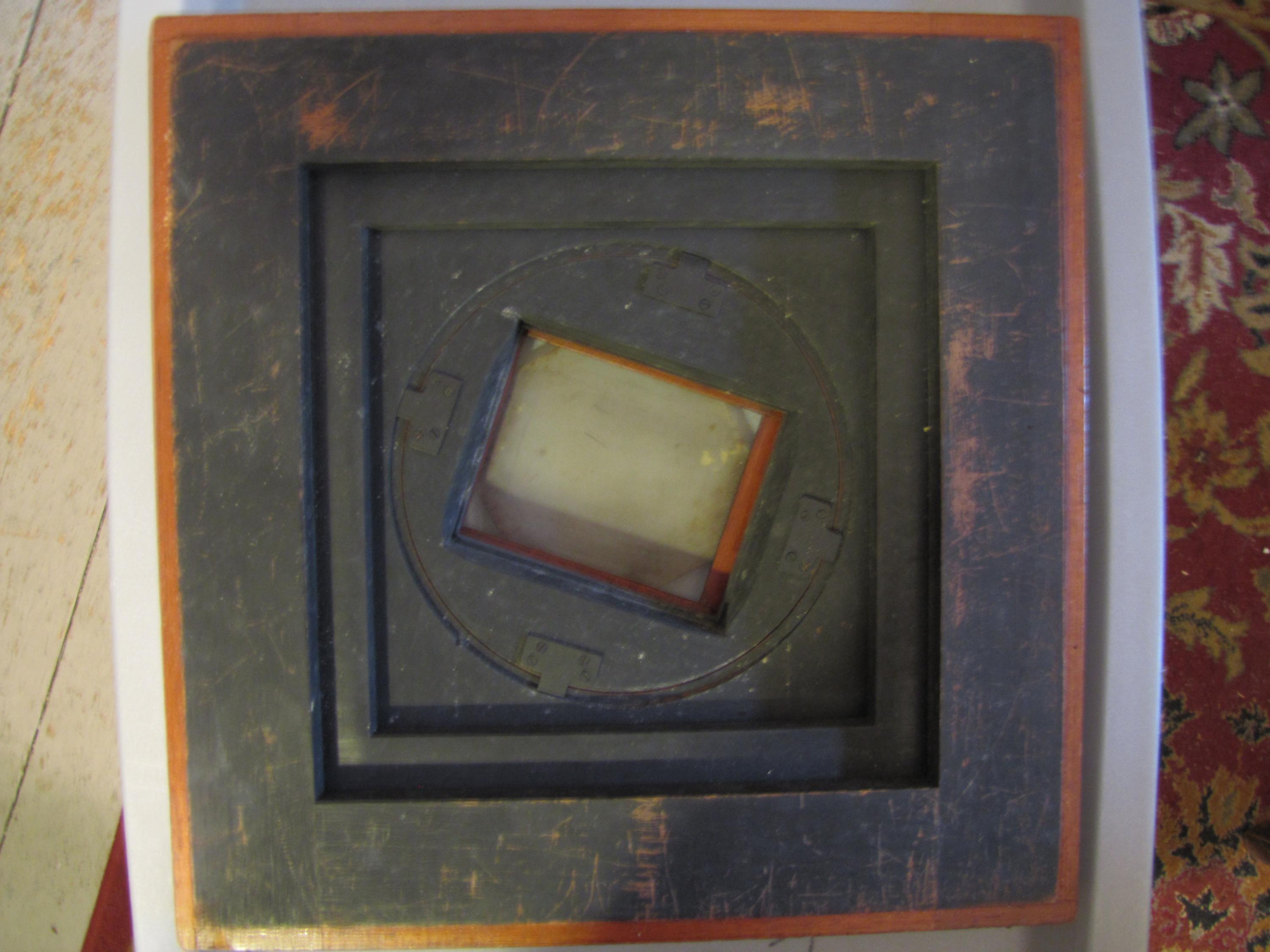

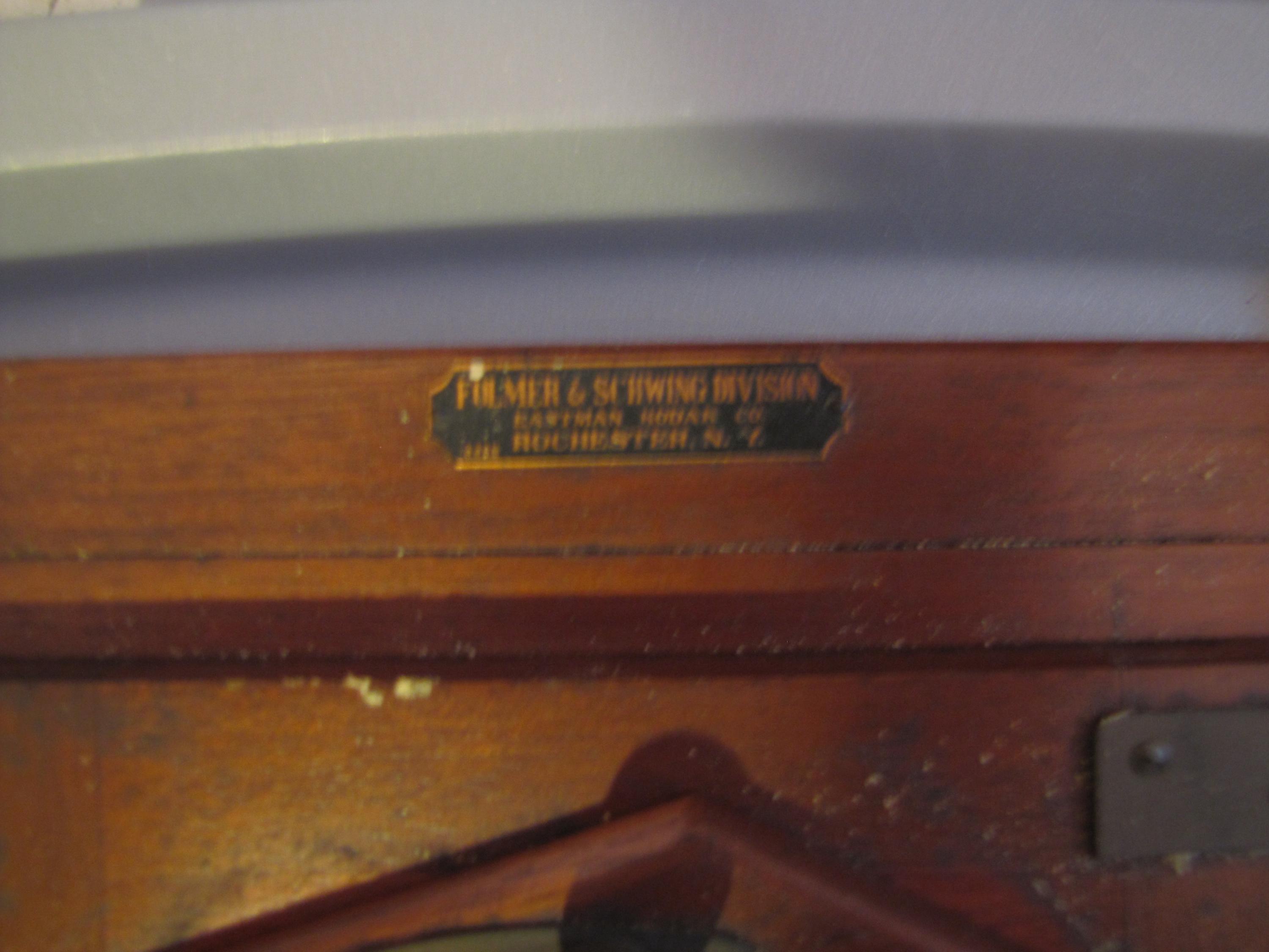

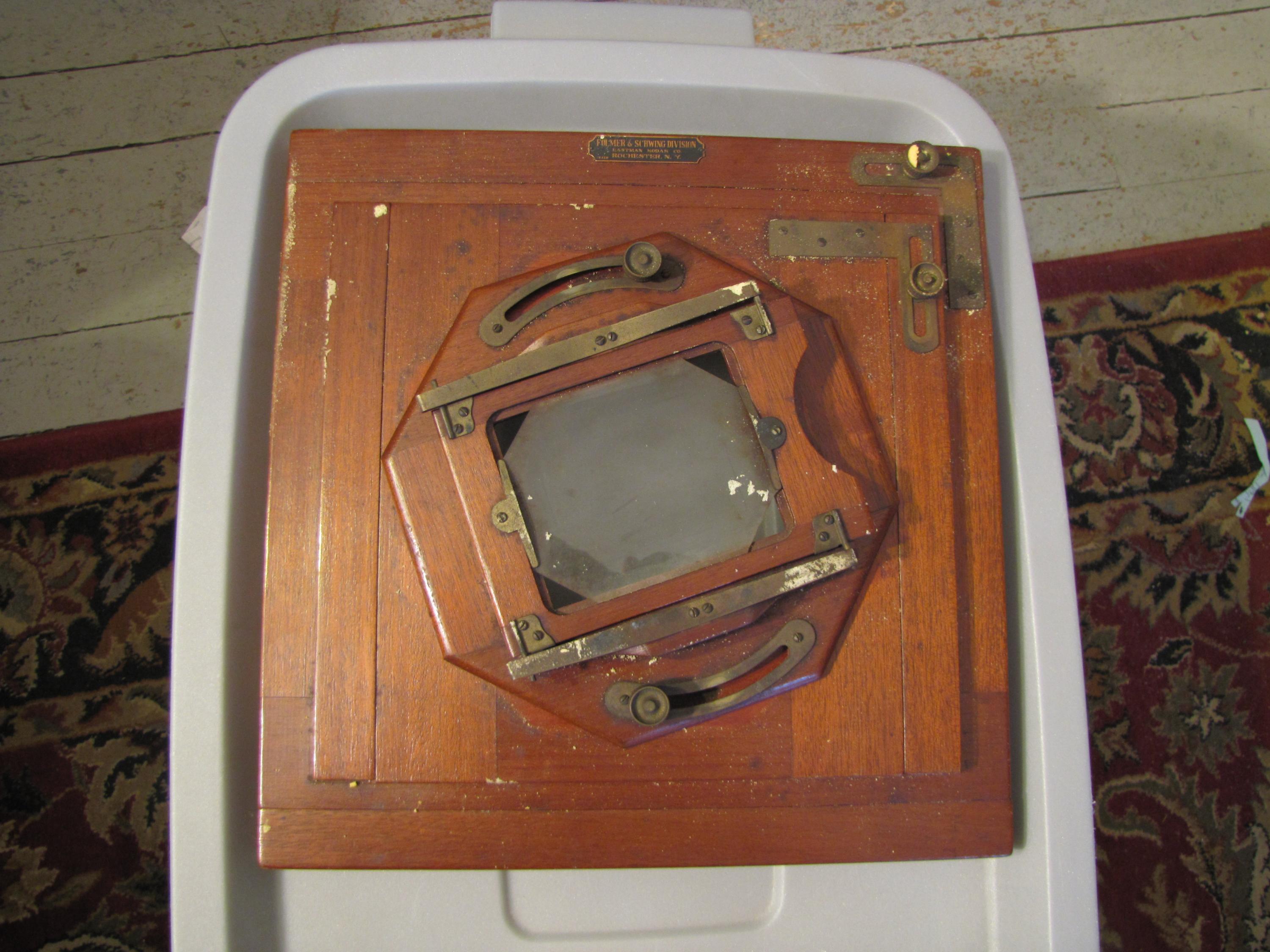

A 3 tiered wood baord -- top tier with similar glass plate and clamps.. base tier is 12.5" x 12.5" .. several knobs that loosen to allow swivel of top glass plate. Stamped with "Fulmer & Schwing Division, Eastman Kodak Co., Rochester NY"-- also a small number on stamp #14468

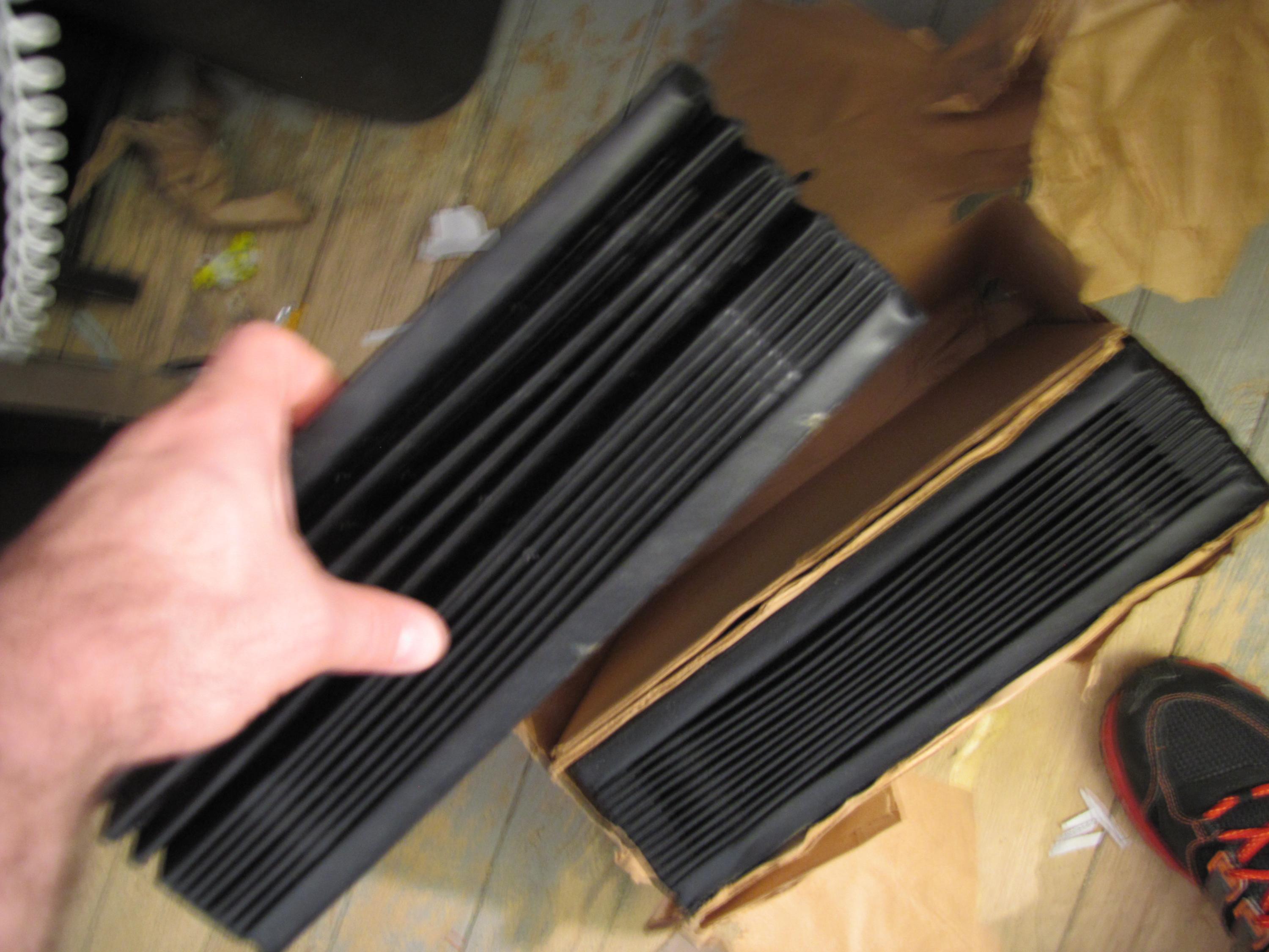

A package containing two bellows.. written on outside is "bellows for 8x10 copy stand camera"

What Brian said - it almost seems that there should be another box or two with the rest of the parts.

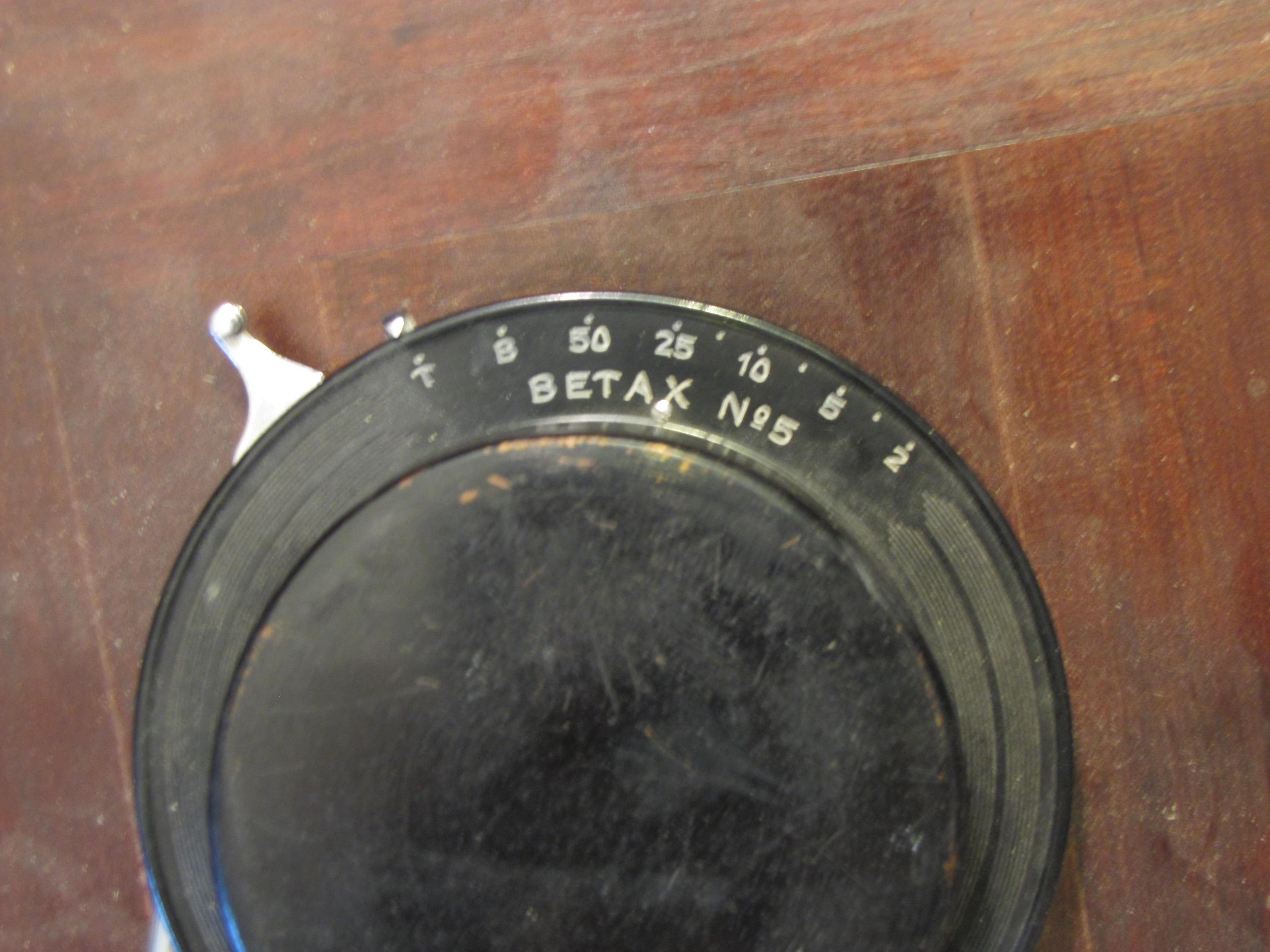

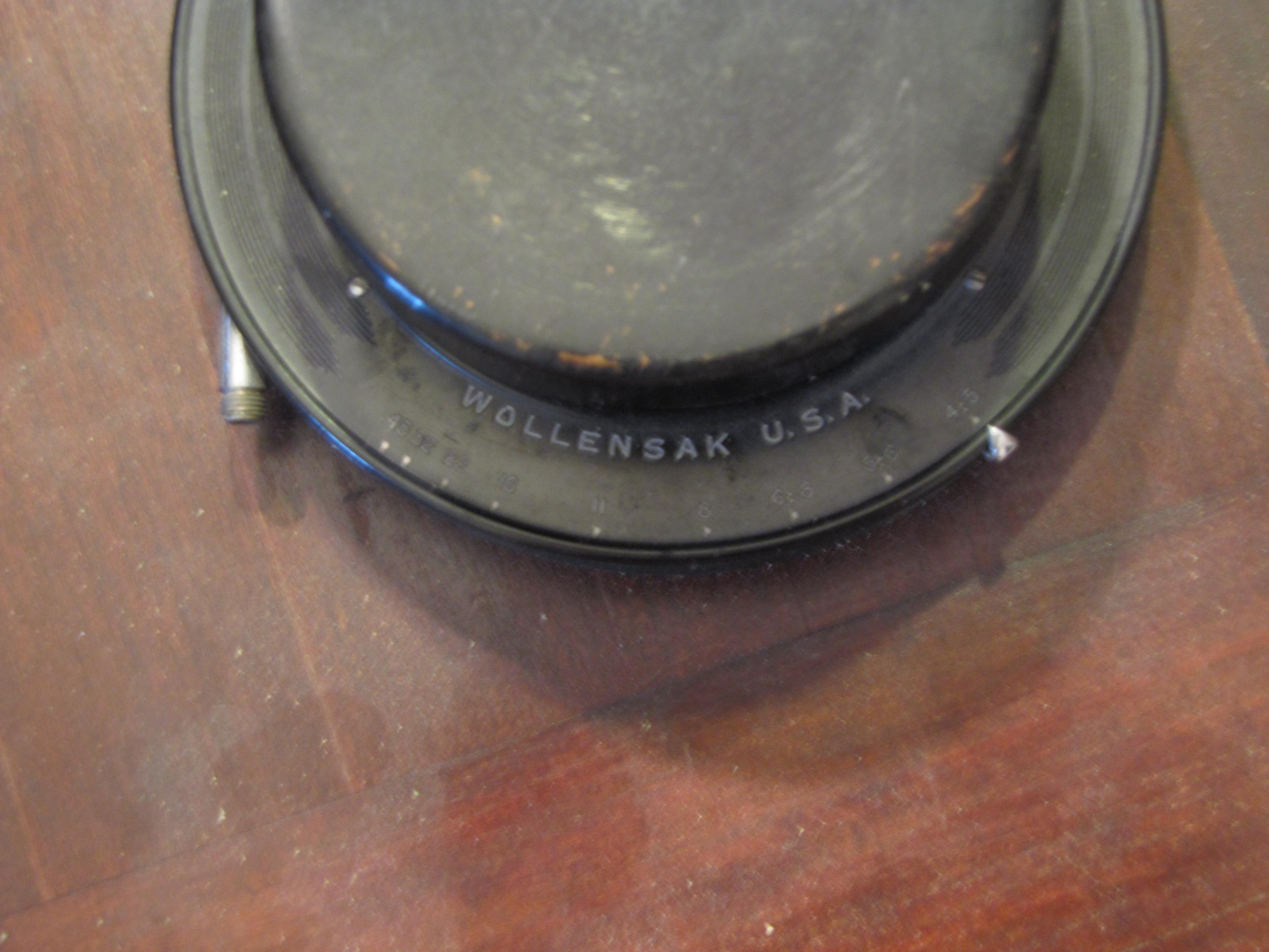

"Wollensak Betax" is a shutter, not a lens. Take off the front cap, what does it say around the bezel?

To help identify the lens, could you take a picture of it with the lens cap off? Betax #5 is just the model and size of the shutter. The 262 is probably an identifying number for the rear element of the lens to help match it to the front element, and is not even an entire serial number.
The wooden frames with glass and brass hinges are a series of backs for studio camera(s). From the dimensions of them, I'd say they were all three from different cameras, made by different makers at different times. The gray one and the multi-tiered one with the rotating panel in the center are what's known as reducing backs because they let you use a smaller size film on a larger camera. The gray one is probably from an Ansco or a Burke & James. The one that rotates you know is a Folmer & Schwing, and you can date it fairly closely because it says Folmer & Schwing, a division of Eastman Kodak. That definitely puts it in the early 20th century, (1920's I think), as Folmer & Schwing were a separate company earlier, then got bought out by Kodak, and the name was maintained for a while, then completely absorbed. Others will know the time frame for that transition better than I.

it says.. Gundlach Mfg Co, Fairport, NY 8x10, Radar Anast. F:6.3 no. RE0262
that number.. 0262 is also on the back..

Just a bunch of parts... nothing special. The glass is the ground glass where you view the image before putting the film holder underneath, that is why they are spring loaded. Nothing really jumps out here. I have a whole shelf of stuff just like this --- sort of all the extra broken bits that accumulate over the years.

Fron the pic of the rear elelmet I almost guessed that it was a Gundlach Radar. I use a 5x7 radar and if the 8x10 is as good, and it should be, that is a decent lens for general picture taking.
shutterfinger
Feb 25, 2013
5,020
San Jose, Ca.
See: http://www.nwmangum.com/Kodak/Rochester.html
1890-1907 Folmer and Schwing Manufacturing Company
1907-1926 Folmer and Schwing Division Eastman Kodak
1926-1927 Folmer and Schwing Department Eastman Kodak
1927-1945 Folmer Graflex Corporation
1945-1973 Graflex Inc,
Graflex Inc. Division General Equipment Corporation
Graflex Division Singer Company
