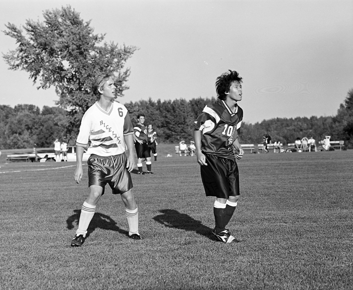

Long ago, I was testing Prescysol with various films. I ran some Delta 3200 at 1200, used the semi-stand method with the Prescysol. The film was in a 6X7 at a soccer game of my son's on a dreary day. The prints were virtually grainless with good, honest shadow detail and they made for easy printing, too. I don't tend to keep high speed films around and never got back to the experiment but this single episode left me very impressed with the combination. I just went and found a shot from that roll... The sun had peaked through at the end of the game but this shows that it had good highlight control, too. Not too great a shot but a good example of the film/developer combo.
