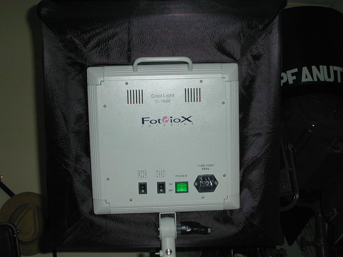

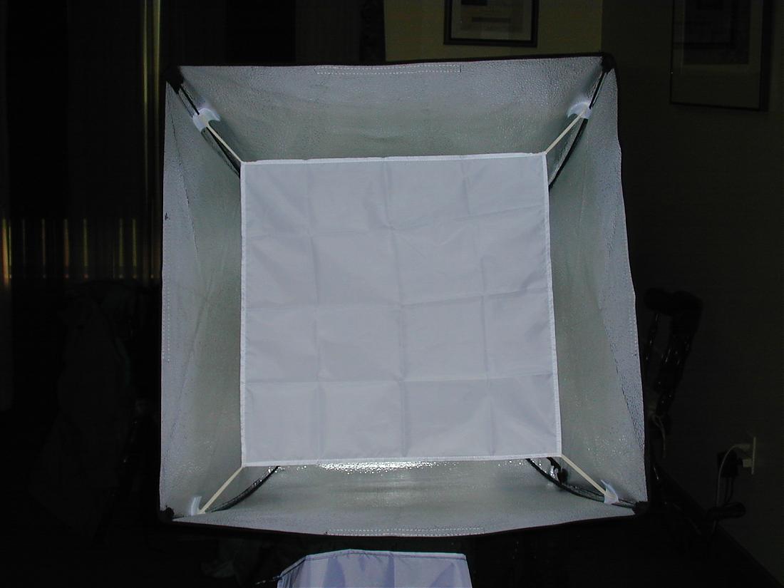

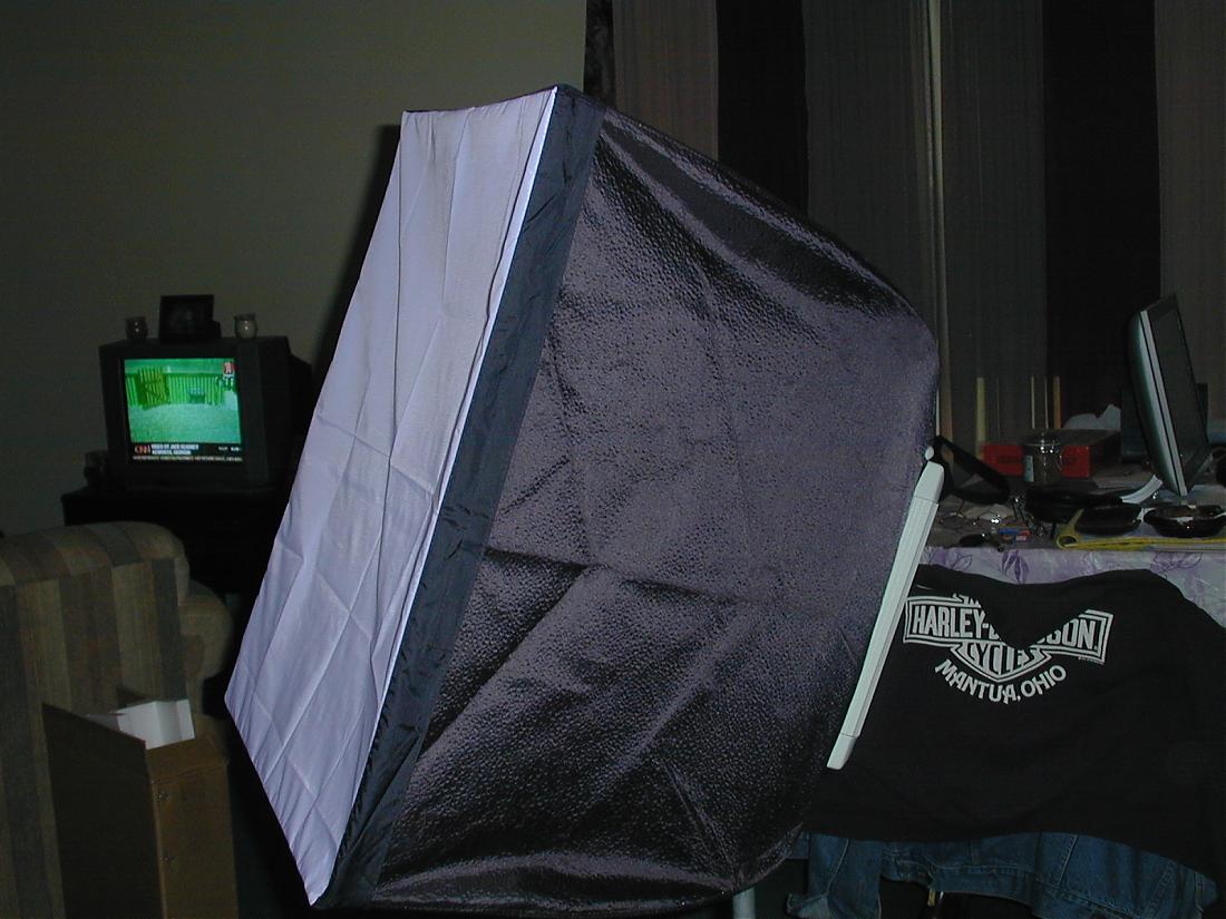

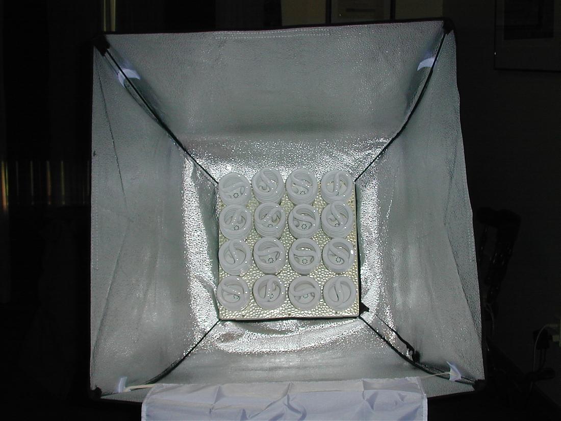

For 125.00 you can get a Fotodiox bank that holds 16 30 watt spiral bulbs. It has a switch that will allows you to switch off half if you like. It has the same intensity of a 1800 watt fresnel. Plus you can buy the soft box that has an inner and outer baffle for it. I just bought three of them for wet plate. I'll let you know how they work out as soon as I get a chance to try them. I think I paid more for the bulbs than I did the light. The light is built surprisingly strong and the housing is metal. The soft box is 24 x24"....(there was a url link here which no longer exists)(there was a url link here which no longer exists)

The UV that is required for wet plate makes the fluoro's so attractive. I compared my 1500 Mole- Richardson fresnels to the light output of the Fotodiox. And the light output is pretty close. The Moles may be a little more intense. But the fluorescents are so much cooler by leaps and bounds. So the advantage of moving them closer to the subject/model is a nice feature. I figure at this price it is not going to cost much to see the results using these banks even if I'm the guinea pig for it. I've risked a lot more for a lot less in my time.
