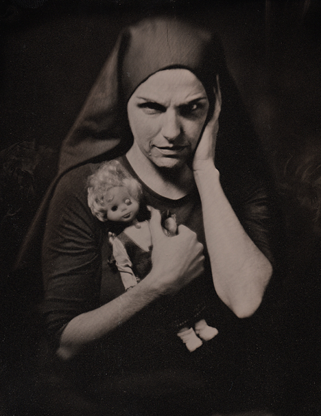

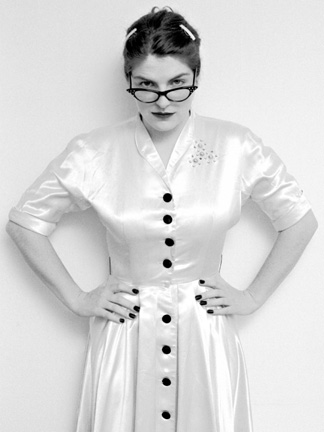

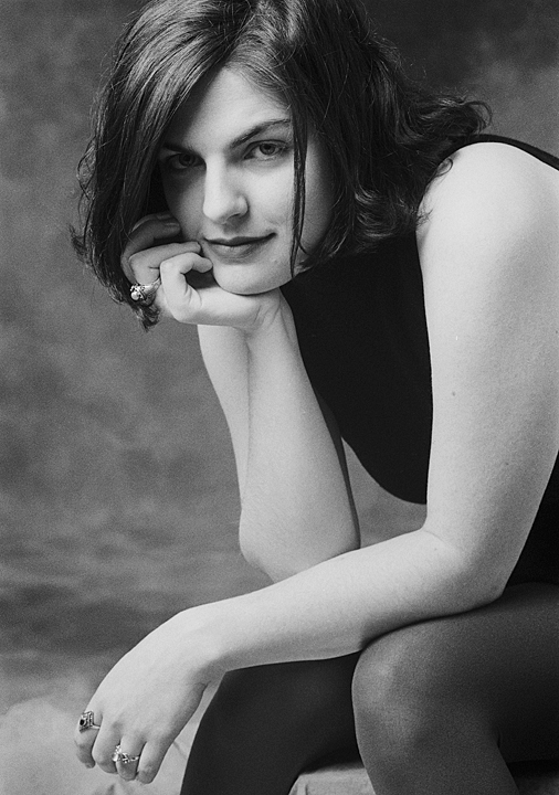

Middle, low & high key portrait examples of the same person:

Smieglitz, I like your third example. How did you light it?
I bounced a photoflood into the ceiling. There was some ambient light coming from a small window about 10' away from the subject, but the main illumination was the bounced light from the ceiling.

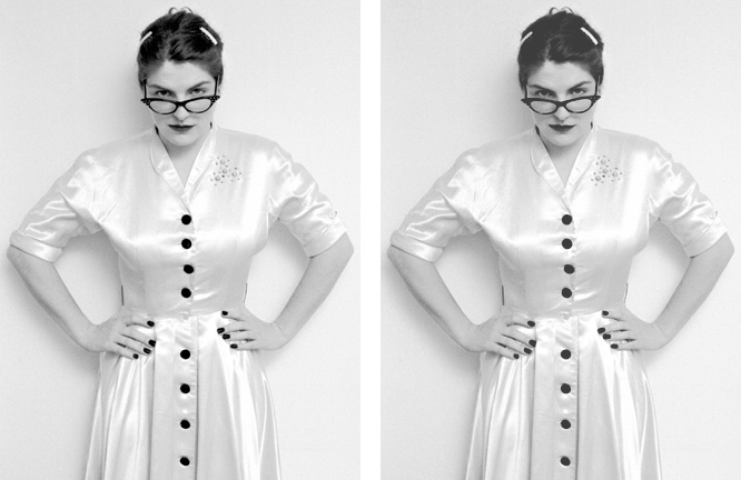

Attached is my original example of a high key image with accent blacks next to a manipulated version that would represent print underdevelopment with the same image. I much prefer the full tonal scale.
IIRC, White, Zakia and Lorenz' "The New Zone System Manual" provides some visual comparisons between subjects printed using partial as well as full print scales. Might be worth a look...
