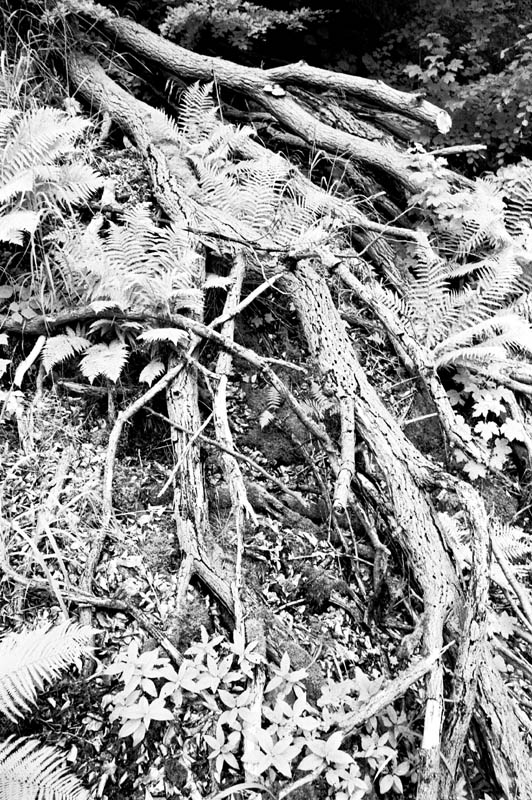

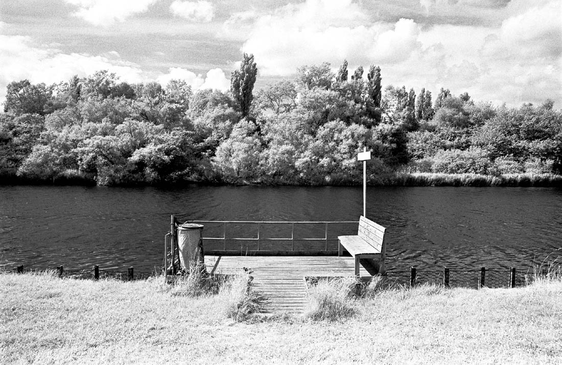

Most of the IR film of today needs a ‘black’ filter to give the wood effect e.g. 715nm-filter or R72. This make it difficult for us SLR-users to make IR-action and street photography as we did with HIE and #25-filter.
Fortunately Rollei is coming with a new film this year, as we have read on this site, in this thread (there was a url link here which no longer exists). This film looked promising for IR-photography, so I picked up some Superpan 200 (SP200) from Moersch this spring, with his excellent Finol developer. Test shots with #25 and 715nm-filters gave me hope that something in between would work so I order a 665nm-filter.
And it worked! :D
See the pictures with No filters and 665-filter.
SP200 and the 665-filter give a nice wood effect, and a viewfinder that it is possible to look through and frame the shot. Even better, SP200+665 is so sensitive to IR that it is possible to handheld the camera with a wide-angle and normal lens!
Finol and SP200 gives nice smooth grain which are great for normal pictures, but I feel it lacks some grittiness in IR-pictures, another hallmark for HIE. So I made a variant of Beutler – Beutler GD, GD for Grain Developer.
Beutler GD gives me plenty of sharp grains which are apparent on 18x23cm enlargements and approximately 1 extra stop of speed, comparing with Finol.
See the picture Beutler GD, unfortunately the scan doesn’t give credit to the picture.
I have found my substitute for HIE, maybe it will be yours too? So give this combination a chance and test it :smile:
You will find my recipe for Beutler GD under Chem Recipes.

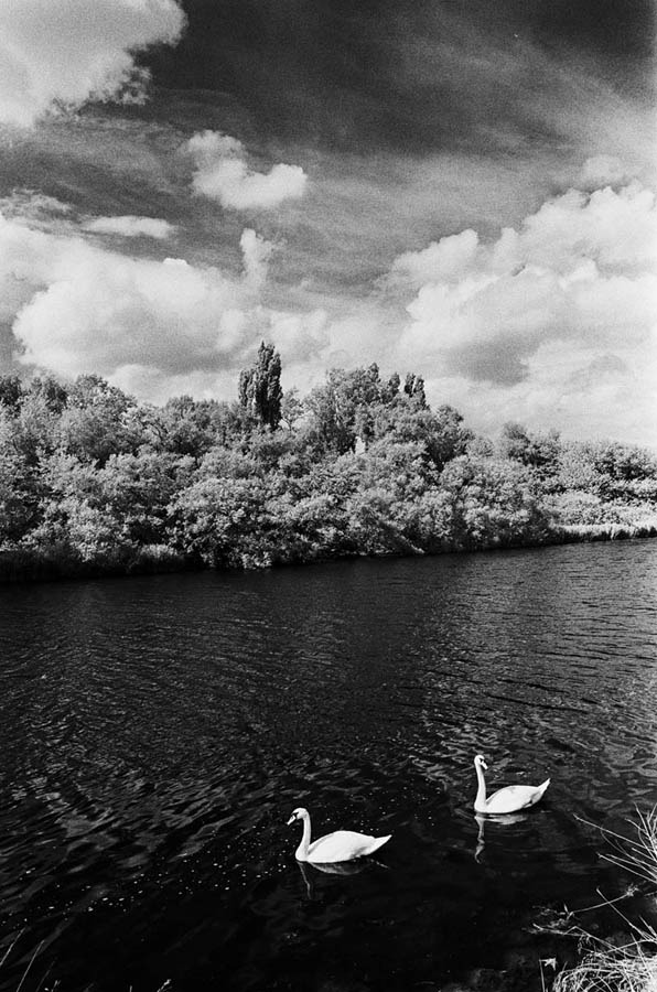

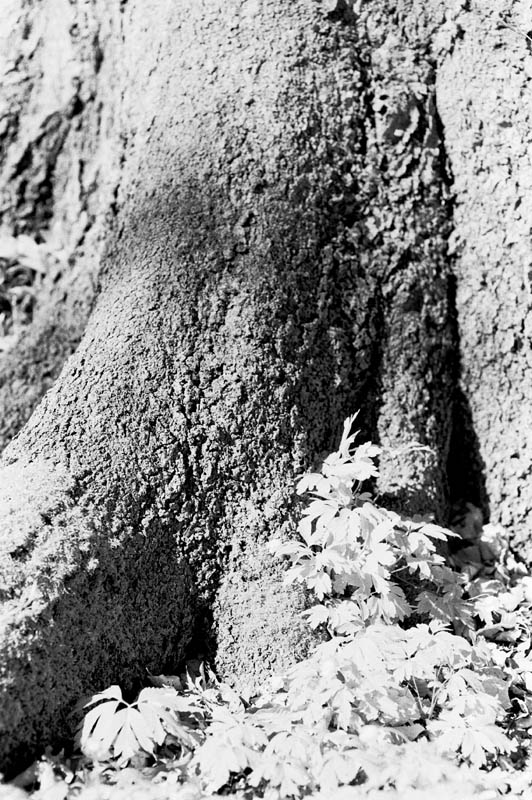

I don't see halation nor substantial Wood effect. Yes it has grit though :wink:
There was this comment about the "missing" wood effect. Here are some other neg. scans showing more of it, especially in the grass.
Is it called "Grass effect" then? :smile:
I have attempted to ajusted light and contrast in photoshop and after 10 minutes my patient with photoshop came to an end - so, here they are.
The first picture (...Moen001.jpg) was taken on a very dull and overcasted day.
Tom

Sorry to sound pedantic, and if you know this already then just ignore me, but the Wood effect is named after Robert Williams Wood, who realized that there were particular IR reflections you could see by blocking visible wavelengths. In the case of grass and many leaves, the issue is that the chlorophyll absorption (as well as that of some other botanical pigments) goes down very steeply at the high end of the red spectrum. So Wood effect is really quite particular of photorgaphy done at >700-750 nm or so.
I guess what I am saying is, please capitalize Wood because it refers to a scientist and not the substance :wink: :rolleyes: (some sarcasm here, don't worry!)
Anyway, what I am seeing in the photos is, to me, classical red-filtered pan film response, but I don't see Wood effect per se. I mean, I have seen similar results from (there was a url link here which no longer exists). No prominent Wood effect but some hints of IR-like tonality. You will see plenty of Wood effect in appropriately filtered Rollei IR, Efke IR, or SFX. And in principle any of these films could be made to halate like HIE, either by washing off the AH dye and/or placing an IR-reflective substance (Al foil!) behind the film. I haven't tried either but will when I get time.

Just looked at your last attachment, that one does look fairly "Woody" to me :wink:
I see that superpan 200 is supposed to be sensitive to 740 so that may indeed give a bit of Wood. But HIE sees out to, what, 900?
Superpan 200 is actually sensitive to 750nm and it peaks in sensitivity just beyond 700nm, you can find the data sheet for it here.
I have tested Rollei IR400 and efke IR and both are nice film and they both lack speed with an IR-filter on. I wouldn't dare to hand hold a camera loaded with one of these film and an IR-filter on, it will be a sure way to get unsharp pictures. With Superpan 200 and 665-filter I can hand hold with an reasonable shutter speed of 1/125 to 1/250 at f:8. Almost as good as HIE.
I cann't see what you are trying to compare with your link to an otherwise nice picture exposed on Rollei R3.
