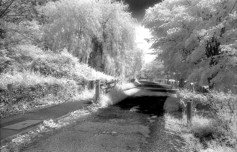

Some of the best IR results I've had came from rating HIE at 400 and bracketing every shot. See attachments.
Most important thing to remember when using IR film is to make sure you load the film into the camera using a changing bag or in total darkness.
These are some excellent examples if IR. Something I would like to do but have not tried yet.
As you bracket every shot, can you recall how close to your original exposure estimate the the actual images you used were?
