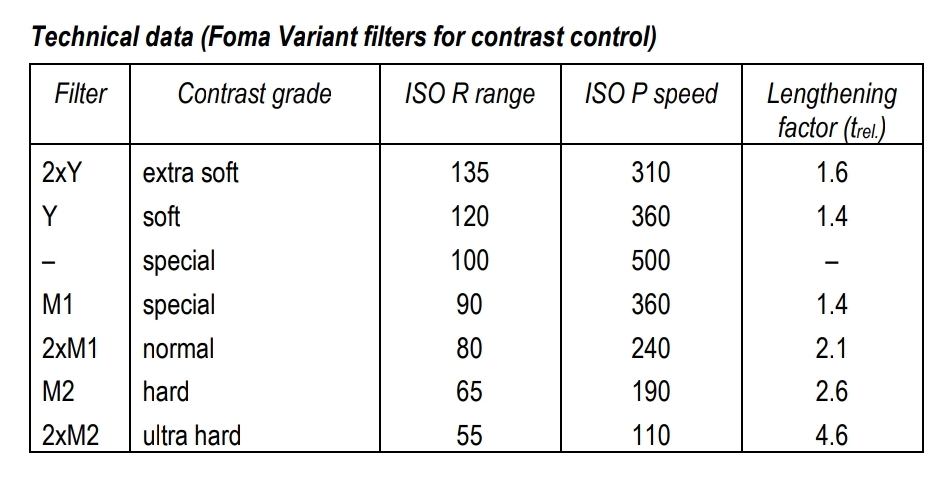

I suppose you could combine M1 and M2 and get a contrast grade between 2xM1 and M2. But it would be a relatively small change of contrast, so probably not very useful.

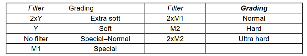

This is from Fomas datasheet.

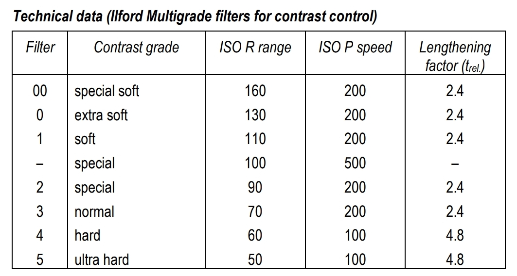

And here is the same chart for Ilfords filters.

No, they will act as a stronger magenta filter. Compare to dialing in e.g. 50CC M on a dichroic enlarger as opposed to e.g. 40CC. The numbers will vary depending on the exact density of the filters. But stacking these filters will in fact affect grade and not just exposure time. So adding M1 to M2 will get you somewhere in-between 'normal' and 'hard'. Whether that's a meaningful nuance in regular printing, is another matter of course. So I'm with @FotoD on this.

I've had several sets of Foma filters over the years. They never saw much use. Firstly, the Ilford Multigrade filters are often available in used but good condition at a reasonable price - I got multiple sets 'for free' when picking up other darkroom stuff. The Ilford filters I found more intuitive to use. It's illustrated by the table posted above by @FotoD. Secondly, all the enlargers I owned all had some way of filtering color - either they were regular dichroic enlargers, or they were equipped with a variable contrast head (in my case an Ilford 500 unit). I found there's very little advantage to using under-the-lens filters of the enlarger itself is already equipped with filters. I personally never experienced any problems with movement or shake manipulating the filters on a dichroic color head (pretty much the only argument against that approach that I'm aware of).
