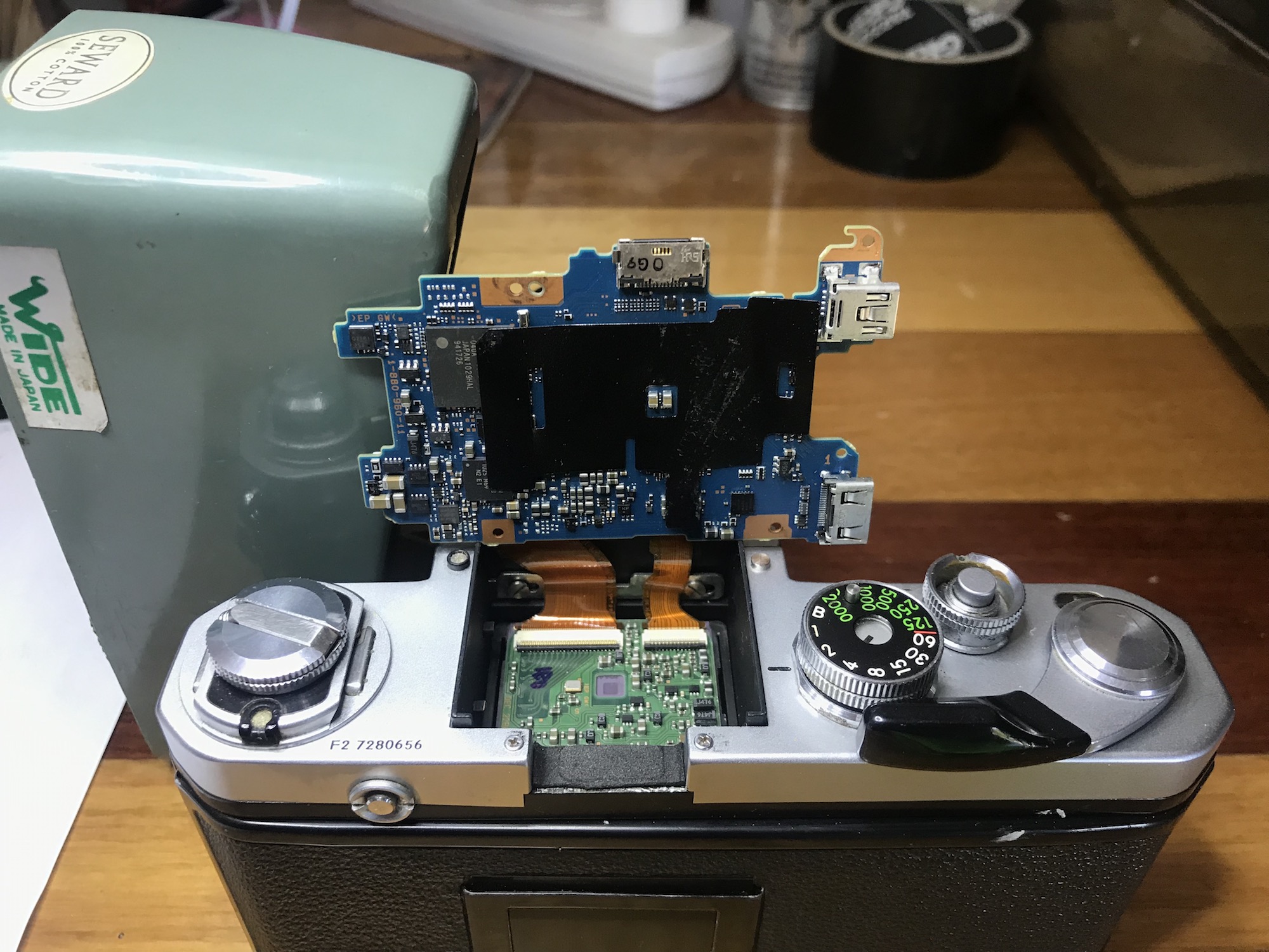

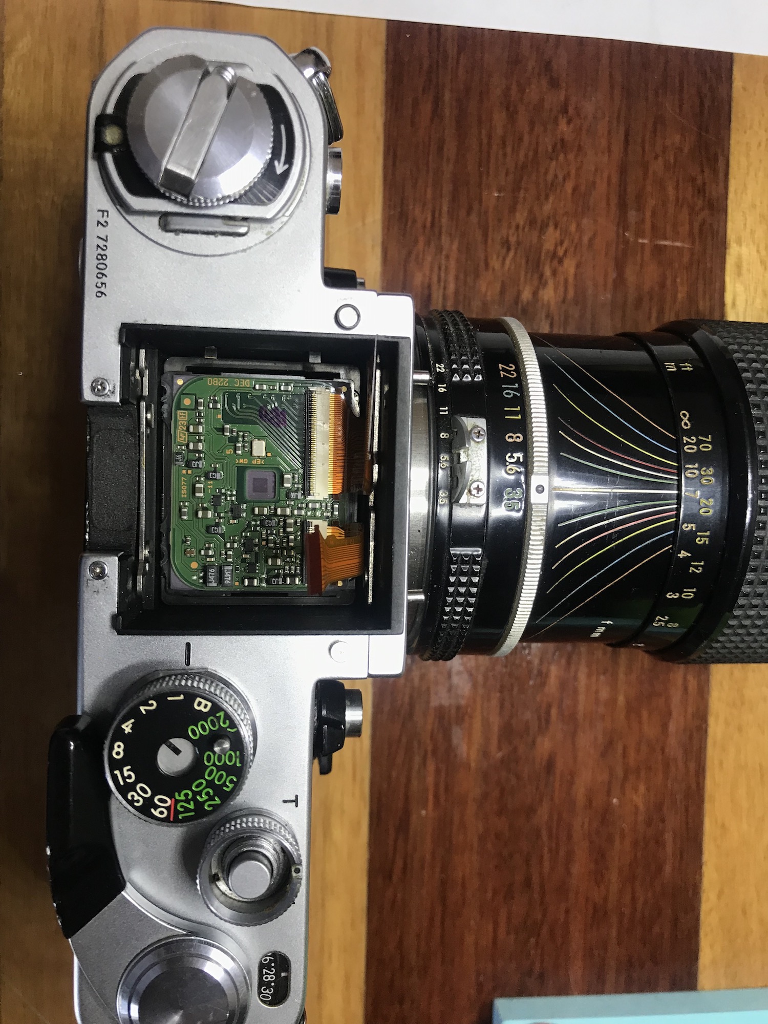

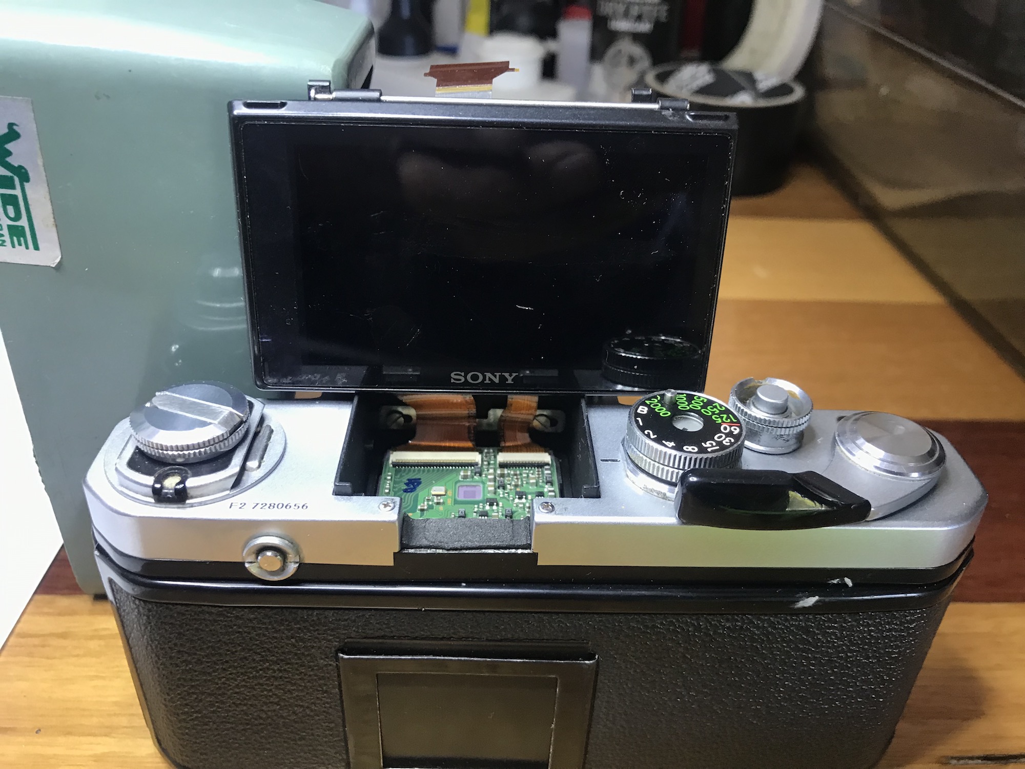

I apologise for hastily putting this in the wrong forum as it probably should be Hybrid. But pressing on let me show you how beautifully a Sony Nex APS-C sensor fits into the focus screen area of a Nikon F2. I had already rebated the edges of this sensor for another project and it looks to me that it has dropped in place right at the equivalent of the film plane distance.
Photo 1 - Shows the sensor in position.
Photo 2 - Shows how the motherboard would be located so the sensor cables would connect.
Photo 3 - Shows that the LCD screen would mount like this and connects easily to the MB.
The irrelevant, but necessary to make it work shutter and the SD card holder would mount on the other side. Other than that the control buttons and battery could be mounted elsewhere probably in say a small box located below the camera like a motor drive would. This is basic electronic wiring for a tech person but beyond my abilities. With a custom 3D printed housing this unit would mount and look quite good. So my thoughts are that it is quite feasible to have a fully functional hybrid digital / film camera that can operate both functions and probably simultaneously as well if wired up with the camera shutter button.
