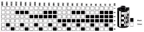

Does it read DX codes? You may be able to alter the code on the film canister to read 1200 iso.

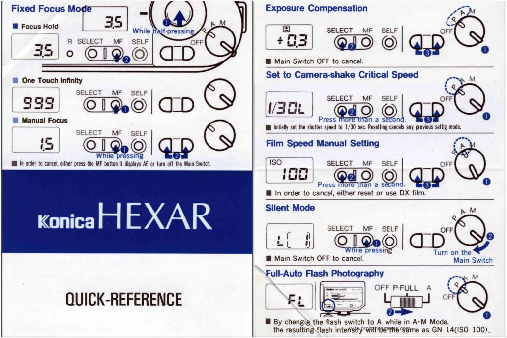

You can set any film speed you like, go into the aperture priority mode, press & hold 'Select' until the film speeds appear, then scroll through using the left/ right buttons to 1250, wait a few seconds till it sets & reverts to showing the exposure compensation, press 'select' once to exit back to normal operation. The camera remembers this for the entire roll. I use it to shoot Portra 800 at 1600 & TX at 200 + yellow filter (ie 100). Works consistently & reliably.
Lachlan, thanks.
I forgot about that routine. Konica might still be in business if they hired you to write their instructions.
There are manuals that are clearly worse than the Hexar manual.
For daily use one only needs their Quick Reference. It's in the thread linked in #2 too.
There are some 'secret hacks' on the Hexar but you won't need them.

You can also use it on DX and and tape the cassette so it would automatically set for 1250 (still no 1200).
