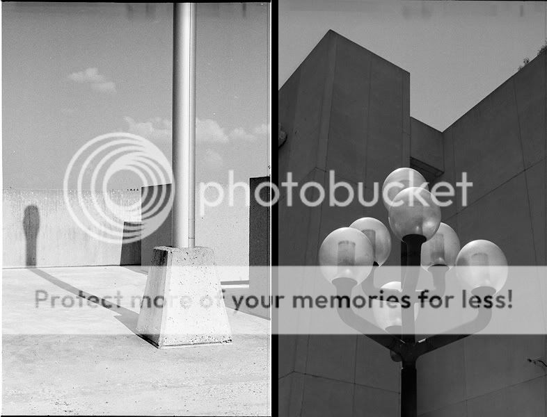

Does anyone have any ideas what would cause the problem at the top of this image?
Details:
M3 / 50mm Rigid Summicron
APX100 / Rodinal 1:50

These dark areas are from less development, in the area just next to the clear unexposed margin between frames. Doesn't make sense to me that it could be surge or agitation patterns.
Maybe could have been a dark thing in front of the camera when shooting, maybe in motion, but it doesn't look like that to me.
I can't think of anything else, unless some kind of physical disturbance to the film before developing. ??

those marks are running the wrong way for reel marks. they are across the film. I am pretty clueless what could cause that. Looks like a developer problem but I don't see how running across the top of a frame like that. I would run a test and see if it was a once only problem.

Presuming the image is shown full frame, it's not a reel problem, because it's not the edge of the frame that is in contact with the reel.

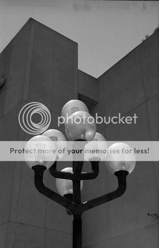

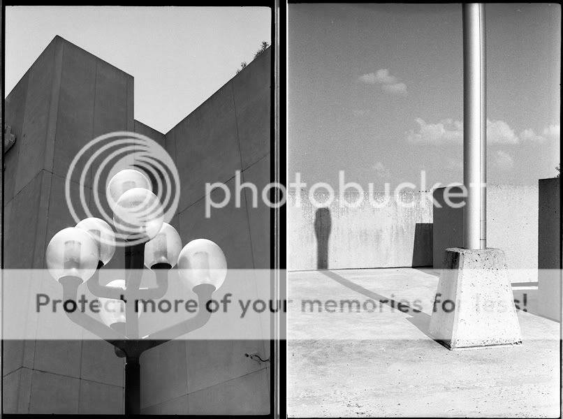

After more scanning I noticed this... it looks like the same marks on other negatives. These are frames #2 and #25 from the same roll.
These are the first rolls I've developed shot with this M3... perhaps a problem with the shutter?

After inspecting the negatives by eye I realized that I couldn't see anything that would account for the marks. The previous scans I posted here were done with a Nikon Coolsan V. I also have an Epson V700 and decided to try scanning them again and what do you know...
The marks are not there and I think the dark area at the top of the right side images is from the lousy film holder not holding the film flat. That image is at the end of a strip so I think it's curving in slightly.
