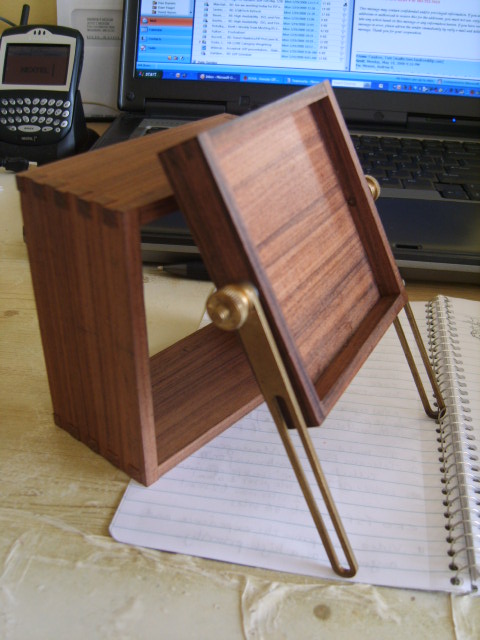

Wayne, I would advise you use the table saw for rough cutting only and use a router table for finer cuts. THe router table has so many options configurable for jigs to make joints, and for use as a shaper/jointer to true up wood prior to making fine precision cuts. In actual fact, I do not have a table saw and use a small 10" Delta bandsaw for my cutting of camera parts. I rely solely on the router for making the precision cuts. A router table is also easily made yourself from parts available at www.rockler.com or www.woodcraft.com or even cheaper if you make it from scratch.
The biggest investment for me was an INCRA fence system. That is where the precision comes in that allows repeatable finger joints to be made within really fine tolerances. Here is a work in progress on a small view camera I am making to utilize RB67 backs. The joints are pretty tight in that the friction fit is sufficient to hold them together without anything shifting. Then just a small amount of glue and I'm good to go. The bigger box is going to be two rear standards after it's cut into two, and you can see one front standard already completed. The rear has 1/4 inch box joints, and the front 1/8 inch finger joints. Easily done on the router table.
Hope this helps??
