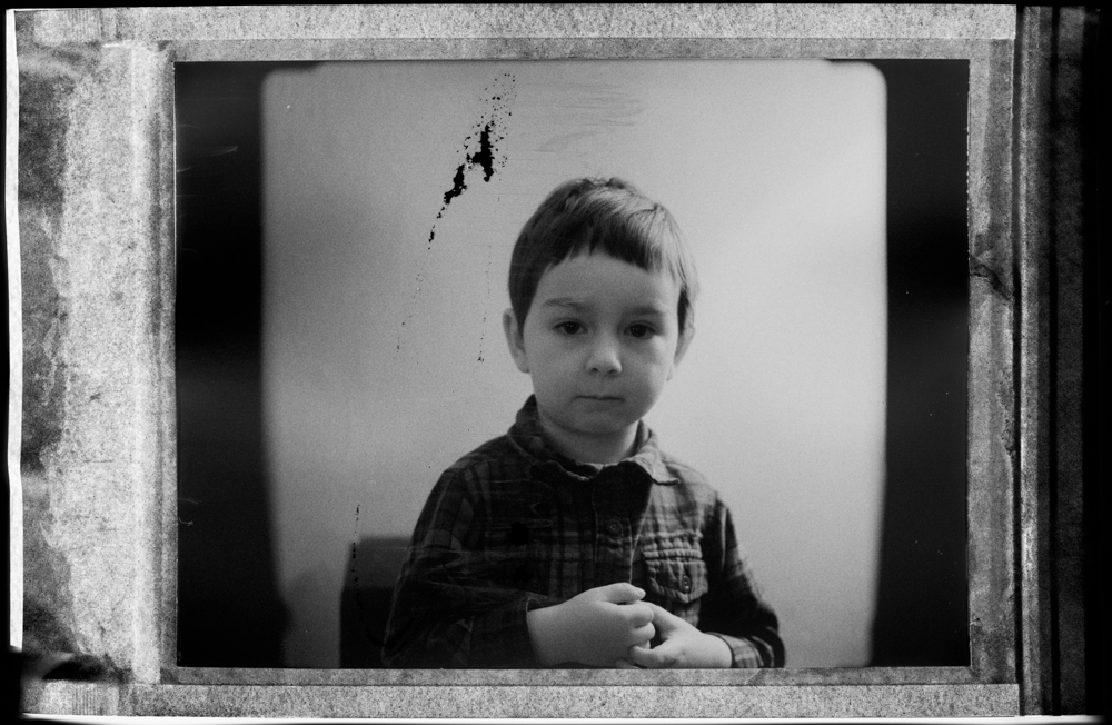

I'm not sure they have to be that grainy - that might all be down to how they get scanned and how you (or your scanner) sharpen them. for instance I feel like this negative has less coarse grain than the above example:
