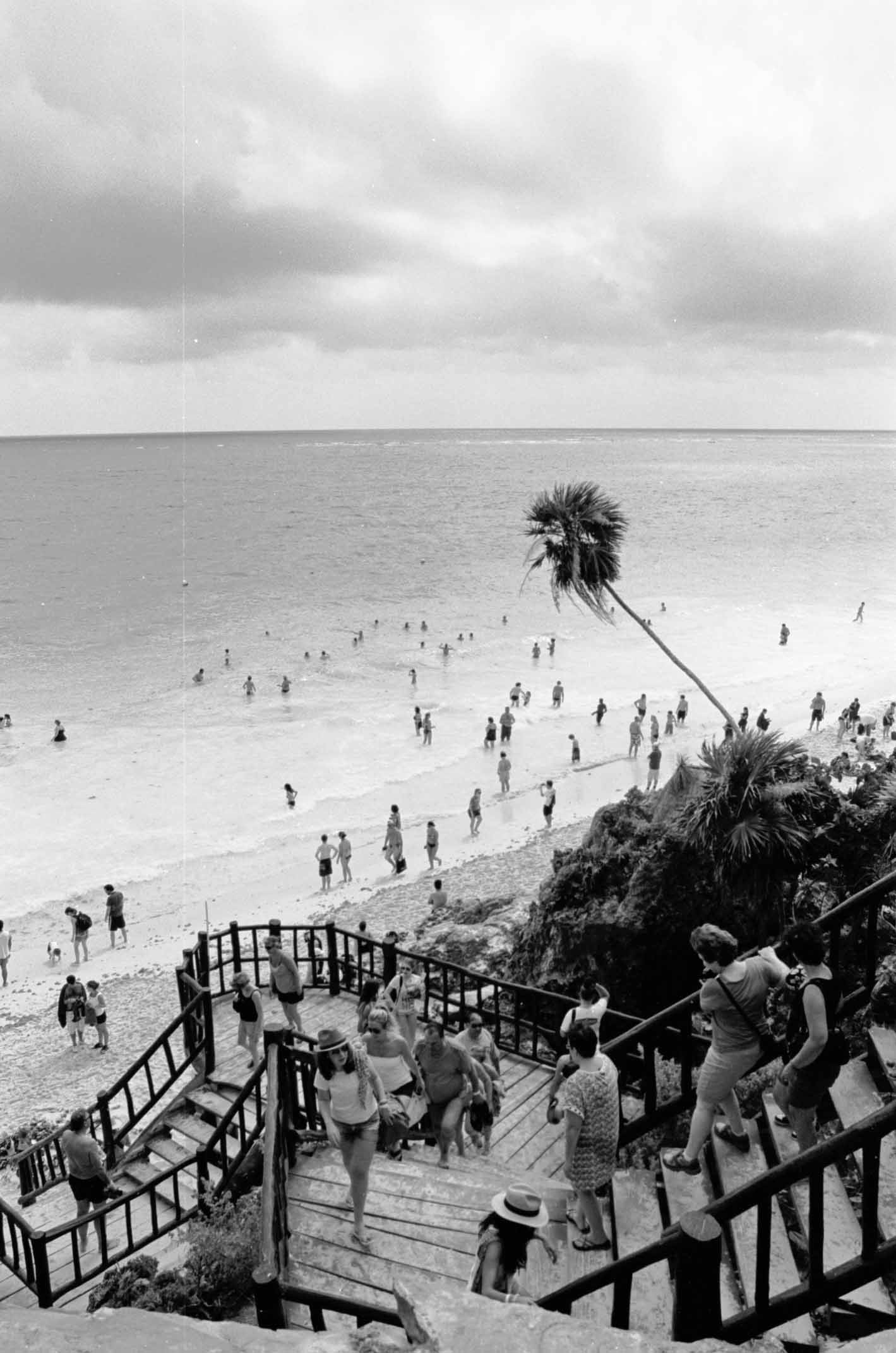

I need some ideas.
I have the attached image that I have been trying to print for about a year now. The impression I'm trying to convey is HOT and busy tourist area bustling with tourists going in and out constantly.
I've tried straight print. That wasn't it.
I've tried blue toning. That wasn't it.
I've tried tried selenium tone then polysulfide. That wasn't it.
I thought about creative manipulation. I couldn't come up with anything.
I tried hand coloring water and sky. Didn't work.
I tried solarizing it (digitally that is) and I liked it but I want an analog and more conventional print
What would you guys do?
I have something in my head but I just can't get it out.
(yes, this neg is scratched but I can fix that)

Print the sky and sea much darker.
Print the rest lighter.
I'm thinking it will be a little bit like the Sabattier effect.
What feeling or idea you're trying to convey?
You need some drama - I think Matt has it, spend some time on the clouds and sea, leaving the foam/surf lighter but the rest darker.
I will have to try that out, thank you all. I just simulated that and it looks promising. My print actually did have some of that already incorporated but I think more of that will be helpful. Further darkening sky and sea, then lightening the foreground will bring focus into the right area. Also the mood will be more inline with what I had in mind. (Yes, I scan negs and use photoshop to visualize the change. It's a useful tool)
I think this image will never give the impression being hot because it was taken in shade. You need sharp shadows if you want to convey the sensation of hot. Raising contrast would not work IMHO. Actually the contrast is IMO already too high (both burned* highlights and blocked shadows in a low subject brightness range scene).
I would print it without burning - blocking, keeping sand details under the people feet and bush - rock- palm detail on the right.
* "burned" as in "clipped" :wink:
I don't think you can convey "HOT" with an overcast sky, either. I would try cropping out the sky entirely, making it square.
Start by using some cropping Ls and crop some parts out. It's possible that there's too much going on and you need to edit the photo. The lower part seems too busy and the top part is much more scenic. Less is more.
What I would do is crop the sky out completely, making it an almost square print and then print with slightly more contrast.
I will have to try this square thing. I just simulated it and it looks good.

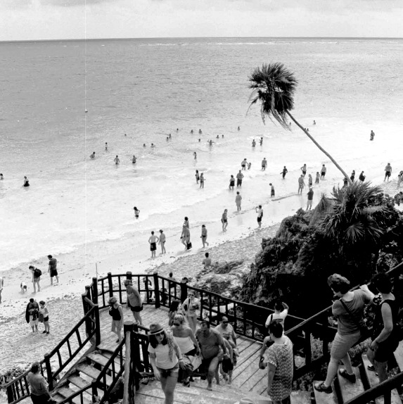

Please post it after it's done. I think square is the way to go. If you want to add some color, put some verona brown in the sand, and some sepia in the steps. It would make the people "pop" more.
That's what I was thinking.
With the clouds there you can't just portray "hot". You have to portray "hot and humid". If you want to do that, you would not want high contrast- I think more of a high key effect would work, with the clouds just held.

That's another option. But I believe there is a potential, quite a bit of it, in this image. I can almost see it, except it's still stuck in back of my head behind all the clutter. All I'm trying to do is to find out what I am seeing and not seeing, and put that on paper. I got good advise here. Darken the sky and lighten the foreground. Also leave the sky out. I'm going to experiment with this.
By the way, this image was taken in Mexico and I live in Florida. I'd love to go back there and reshoot. But I can't. Also, this is part of a series (a personal project) I am working on. Not just any beach will do.
As far as the contrast is concerned....
What you are looking at is a neg scan. Actual darkroom print with #2 filter looks just right for contrast. Once I am done, I'll scan the print and post it here.
Oh, I just wish there isn't that darn scratch on neg....
Don't mean to be mean but consider this: Ditch it. Come back to it at a later time and it will have a different look to you. This has worked ffor me on some of my troublesome shots. Often when I come I don't see what I thought I saw the first time out and I saved a lot of paper that way. Please, no offense intended.
Logan
I still think it has great potential. Burn in sky, increase contrast a touch, and lith print. You'll get the mood right, and the lith will give you the warmer colours you seek.
I'm not ready to quit on this image just yet. I know there is something in there that needs to come out.....
Interesting....
Working on this image, boosting the contrast of the foreground area much higher than what I thought would be appropriate is helping the image a great deal. Right now, I'm up to #3 1/2. Burned in the water and sky with #2.
