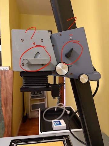

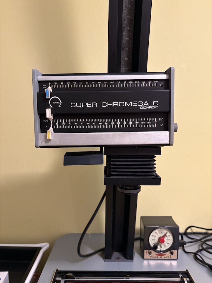

Hi folks! I'm new here but I've been making photographs for most of my life.
I was recently gifted an Omega enlarger...the Super Chromega C Dichroic and I need some help with it.
My main issue is with the focusing operation. I have a 35mm negative in the proper negative carrier but in order for the image to come into focus, or rather...anywhere near in-focus, I have to compress the bellows completely. Even with the bellows compressed all the way up, the image is still not in accurate focus. I've never owned an enlarger but have used them in school and have never experienced this issue...where the bellows need to be fully squashed to get the image in-focus. Is there anyone who has experience with this enlarger who can tell me what I'm doing wrong? Was I maybe given the wrong lens with it? Could that be the problem?
My second question: There are four levers or dials on the right side of the enlarger. Aside from the two obvious ones (one raises and lowers the lamp house and one is the focusing knob) I cannot tell what the other two levers are for. There is a grey lever on the side of the lamp house and a black dial on the bracket that holds the lamp house to the tower. (The black dial only makes about 1/8 of a turn.) I cannot tell what the function of either of these is. Does one of these have something to do with my focusing problem? What do they do? I though the black one on the bracket might lock the height of the lamp house but it doesn't seem to do anything.
Lastly, the head of the unit, or the lamp house, wobbles ever so slightly on its mount making it so that the lamp house is not perfectly level. It seems like it may be loose or not attached properly somehow. It doesn't seem like something that should have some wiggle or play in it for such a precise instrument. Is this something I can tighten myself or is this normal?
I will probably mainly be using it for black & white enlargements. Thank you for reading. I would appreciate any advice I can get. I already ordered a paper copy of the manual from KHB Photografix but I'm in Hawaii so it may take a while to get here

I don’t own a Chromega C, I have a different Omega color head.
But…
Looking at the position of the levers I think the large grey one is to change the light source from filtered to white light and the smaller black one is the column lock to prevent the head moving once you have it set.

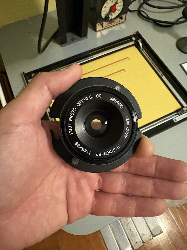

For the lens focus problem. That lens is a wide angle lens for 35mm but not sure if that is the problem. Typically a 50mm lens is used for 35mm negatives. It’s possible you need a different mount for the lens.

I think that is an Omega C67 enlarger with the Super Chromega C Dichroic head mounted, and a 38mm lens .
A 38mm lens would normally be used with a smaller film format than 135 film, and with one of the relatively few recessed lens mounts designed for it.
Here is the KHB Photografix page that applies: http://www.khbphotografix.com/omega/Enlargers/C67.htm
There is a reasonable chance that your bellows compression issue is due to the lens being installed on a lens mount designed for a longer lens - something like a 50mm focal length lens better suited for 135 film.

You are right about the grey lever and the black dial. I adjusted the color filter sliders, moved the lever and…bam…colored light went to white.
I also just found a listing for a used Chromega C where it mentions that its height lock lever is broken. That must be the case with mine too.
I believe you’re correct about the lens being my focus issue as well. I guess I need a new lens.

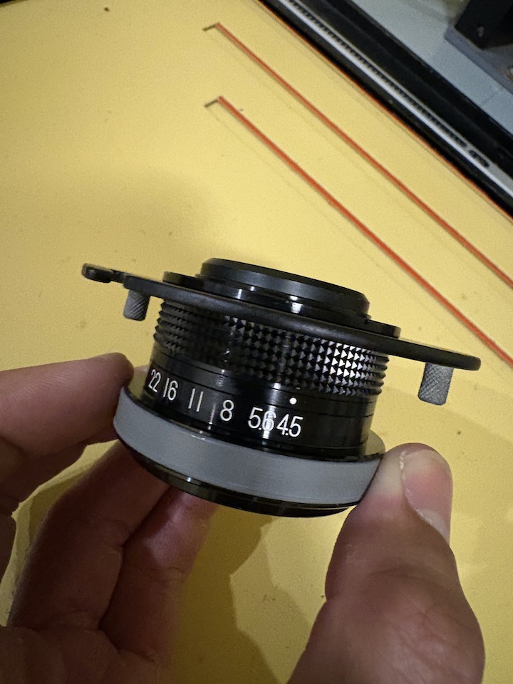

Can you show us a better image - possibly from the side - of the disk/mount on the lens you have?
It may be that it is not a recessed mount, and therefor appropriate for a 50mm or 80mm lens - assuming the correct mounting thread.
Your difficulty with the 38mm lens and bellows compression is a hint that it is not a recessed mount, because that is one of the issues that recessed mounts are designed to deal with.

I did just meet a guy here who was using a 35mm half frame camera. I was intrigued for sure. I'll hang on to this lens.
Here's a couple photos of the mount. I see now that it does have the part number engraved into it which is listed on the KHB site. I'm guessing since it is flat that it is not considered the recessed mount.

The 421-017 flat lens mount as shown in post #9 is the same as used on the B66 enlarger for 39mm Leica mount lenses.
The Fujinon EP 1:4.5 38 mm enlarging lens (39 mm Leica mounting thread) is intended to enlarge negatives up to 24 x 24 mm. To make an 8” x 10” borderless print from that size negative (or that size portion of any negative) would require a projection of about 260 x 260 mm, magnification 10.8X. The focal length is 38 mm and the flange distance of the lens is given by Fuji as 32.9 mm.
The data and dimensioned sectional drawing of this lens is given in the following Fuji catalog:
https://www.pacificrimcamera.com/rl/00886/00886.pdf
10.8X magnification would place the mounting flange of the lens (flat surface behind the mounting thread) 41.5 mm from the bottom surface of the negative to obtain focus. This would require a recessed lens mount. The KHB Photographix site lists only two recessed mounts. Both have hole sizes less than 39 mm. It’s likely that there simply isn’t enough room in the lens stage for a recessed mount for a lens with a 39 mm diameter mount thread because the hole in the lens stage is too small. If so, then this lens isn’t usable on the Omega C67.
421-006 Recessed Lens Mount - 32.5mm hole
421-007 Recessed Lens Mount - 25mm hole
You can take a measurement of your enlarger to determine what is the closest distance A from the bottom of the negative to the bottom surface of the lens-mount stage with the bellows closed—but not compressed.
The recessed lens mount must allow the lens flange placed at 41 mm or somewhat less to attain focus at 10.8X magnification.
If you want the ability to make an 11” x 14” print, the required magnification is 15X and the negative-to-flange distance is at most 40.5 mm.
For a 16” x 20” print (21.2X), you’d need the lens flange no more than 39.8 mm from the negative. In this case, the lens would have to be recessed at least A – 39.8 mm (assuming that A greater than 39.8 mm).

Ian is probably right - your 38mm lens may simply be too (physically) large to fit into the recessed mounts available for your enlarger.
You would have to find one of those mounts to see whether one could be modified by someone with machine shop capabilities to fit the lens you have - probably not. Kevin Brown would be a good person to ask.
By the way - the photos you just shared are great - far clearer than many we see from people asking for this sort of advice! :smile:
