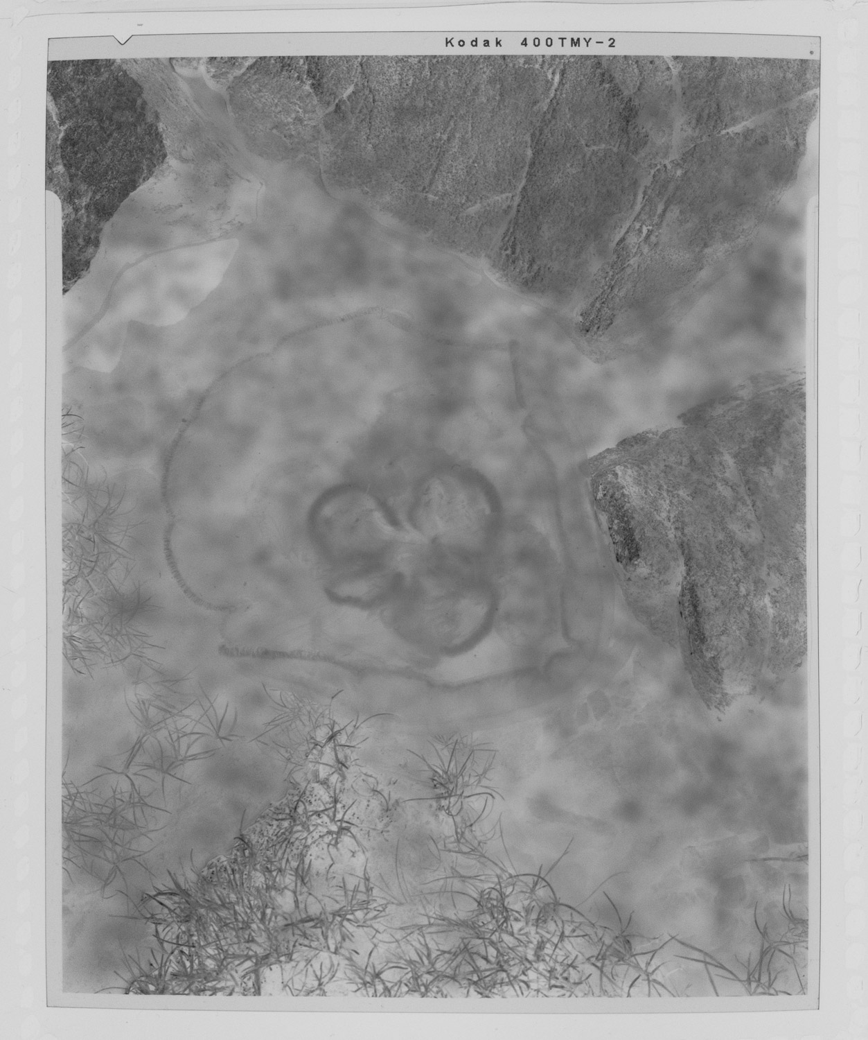

Hello all,
I was hoping to count on your experience here. I am getting some inconsistent but persistent fogging. Most films are completely unaffected, even within the same batch and taken under the same shooting conditions. I have had the problems with different films (Tmax and Acros), so I know it is not a bad batch. I think different lenses have been used, but I am not certain. I often use a 110mm Super Symmar XL, so it is possible that all these used that lens. But there are certainly other shots (most) that are unaffected. Films from the same processing run might be both affected and unaffected, so I don't think it is light from a bad tank or darkroom leak. I have had the fogging with both my studio camera and my field camera, so I know it is not from the camera (though I used the 110 on both cameras, but on different lens boards). It also seems to happen at all light levels and seems relatively balanced to the main exposure.
What do you think? It seems to me that it must be a bad holder or a lens problem. It does not look like a typical light leak though, since it covers all the film in a defocused sort of way. Any guesses?
4x5-fogging-3.jpg 4x5-fogging-5.jpg 4x5-fogging-6.jpg 4x5-fogging-1.jpg 4x5-fogging-2.jpg 4x5-fogging-4.jpg

The film looks as if it has been unevenly exposed all over. Does the mottling go out into the unexposed film rebate? If not, then I expect you may have a problem with holders/darkslides. If so, then look at your developing tank, changing bag, etc. It may also be underfixing (if the dense areas are opaque grey on the negative).
A picture of the entire negative (not reversed) would be really helpful.

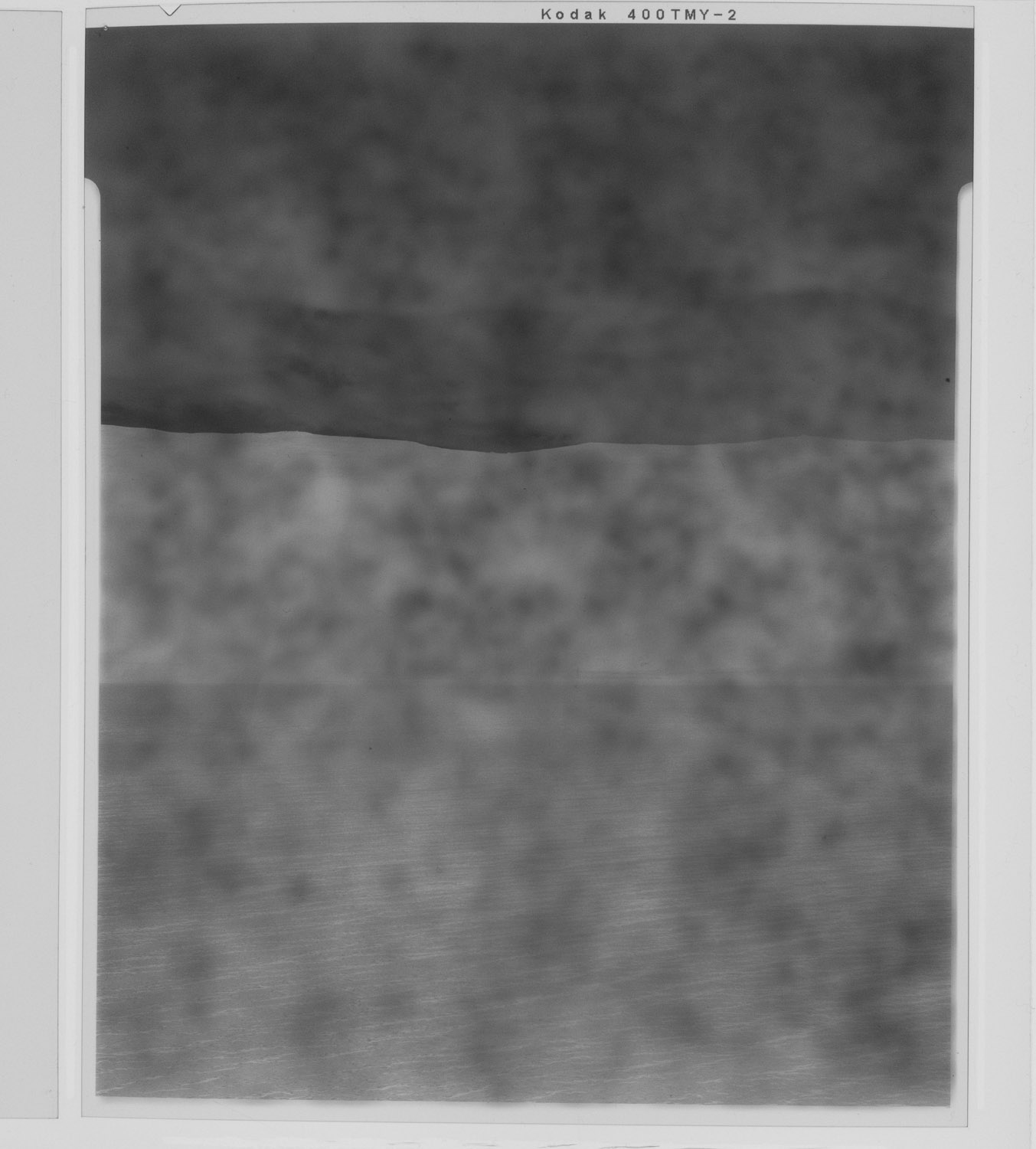

Hello Doremus,
I am sorry for the delay. The mottling tends to stick to inside the film area, but in one image it seems to extend slightly further...more like there is a slight double exposure and the film has moved, however. It could of course, be the light leak reaching further into the holder. The others mostly seem ok. I am posting two examples.
I run a lab here in Reykjavik and shoot 120 myself, and I go through lots of rolls of 120 with no issues, so I don't think the light leak is in the lab, or nor do I think it is condensation etc, as most of the sheets are completely fine, even ones that are loaded at the same time, processed in the same batch and from the same scene. One photo will be fine, and the next damaged. At this point, I am pretty convinced it is a holder, or improper loading (perhaps the film is not seated correctly, though I try to check!). The rest of it seems to rule itself out.

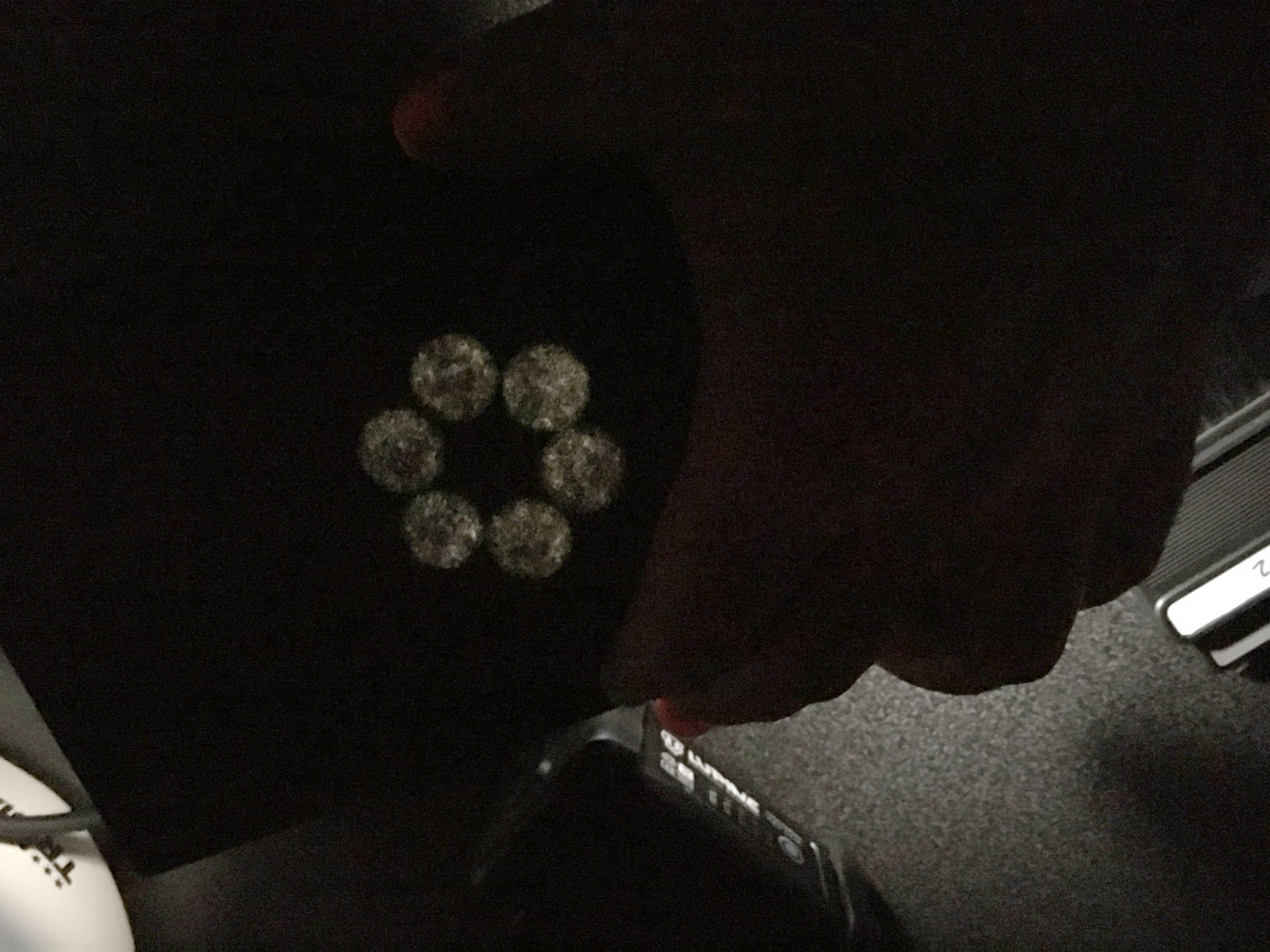

Yes, I confirmed that this is what it was...I have a strong flashlight and it shone right through the dark slides! Only on the new ones though, not the older holders. MAC is replacing them right away.
