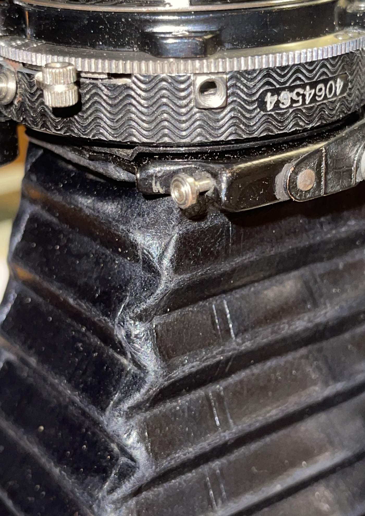

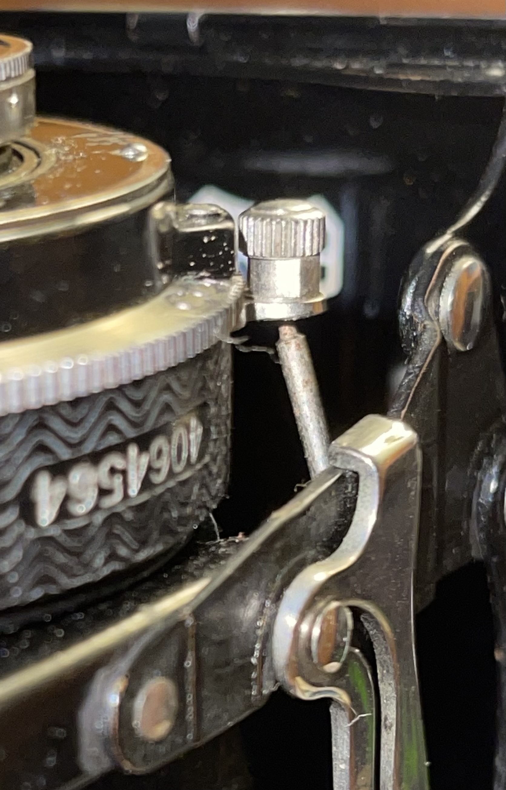

Thank you both for the input! So it turns out it did fire in Bulb not T, but the button stayed pressed. I can turn the speed selection only towards T which half closes the shutter, but again the button stays pressed. Moving the Cocking lever closes the shutter momentarily but it doesn’t stay cocked.
The shutter release button on this model is only located below the lens and not on the body. I feel like the rod connecting from the release to the button maybe has come unaligned but I don’t have another similar model to compare. What do you think?

I've not seen that style of release on these cameras myself. Looks like a basic lever, with a pivot underneath the shutter block connector. I would simply study the motion. Look for bends in the straight parts. Add some oil to the pivot point. Clean and oil sliding points. Avoid any bending until you are certain that you can't exercise/lube the drag away.
