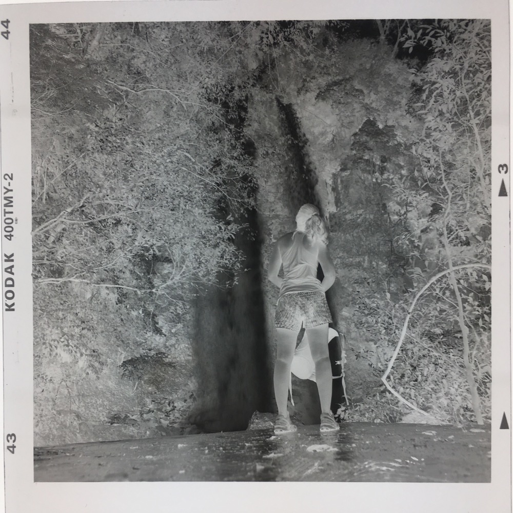

Replying to an old thread, but I did the exact same thing: shot 400TMY at EI 100.
Reduced development time by 15% and the density got really good, IMO.
Since it's summer down here and my darkroom ambient temperature is close to 27 degrees (Celsius), I used an ice bath to get the developer down to 19 degrees. It gets up to 20 degrees when poured in the tank.
Fixed for 10 minutes in Kodak F5.
Cheers,
Flavio
Edit: here's one of the negatives, captured with the phone camera on a light box.
