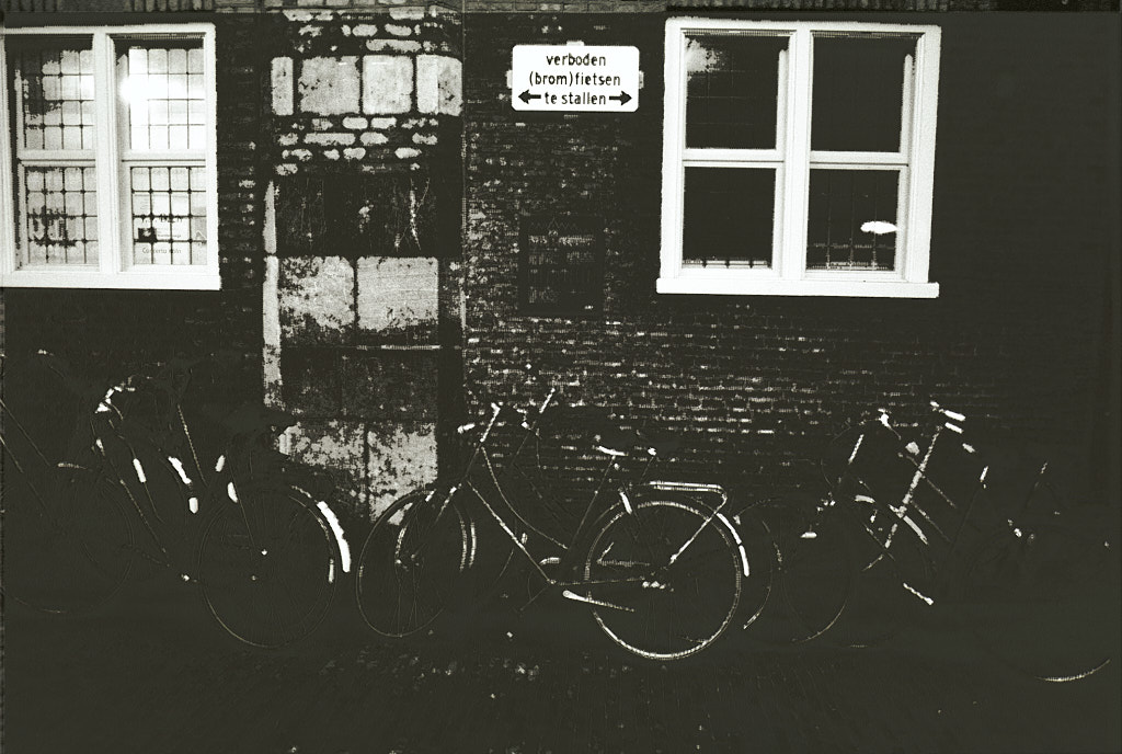

Any chance your project would work in black and white? I have shot only 2 rolls, but so far I've been impressed with Ilford Delta 3200 exposed at EI 1600.
This photo was exposed at f11 for 1/4 second (I used a tripod). So, f8 at 1/8 > f5.6 at 1/15 > f4 at 1/30 > f2.8 at 1/60? Personally, I don't consider any of those to be hand-holdable except 1/60.
