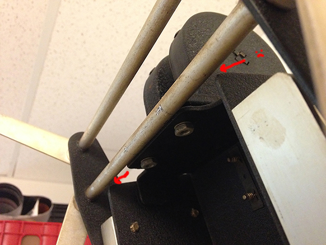

I need help with an Omega D3 (old autofocus one) that I bought on craigslist for the photography club at my school. I'm not sure if I did something wrong, if it was the transport or if it was sold to me with a fault. Anyway, the head is stuck at the top, the lifting and holding bars of the condenser can't pass the top of the column. I don't see any obvious adjustment screw that I could use to wiggle the head down. Does somebody know the enlarger and has a solution to offer?

They're experts at stuck heads indeed!! :D On my side, I just need that one to get over that bump. Less dramatic
The picture is from the front, I removed the condenser head, so you just see the support bars that are blocked by the top of the frame. If that makes sense

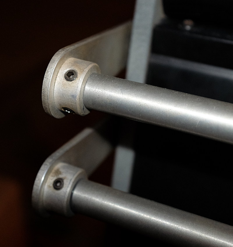

If the lifting arms are anything like on the D-4 (well, the D-4 arms that fit to the dichroic head) and you have a hex key of the right size (Omega specified a "#10 allen key", and I found that a Torx T-10 bit fit perfectly), you can loosen the two set screws on an end of each arm and pull out the shafts. If I have the right idea of your problem, that should allow you to lower the carriage and then you can put the lifting arms back. I've attached a picture of the set screws in question. My arms have two each. Loosen them and you should be able to pull the arm off the shaft, which you can then slide out of the carriage.
Note that doing this will upset the alignment of the lifting arms on each side, but it's very easy to realign (and not nearly as critical as e.g. the lens alignment).
