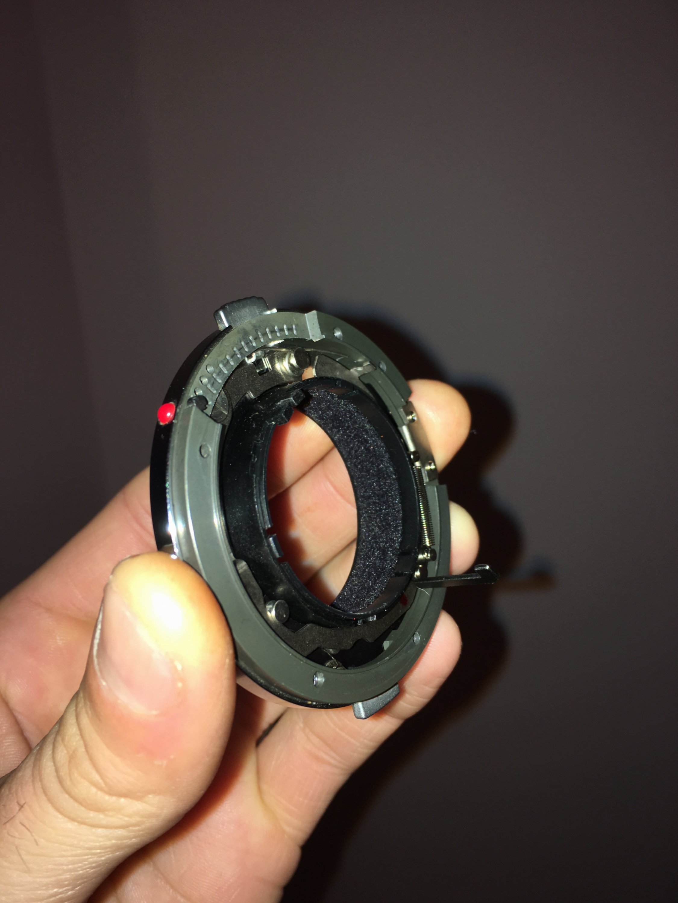

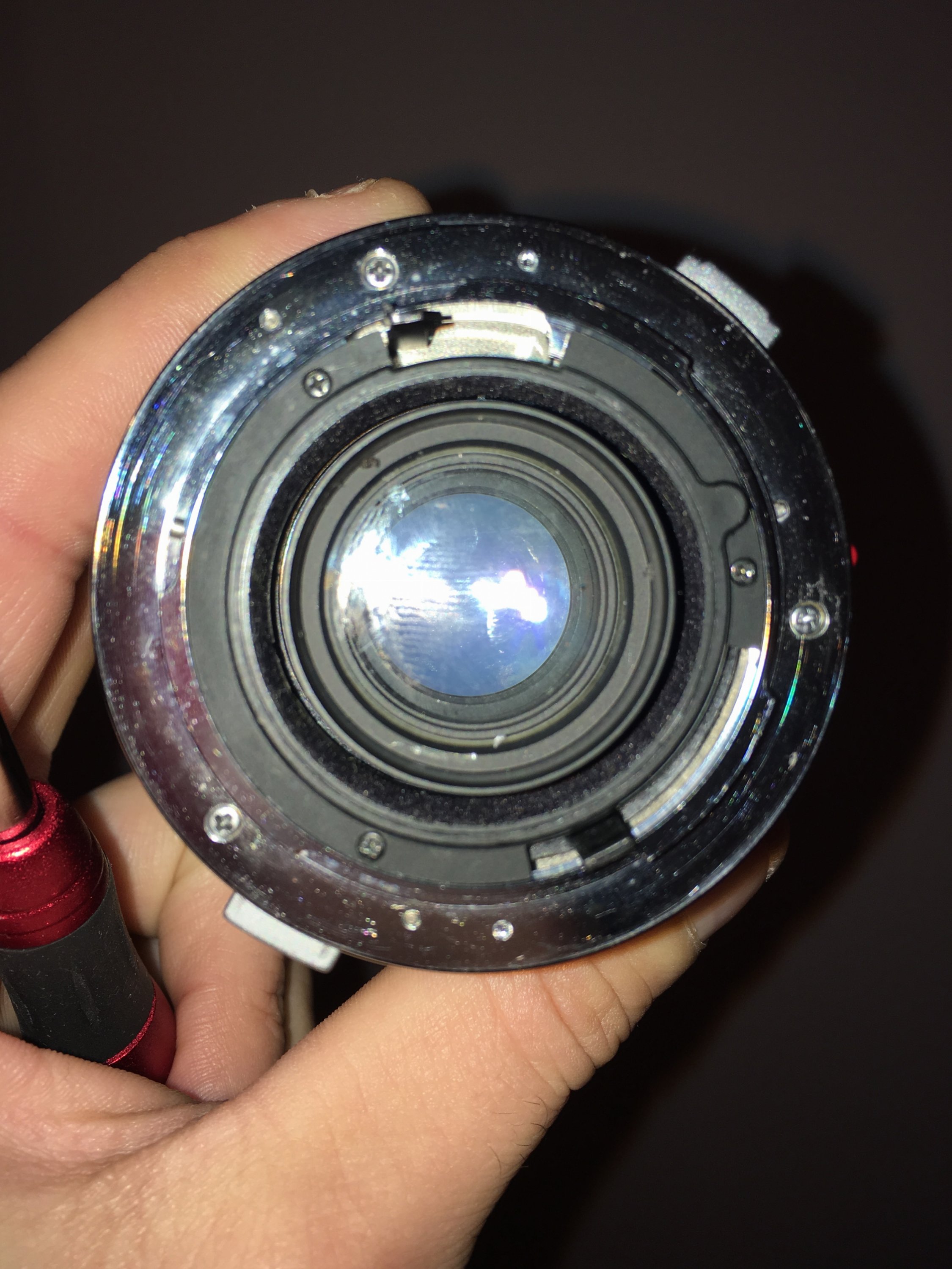

These are the pictures I could get!

Your second photo shows a tab with a long-head screw on the right. This likely should mate with a slotted tab inside. If they don't align, then this tab with push the side of the inside tab, and the aperture will be far wrong. This is one possible problem I see from the photos. Good luck, Mark.

FWIW, it's an Olympus mount. The two silver tabs are for lens release and DOF.
The release will only work one lever in the mount. The DOF is likely to be the longer one.
Soooo, if you reach to the stop down linkage with a probe does it open & close properly?
If it does, you may be putting the long lever on the wrong side of the internal stop down lever.

The long black lever has been going into the slot where the long pole goes towards the aperture blades, my big problem is which ever way I set up the levers nothing happens when I set the aperture to 4 and 5.6 but it all worked fine before I took it a part, well apart from there being oil I the blade and they took ages to shut!
