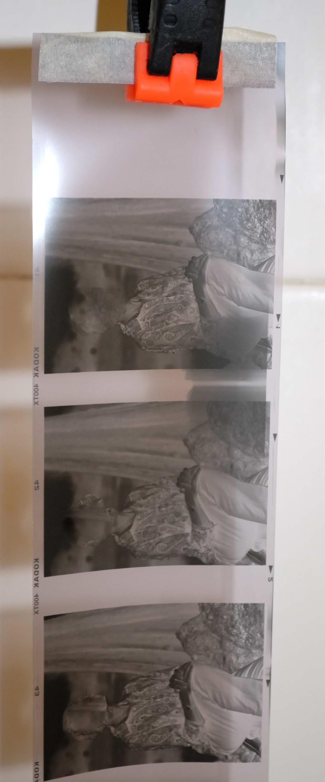

This is frustrating.
I just tested new-to-me Mamiya RB-SD 645 back in the field. As you can see, there is a light leak on bottom of the frame. An odd thing is, this is the only place it appears - overlapping frame 1 and 2 and in between. It happened no where else.
This is a back that came from a well-known source and was in great condition. I don't think it was ever used....
Film was Tri-X.
On the image, you are looking at the film from back side as you can tell from the frame counter number. It is at the bottom of the negative.
Does anyone recognize this pattern? I don't see any damage of any kind on this back. It really looks brand new.

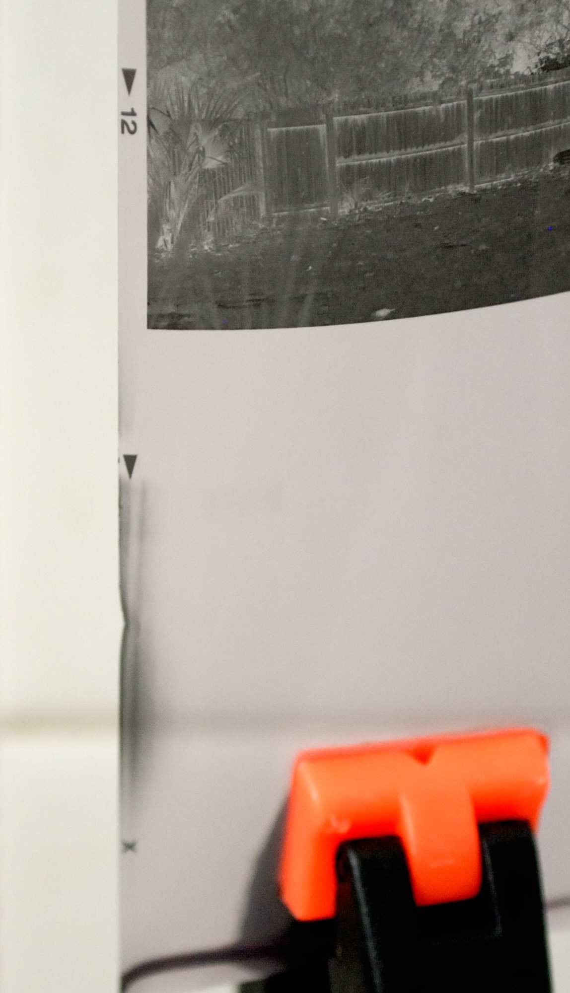

Here'a another view of the same area.

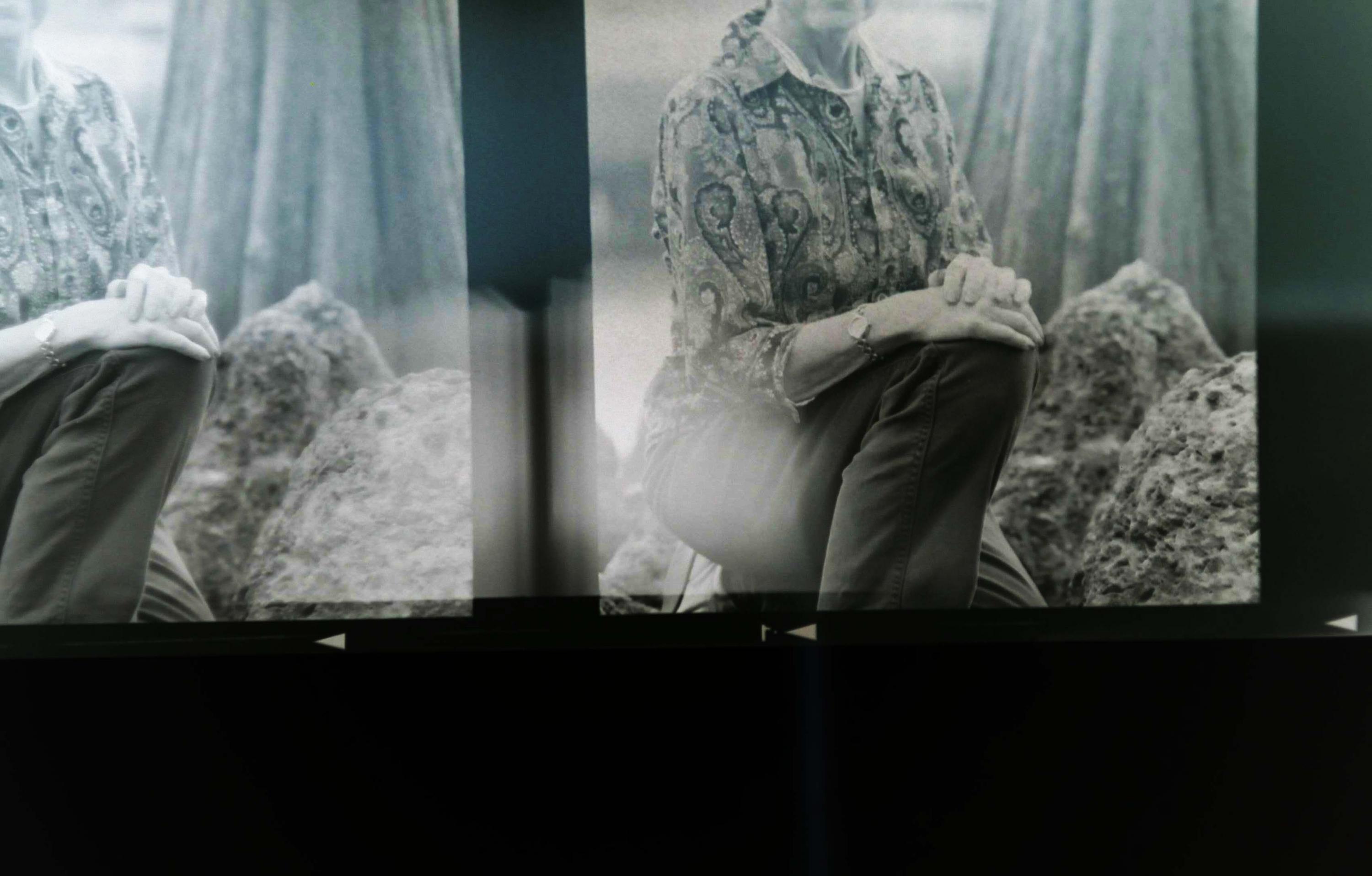

I don't know if this will help. I just highly processed the image and reversed it. I can clearly see the profile of the leak.
So far, I have not seen anything that matches this profile. Oddly enough, the leak stops before the bottom end of the image.

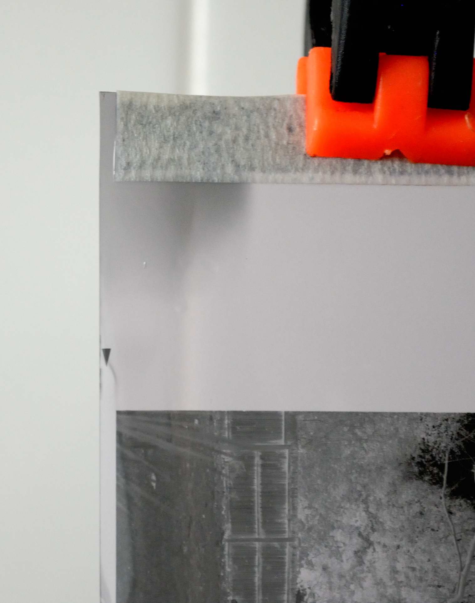

I found something.
There is a stainless steel roller where the film goes in. It is supposed to keep the film from unspooling. The top edge of the mysterious exposure matches with this piece. I had to load the film under shade but nevertheless outside. I wonder if the film got unspooled and buckled just so that this exposure took place when I loaded the film, and just happened to land where it did??
I just rolled the film back into the frame again and when the arrow is matched, frame 1 is just 4 layers behind the backing paper. With some light piping happening before frame 1, that may be the cause...

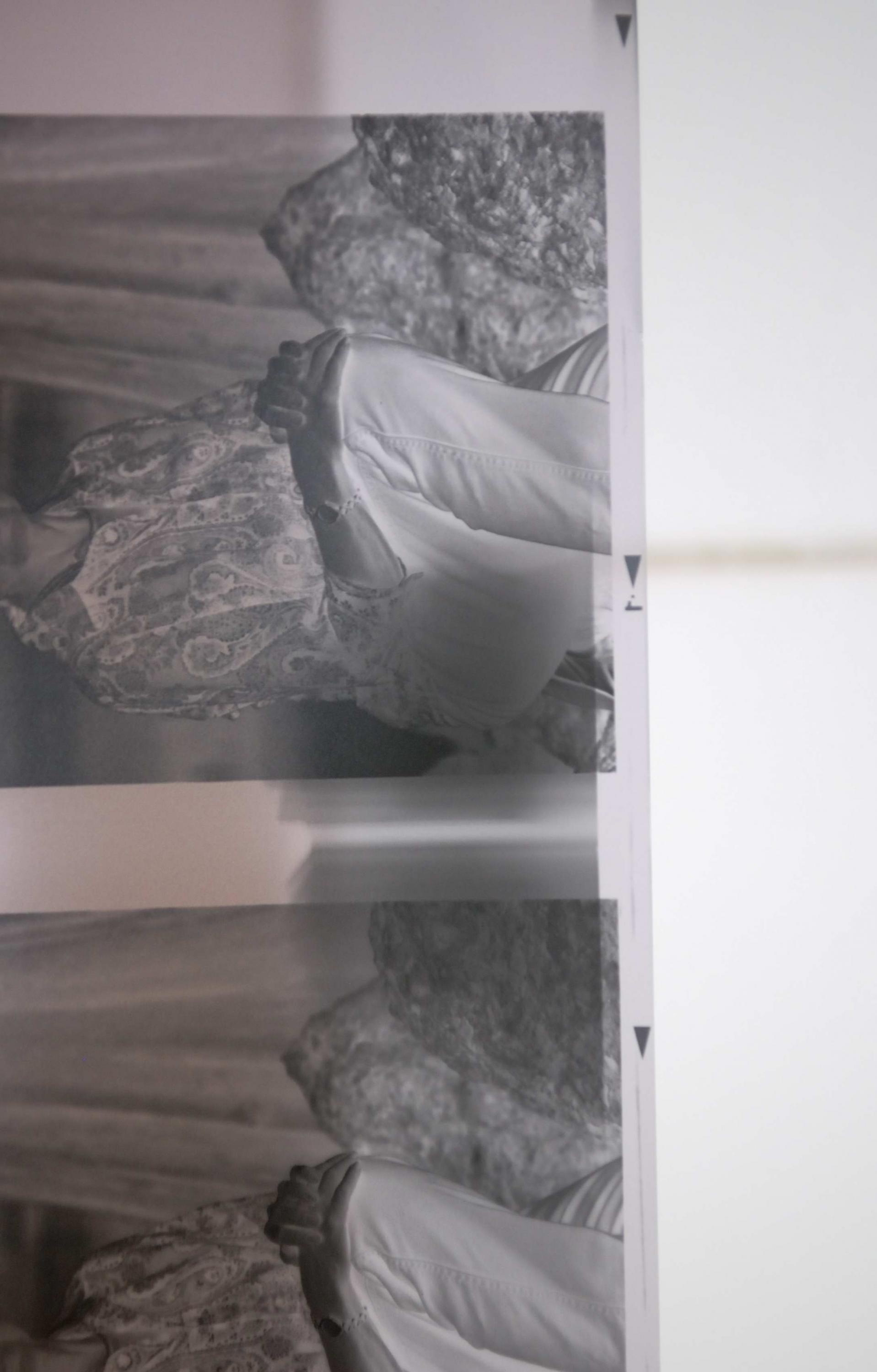

I did another test today.
Loaded the film in dim indoors, advanced the frames to 1, and removed the dark slide. When outside and shot all the frames. During the test, I rotated the back, inserted and removed the slide a few times to simulate typical usage. Condition outside was about two stops brighter than yesterday. I came inside and slid the dark slide in, removed the back, then removed the film.
There WAS a similar light leak but it was well ahead of the frame 1. There was some light piping from the edge but very minor. There was a little more light piping at the end which I assume it happened after the film was taken out of the camera.
So basically, it's good.
Questions to the larger audience....
1) Is this kind of result typical? I am not particularly new to MF. I had M645 Super and Pro before. I don't recall area ahead of frame 1 getting any exposure like this.
2) Above test was basically an ideal condition where I can load and unload film in dim indoor. That won't always happen in the field. Again, I don't recall this kind of problem with M645.
